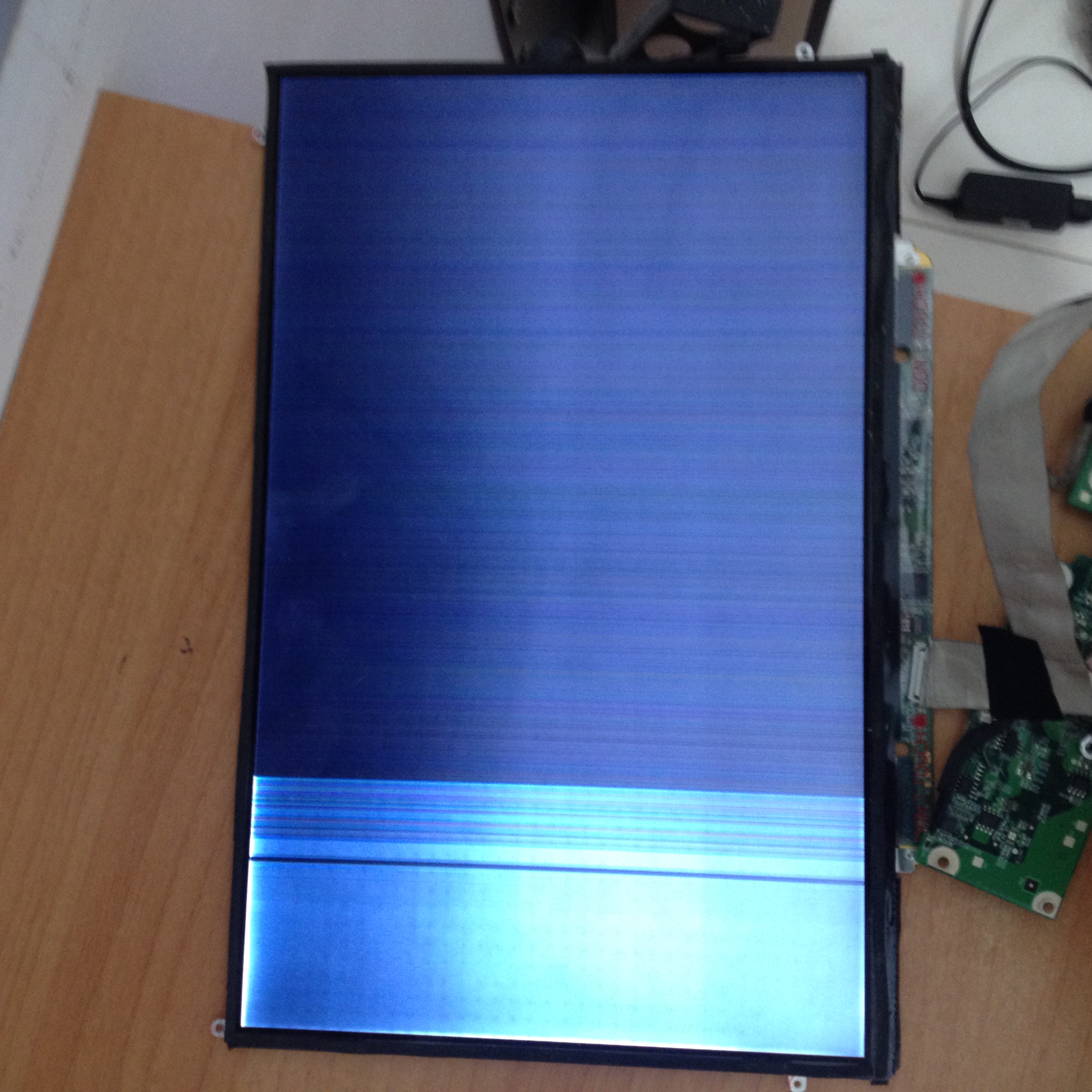

    Hi guys got this laptop,
    I need to verify if its lvds/bga/screen fault.
    No breaks or burns shows on the screen when the power is off.
    what do you think before i will order a new screen.
    (i don't have such a screen for comparison)

    Re: Vision R13 scrambled picture
    try it on hdmi.
    even there its 50% gpu its bad.
    after you need another screen
      Hi dj_ricoh,
      So the screen is bad for sure right?
        im sure the screen is the problem, replace it.

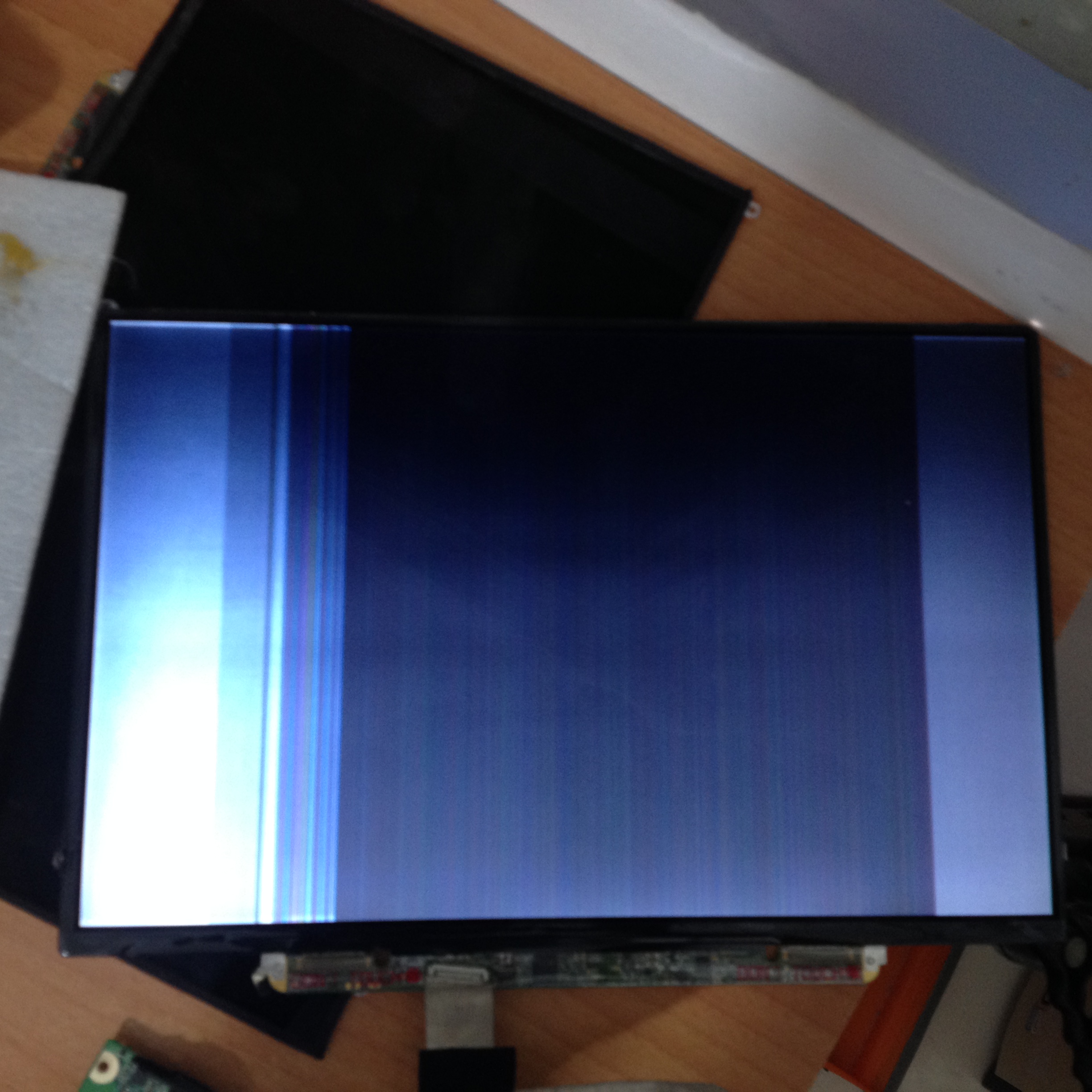

          I bought a used screen on ebay,
          got the same simptom.
          i will test the mb

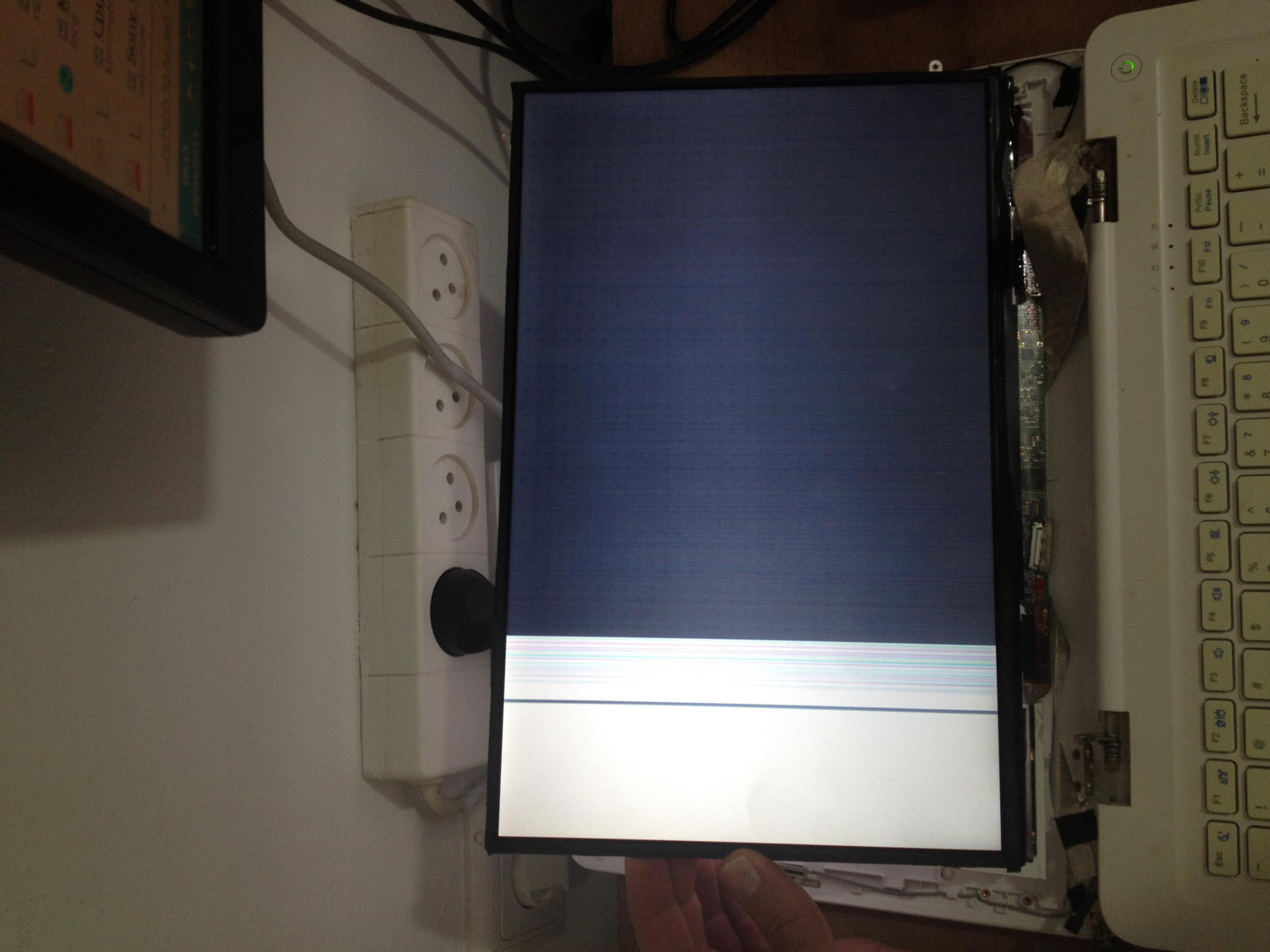

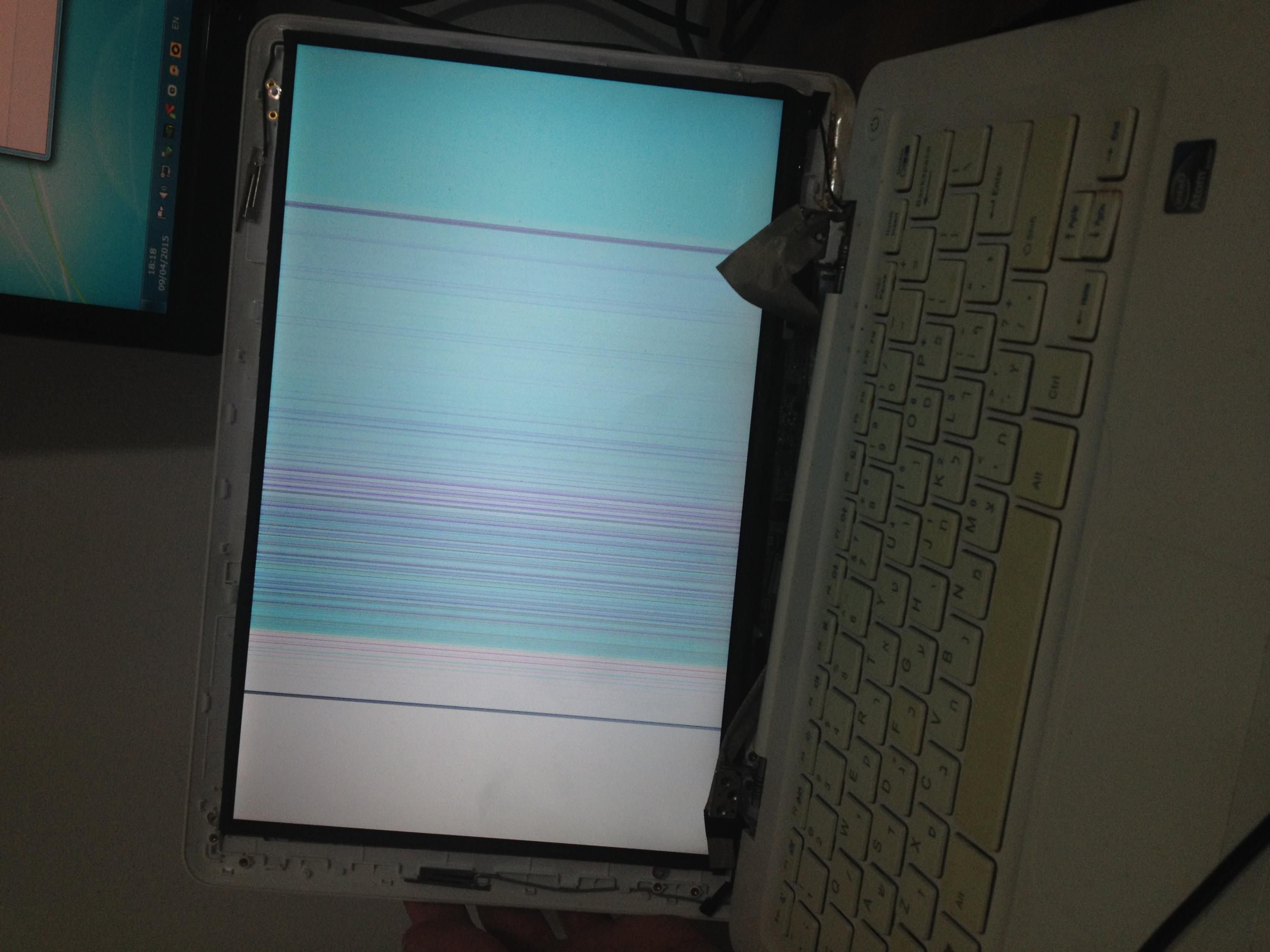

            I need some help,
            The 2 pictures i added are from 2 screens.
            Could it be that the screen i got is bad?
            maybe the lvds cable/ gpu are bad?
            really need your advice.
                have a look for any bent pins in socket on M/board
                certainly try out another lvds cable,
