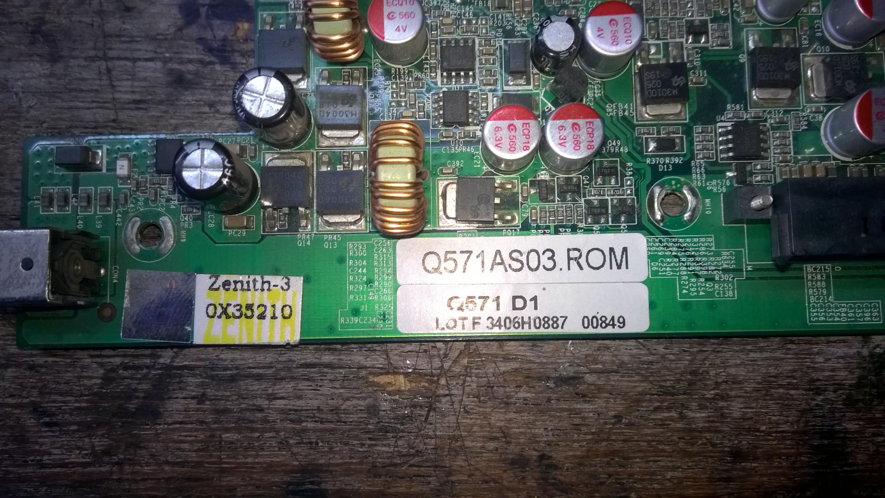

    Zenith all in one pc
    MODEL : Q570-T ver : 1.1
    RAM , processor OK
    NO display
    I NEED BOIS BIN file

    Re: Zenith all in one pc
    start with reflow !
    omg look at that chip; you see? CEMENT compound no wonder it died.
    not bios !

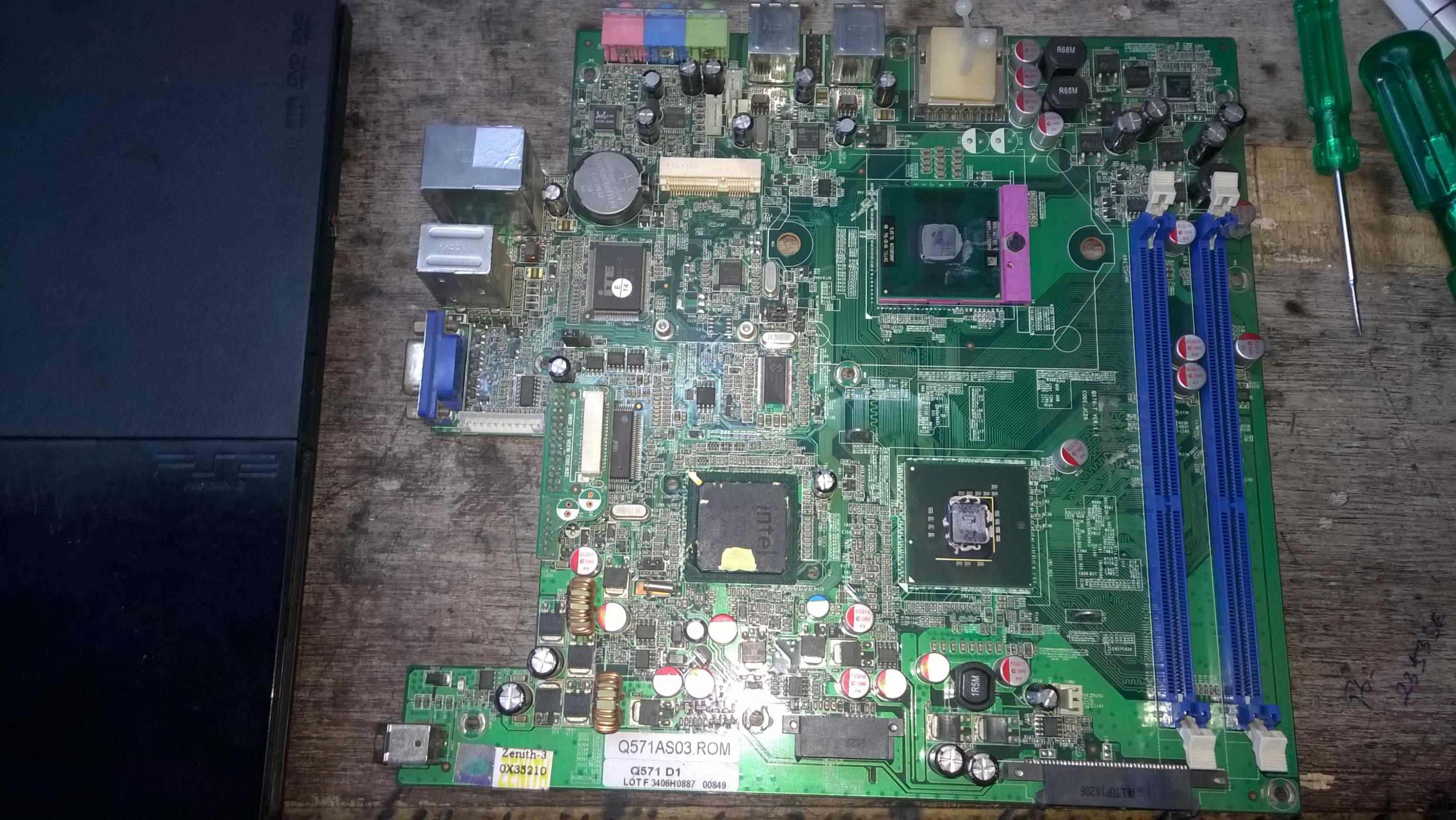

      already done reflow pls give bios

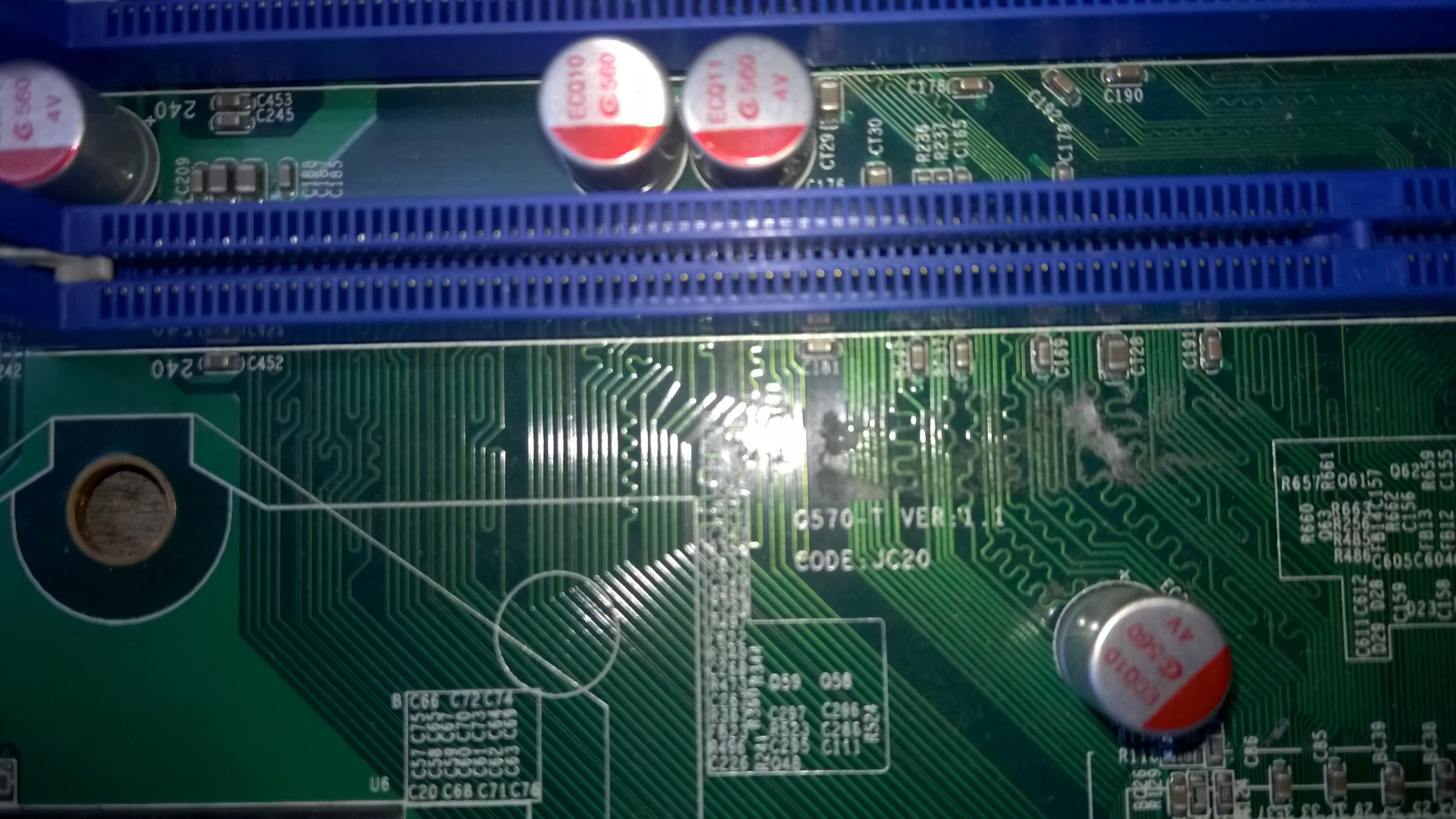

        You have a physically damaged board with damaged traces to the PCB - It's clearly evident in the 3rd photo. It's NOT the bios. Besides, since Zenith don't appear to have a website where you can download the BIOS, it will not be possible for any of us to get one.
        In other words, toss the PC in the garbage or give it to the metal recyclers. Unless you can find a whole new motherboard, it will not be possible to repair it.

          No!
          come on if those traces are bad you can remake them.
          its easy steady hands and some wires and a good iron .
            After again reblow north bridge /Io/oscillator.
            Then got display bro
            Thank you guys for helping
