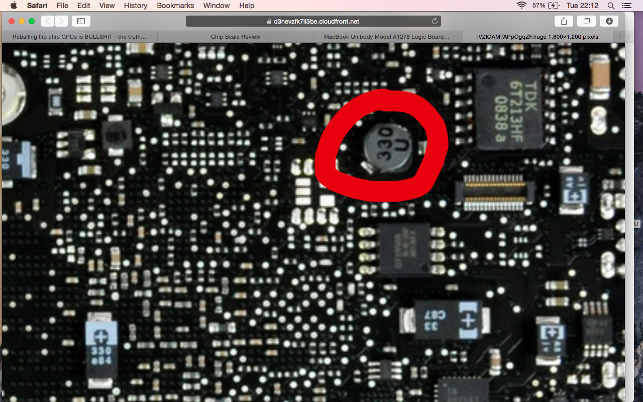

    Hey,
    Have a water damaged macbook logic board, getting fan etc but no video signal, ldvs connector has damage so will replace that but this cap is also missing - the one labelled 330u in the pic..
    is this just simply a 330u cap or is there a specific one i need to get..?
    cheers..

    Re: Macbook 2008 unibody cap..
    if u mean the lower left it's:
    C7568
    330UF
    20%
    2.5V
    CRITICAL
    POLY-TANT
    CASE-C2-SM
      the one im talking about is top right of centre in the photo, left from the tdk chip..
      says 330u in black on it..
        highlight it to be sure.
        u mean the 330U circle ? near 47omh resistor ? it's an inductor.

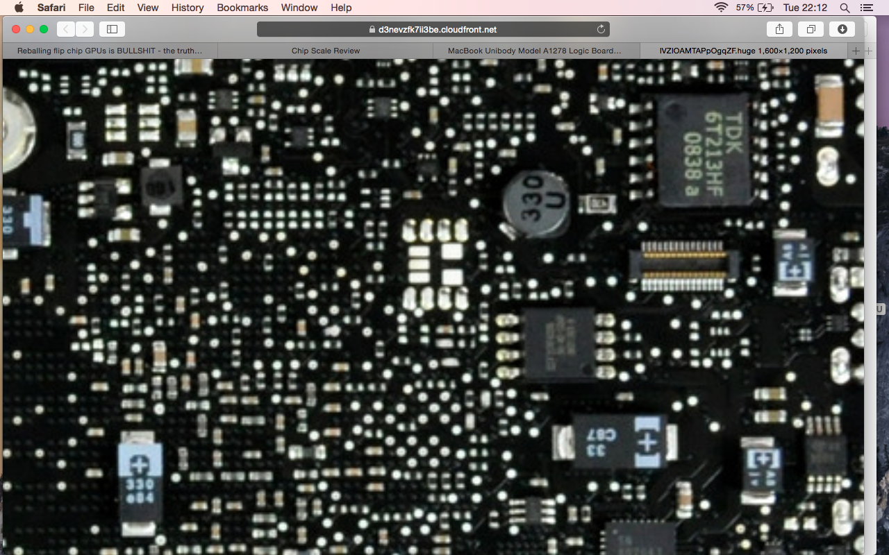

              new pic attached..
                Originally posted by liamoc74
                new pic attached..
                yes it's an inductor and very hard it get damaged.
                  ah sickened - yeah when i was cleaning the board, it must have been loose or fried and i knocked it off..
                  any ideas where i can get one.?
                    try on ebay. 33uf 330
