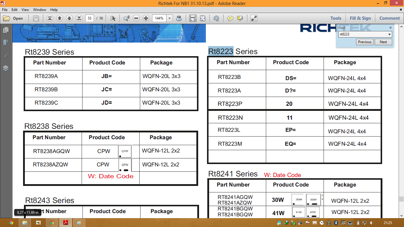

equivalent for this 24pin IC 20 ED

    please help for the equivalent part number of this 24pin IC 20 ED

        Re: equivalent for this 24pin IC 20 ED
        You can search on this forum about richtek marking code
          I already check the marking code for richtek but I did not find any value for this code.
            20 is rt8223p
              Thank you meritosari, thats a great help. I checked it yesterday but I did not see that code.
