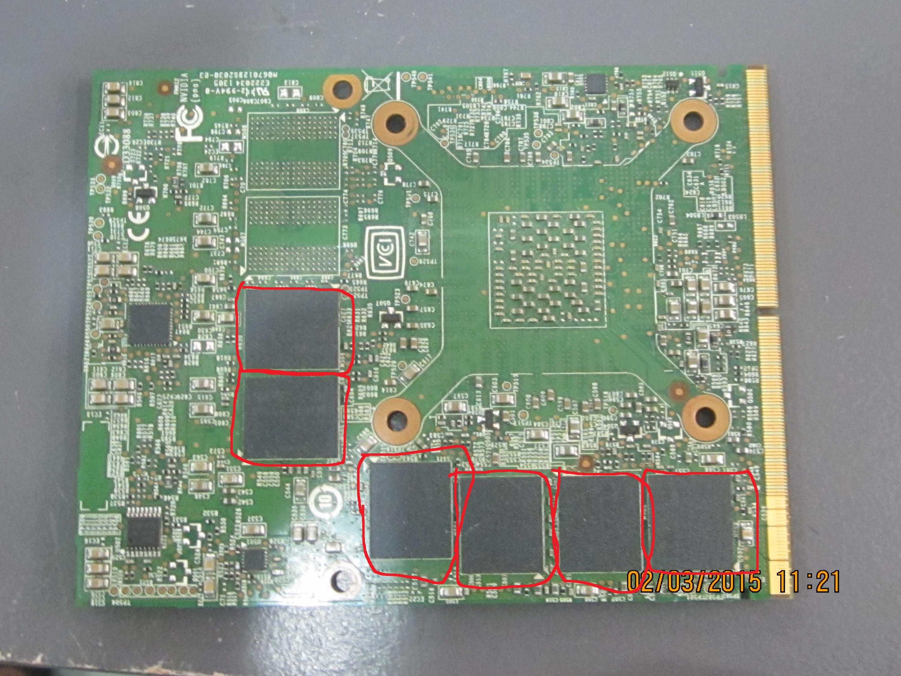

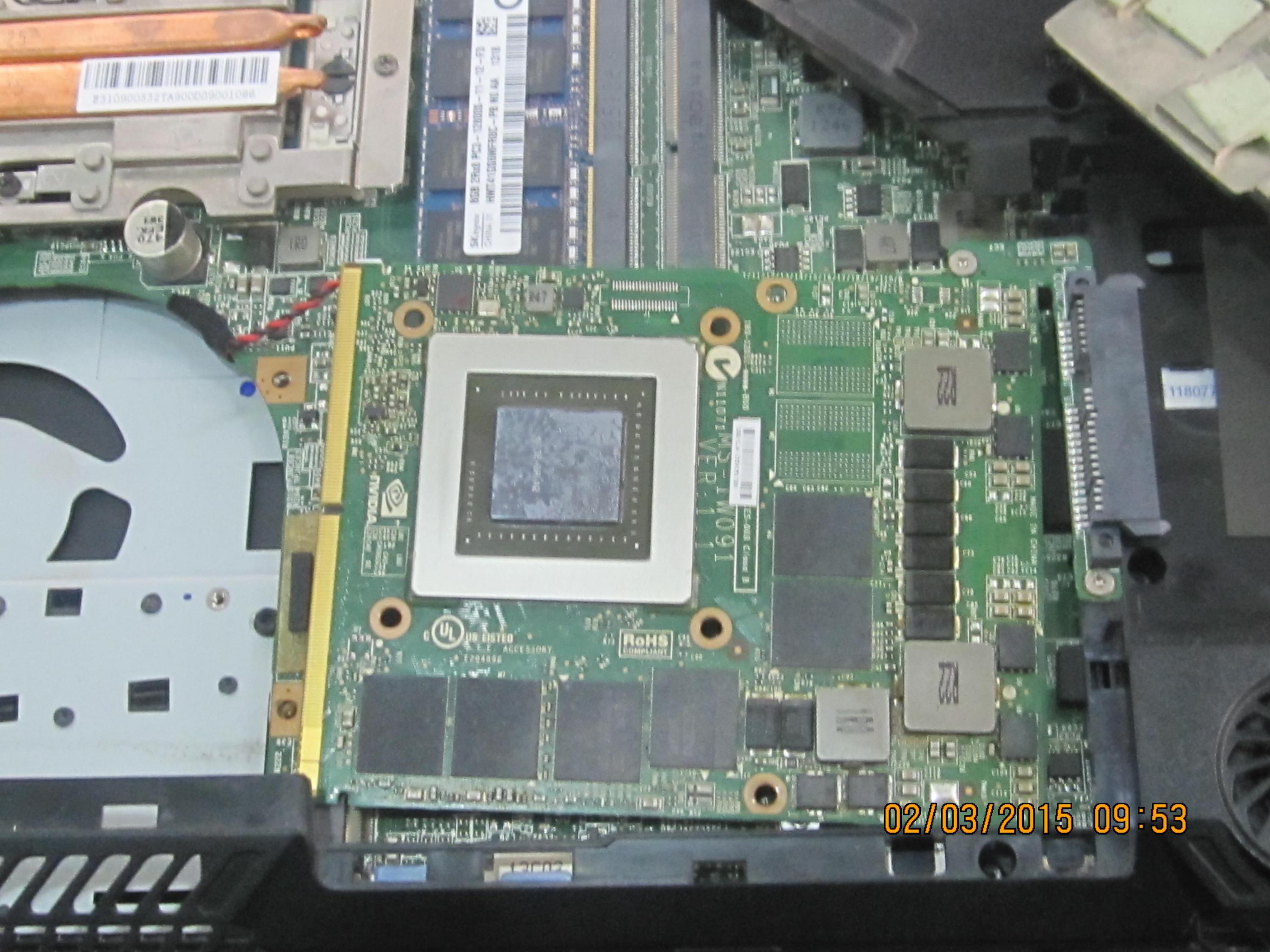

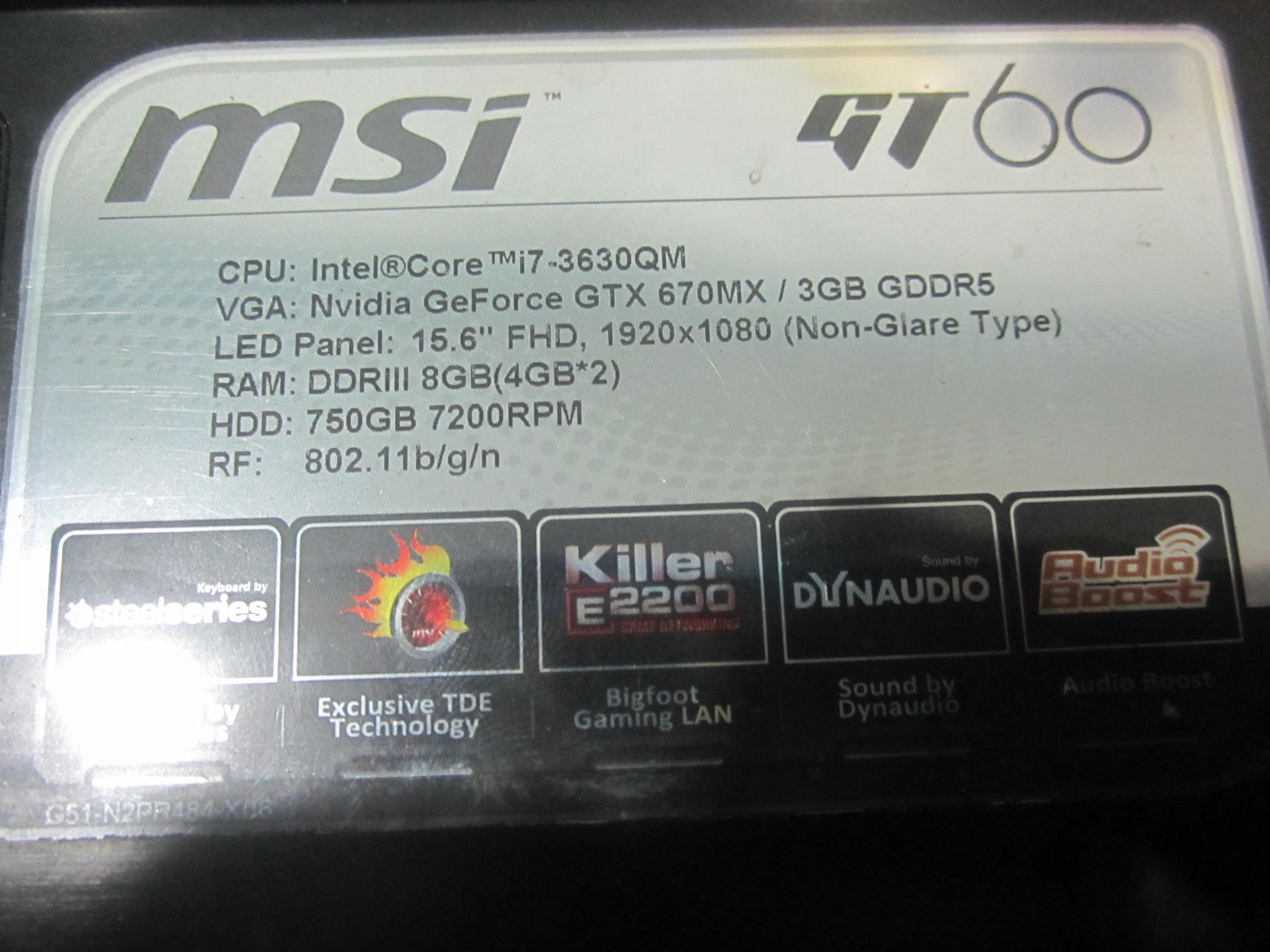

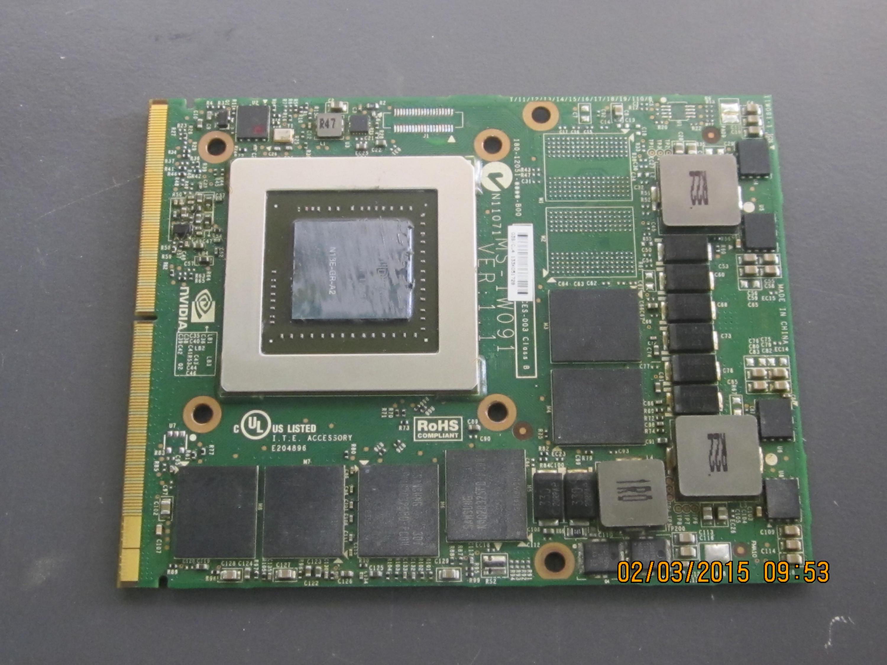

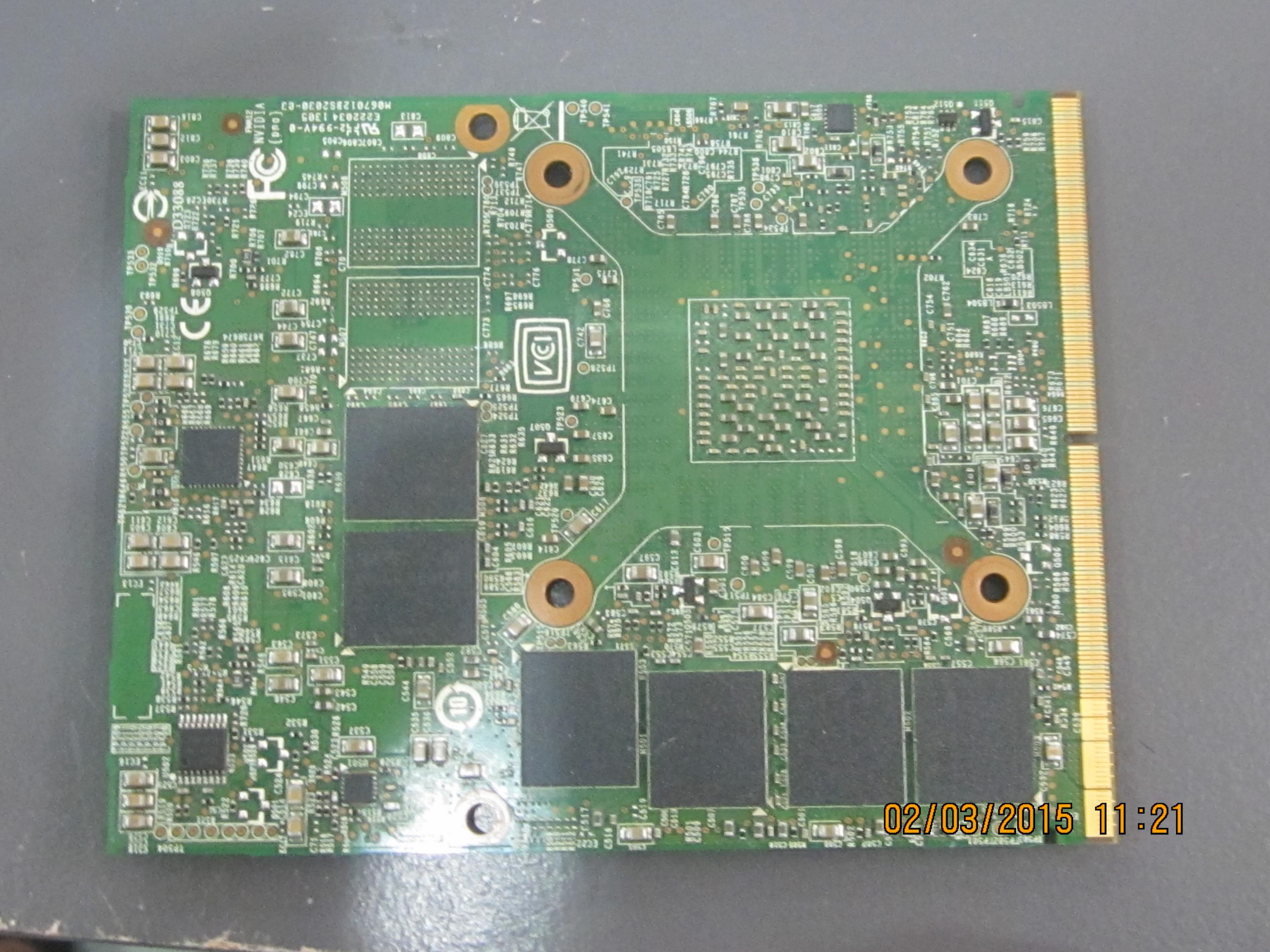

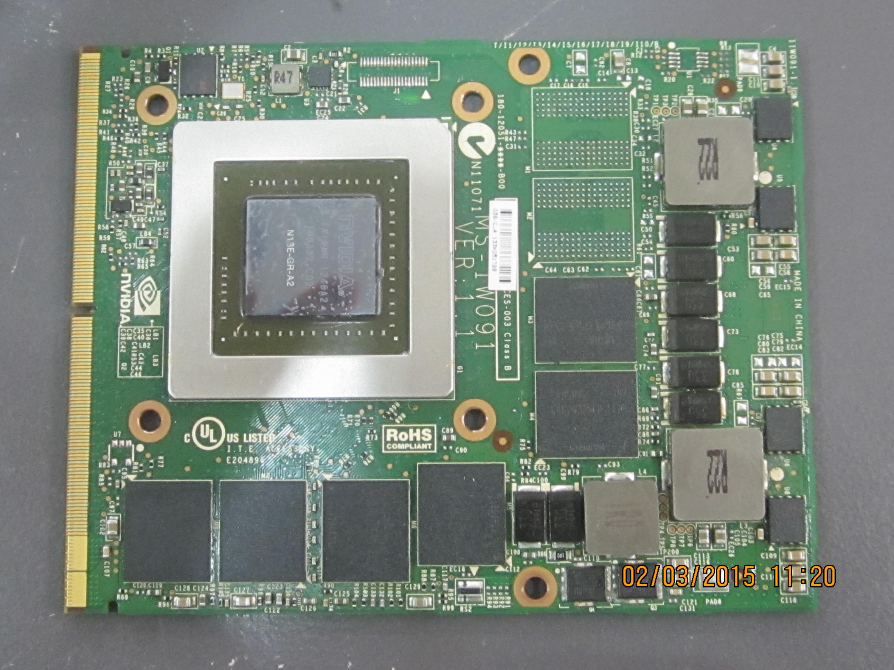

    hi all I have an MSI GT60, Nvidia GTX670 not DeTech, I want to ask, is this a VGA damaged or there is something else, thank before

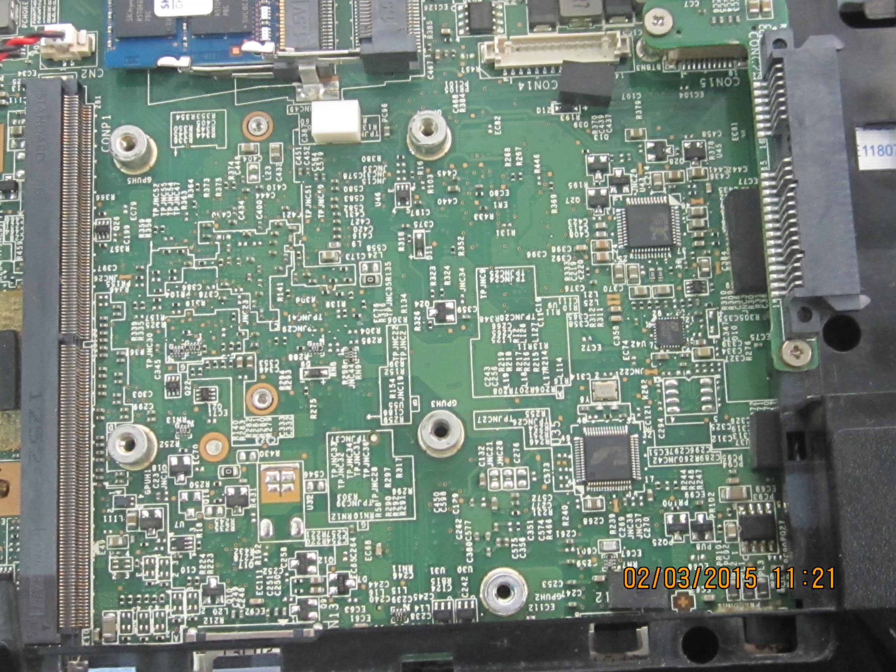

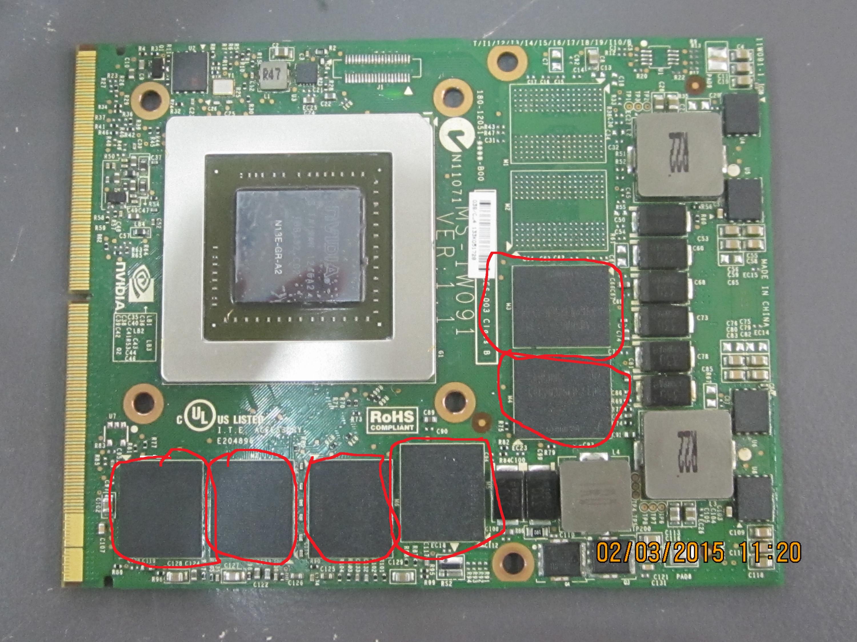

    Show us the bottom side of the board. Thanks

      Thank you

        Re: MSI GT60 Grafik not detech
        problem solved
          What was wrong?

            Graphik chip, replace the chip N cling..

              nviddis likes to reball. why new chip?

                i try rebal 3x problem not solved, last i replace this chip N i put in leptop i try problem solved, but i don't know
                between the chip is malfunctioning,
                and I took the chip replacement of one faulty VGA :v =)) but it ok
