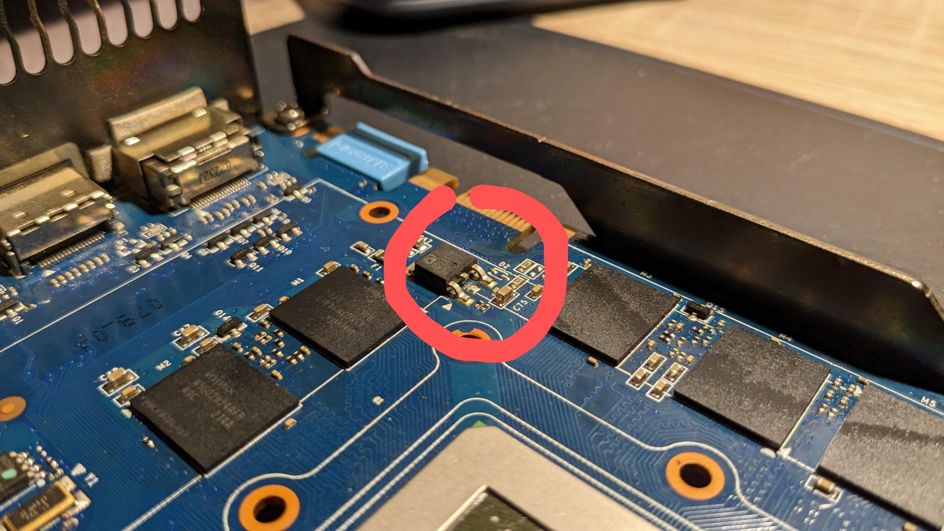

Should this Pin be connected? Gigabyte GTX670
  • saken
    • Feb 2023
    • 18
    • GER
    can someone help me to clarify if the middle pin of this APL1117 V04DU should be connected?
    In the evening i can provide pictures if necessary.
    Thanks in advance
    Alex

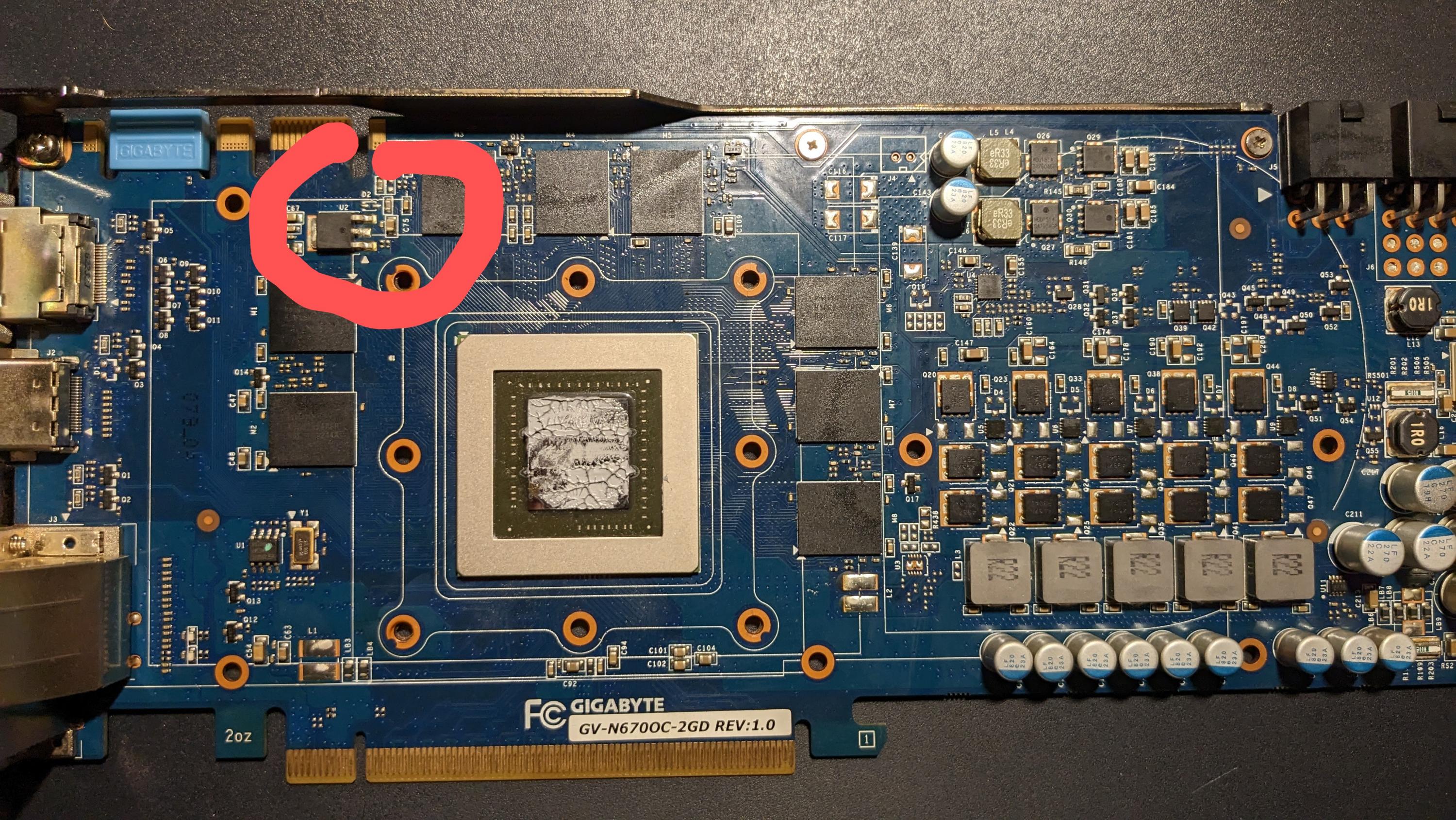

    Re: Should this Pin be connected? Gigabyte GTX670
    Edit: Its a Gigabyte GTX670 3x Windforce OC
    The issue is: - no image
    - but fans are spinning
    - Mainboard detects no VGA card
    • saken
      • Feb 2023
      • 18
      • GER
      Screenshot below.
        middle pin should not be connected because bottom of this ic is connected to middle pin7
        looks like this ic supply voltage for memory
          Hey, thanks for our reply. This APL1117 should be the 5V regulator.
            Does somebody know, where to measure pex voltage on this card?
