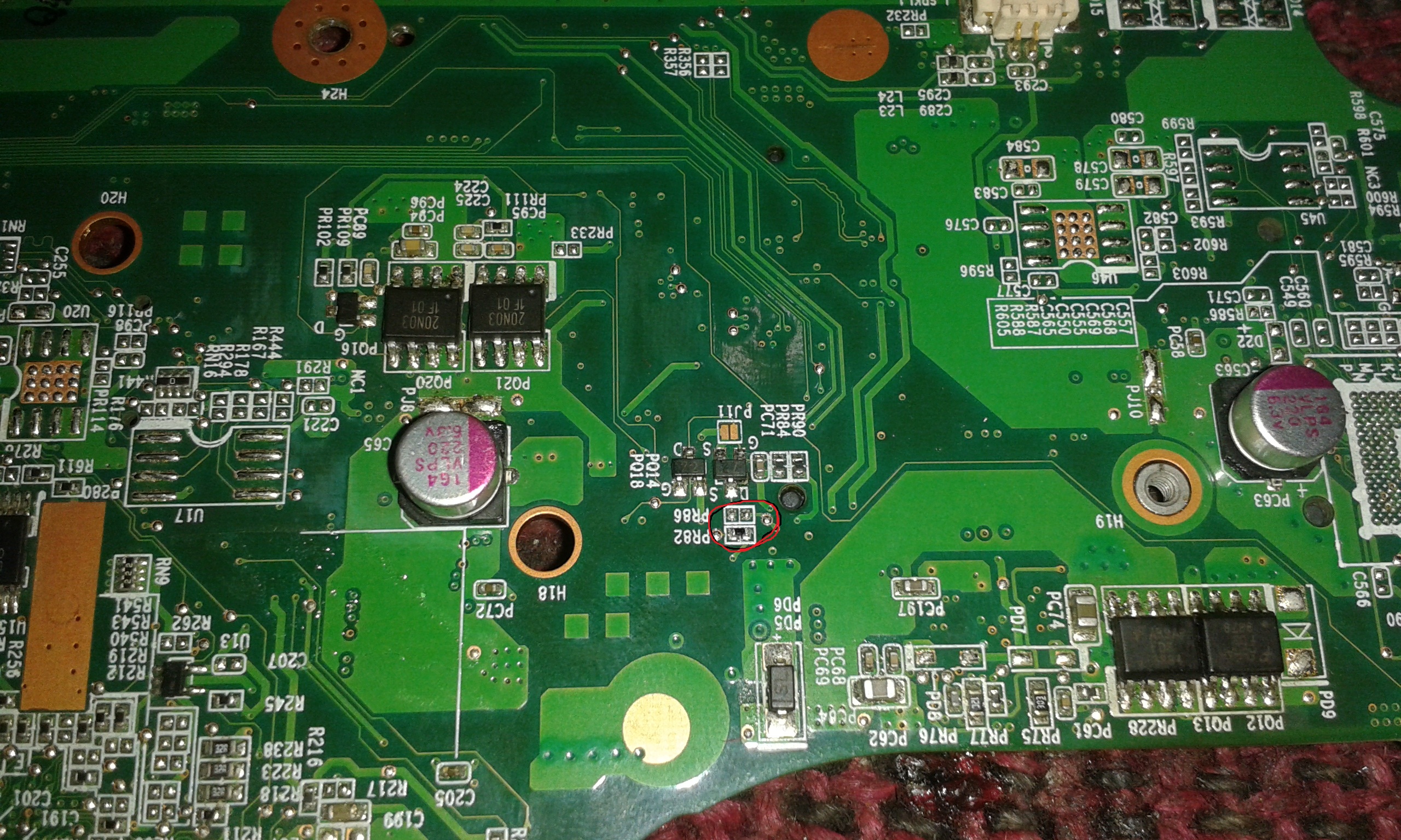

    Hi there, I have problem with this motherboard. This laptop have no power. I have check only 3.3v is present in P10 but 5V is no there in PL9. I check Pl9 to ground but no short found.
    So I have replaced uP6182 with TPS51125. But 3v present and no 5V.
    I also flash bios. But bad luck.
    So i specially need your help. Please Suggest me how can i find the problem.
    Schematic attached below.
    I wait for your help.
    Thanks advance

    Re: No 5V found in this Circuit, Please help me.
    Что на 1 и 6 выводе pu11?
        Thank for response, Pu11 PIN 1=0V AND PIN6= 0.9V
          Проверь номиналы pr82,pr86 - должны быть 0 Ом, и pr197,pr198 - должны быть 100 кОм
                PR82 =0 ohm and pr86 blank pr197= 98.5 ohm pr198=101.2 ohm
                  Originally posted by nazrul145
                  pr86 blank
                  Sorry, do not understand ...
                  On the PR86 does not show resistance
                    There is no resistor found , it is gap.
                      Strangely, the scheme there should be a resistor, not to be confused with PJ11?
                      Take a picture of the place where there are PR86 ...
                        Again it is written that in the scheme of these resistors to 100k, and you are on a 100 ohm
                        Scheme from that board?
                          Need voltage PQ14
                          Drain
                          Source
                          Gate
                            Sorrry Pr198 and 197 are kohm.
                              Pq14?
                                What's this ?
                                    There is no PQ14.
                                      Sorry PQ14 gate=4.57v drain 0v and source connected with ground.
                                        Should be 0V
