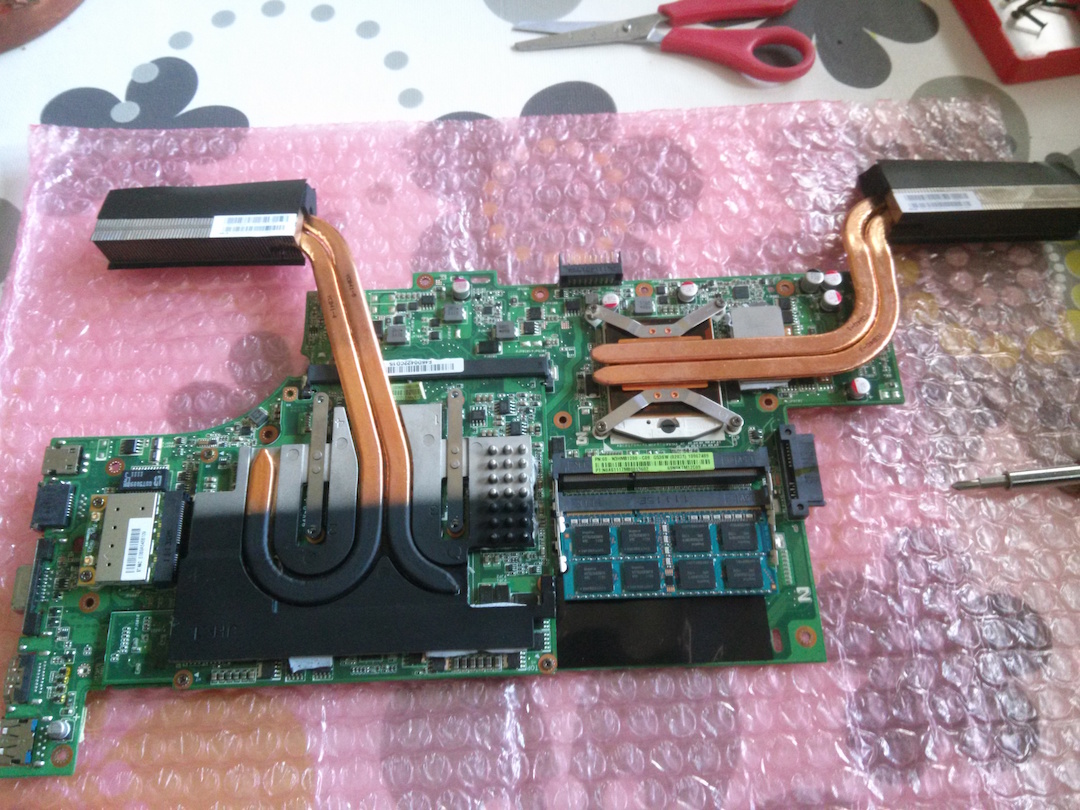

    So I carefully started disassembling it , it's not very easy but its neither too difficult.
    Reached mobo, removed it and removed coolers from GPU and CPU.

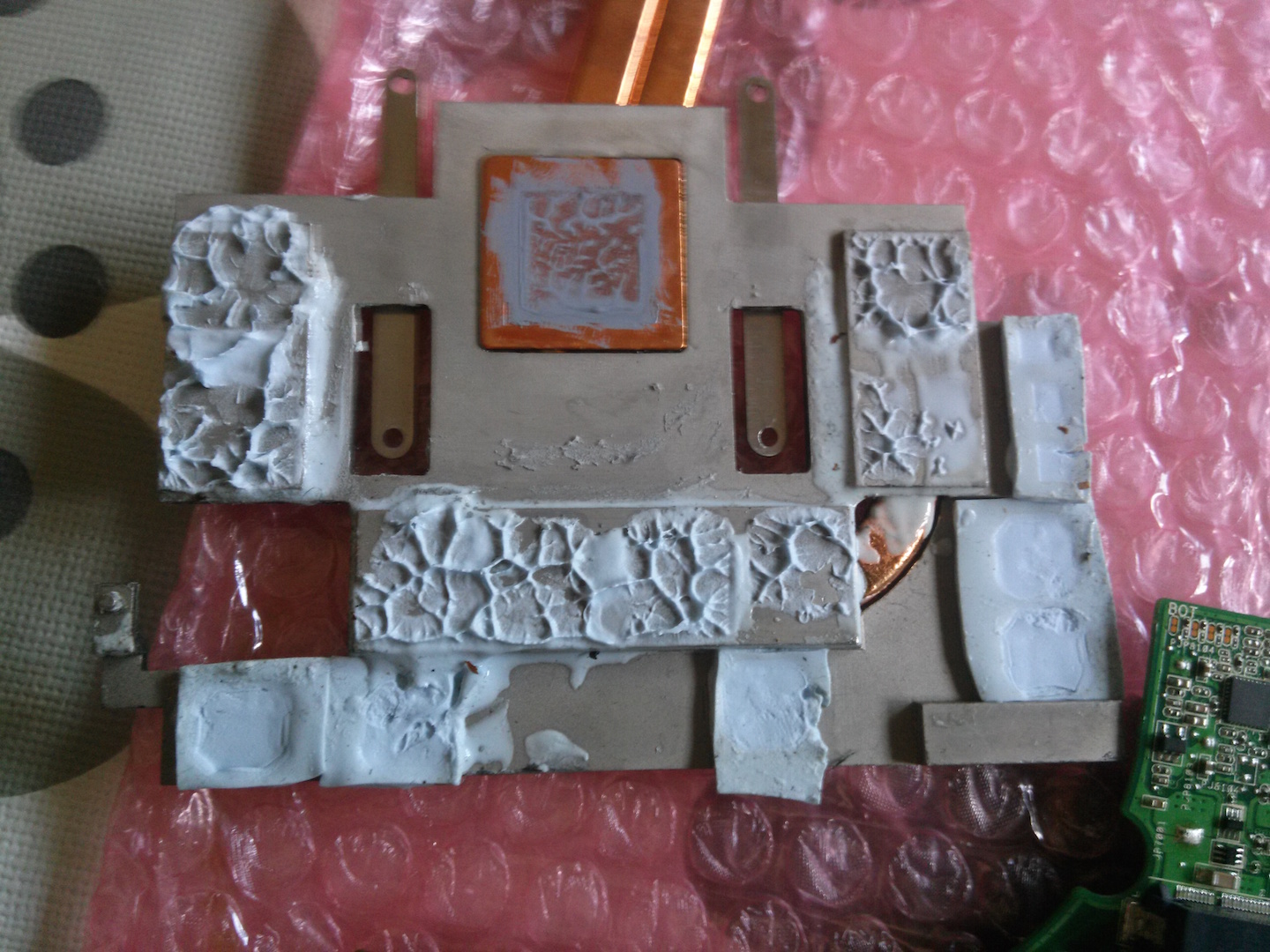

    The GPU has a lot of thermal adhesive and a "gooey" compound.
    Just cleaned the die and applied a Coolermaster thermal compound.
    Did the same on the CPU. Assembled it carefully, and turned it on.

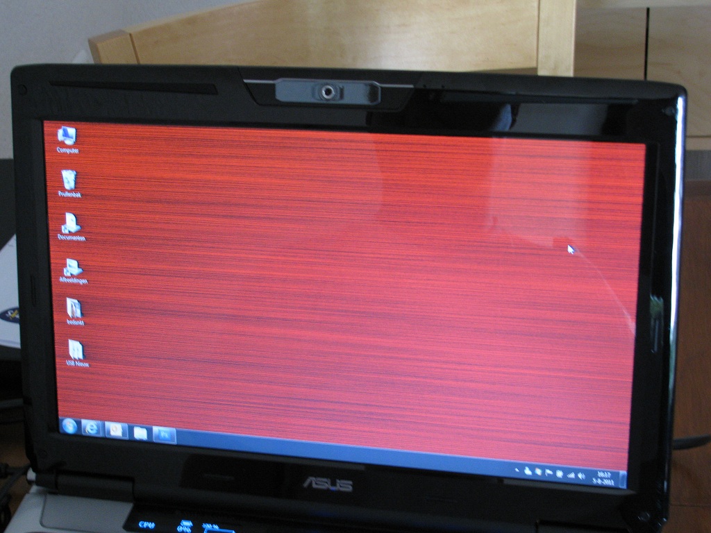

    Posted ok , entered OS ok. Rebooted, entered OS , and first issue!
    The screen appeared full of red artifacts! Turned it off right away, checked connections etc all were ok. Turned it on again and had some trouble entering OS. Artifacts again. Started to get worried.
    Didn't took photos at that moment, but first picture attached is very similar of what I had.

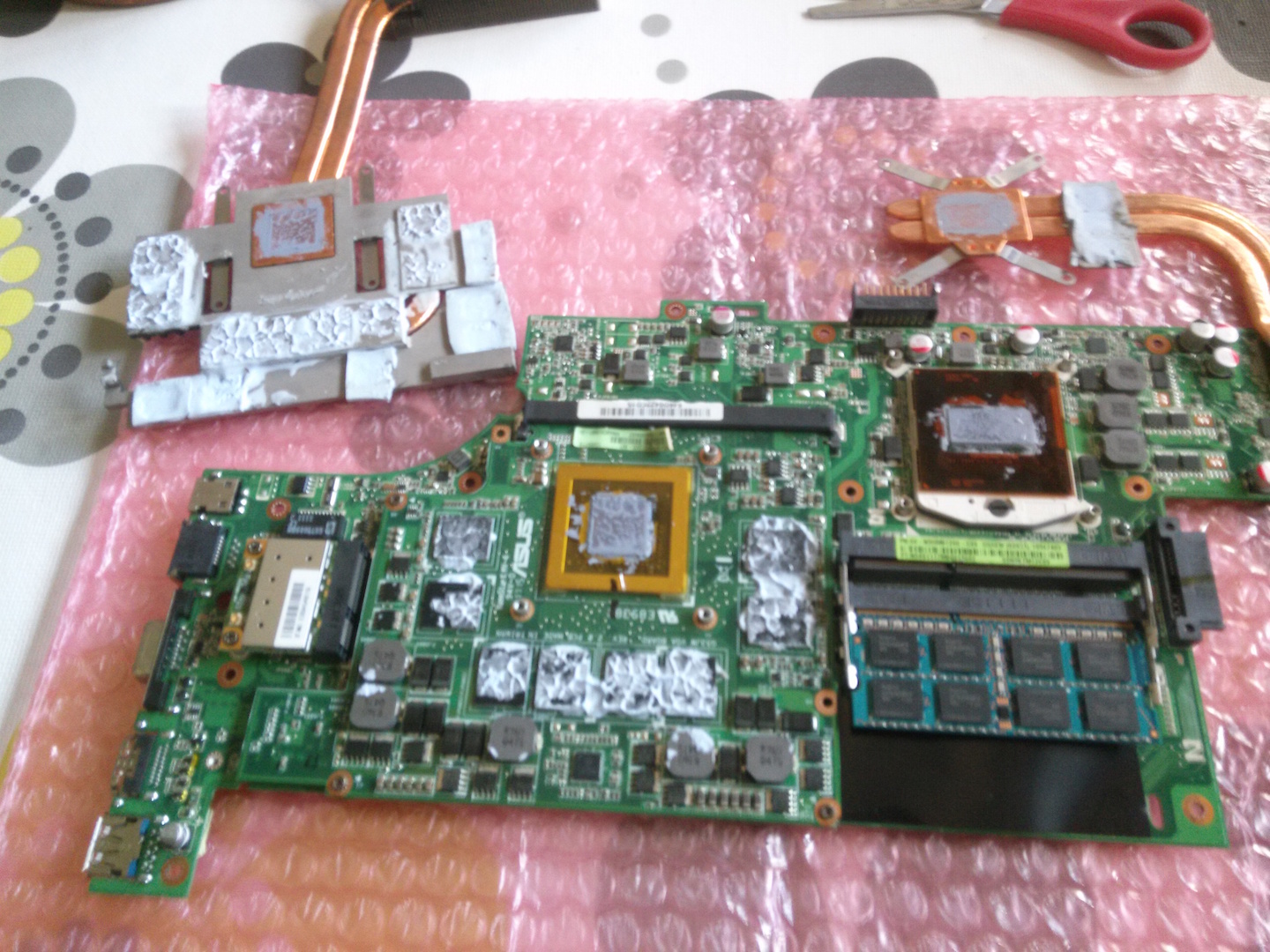

    Well, I removed the board again and here I am. I don't think anything was damaged, checked everything carefully and I don't see any problem.
    Maybe the thermal I applied on the die wasn't good and chip overheated?

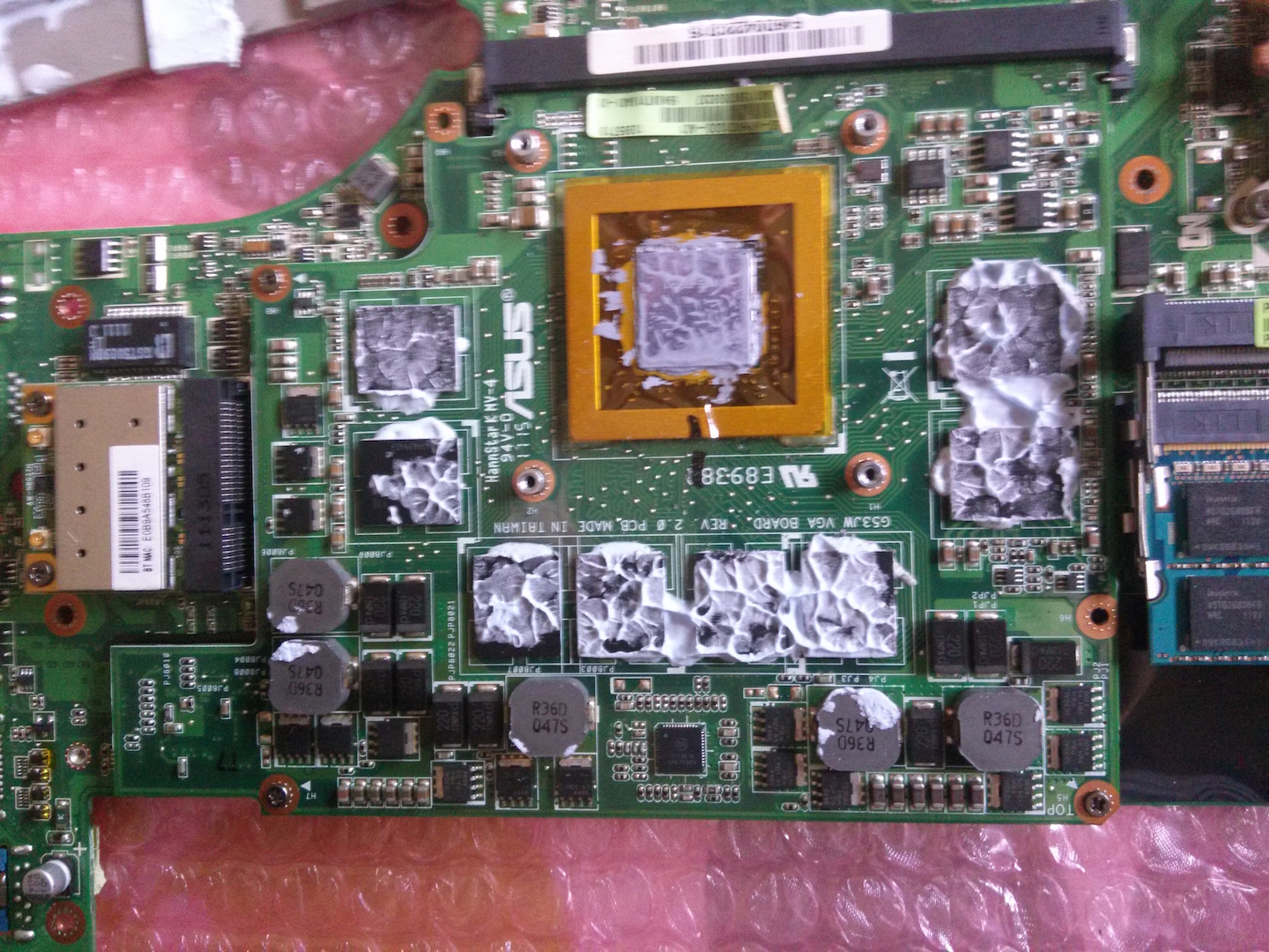

    Here are some photos of the coolers and board.
    What thermal compound do you guys recommend applying here?
    Should I remove all the "gooey" stuff and apply some new adhesive or other thermal stuff I never used before?
    I would love to get the guy back 100%
    What could be causing these issues? I'm getting mad!
    Waiting for some feedback of the gurus before reassemble it and test it again!

    clean off excess thermal compound. should only be applied on top of the chips.
    i wonder why the red stuff is only in the background?!# looks like a wall paper to me.

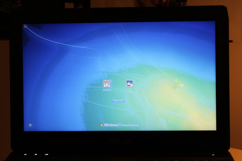

      Hello!
      Well, maybe that's not the best picture to give the example.
      Maybe this one gives a better idea, but in my case it was red artifacting and not yellow like in the photo attached.
      So I should clean the GPU and the memory chips right?
      What should I apply on the CPU and memory chips? Could I use thermal adhesive like the one used in the coils?

        Use these staff for expensive gaming laptop
        http://www.ebay.com/itm/Laird-Tflex-...item4184ffee34
        http://www.ebay.com/itm/Arctic-Cooli...item4ad39f1cd5

          I will order the thermal compound from a local store, so I will get it in a few days!
          I will order also those pads, but they will take 3 weeks to arrive.
          So I'll use the MX4 and normal silicone pads this time.
          Need to see if I still get any GPU issues.
          And to clean that mess on the memory chips? Isoprop. Alcohol?
          Thanks again!

            Yes, you can use IPA to clean the chips.

              I am no guru by any means, but looking at those pictures there seems to be a great excess of paste on those memory chips, why hasn't the paste been squeezed out to the sides? could the reason be that the cooling plate was not seated down properly when you fitted it, or is there an intended gap between plate and memory so that cooling pads should be there, just a thought

                  It came like this from Asus! I also thought it looked messy and not great ...
                  For what I noticed, the cooler sitted well.
                  Yes, the cable was seated correctly. In post and before OS, there were no artifacts.
                  Just when in OS.
                  Waiting for the MX4 and pads to clean the mess and put it in his place.
