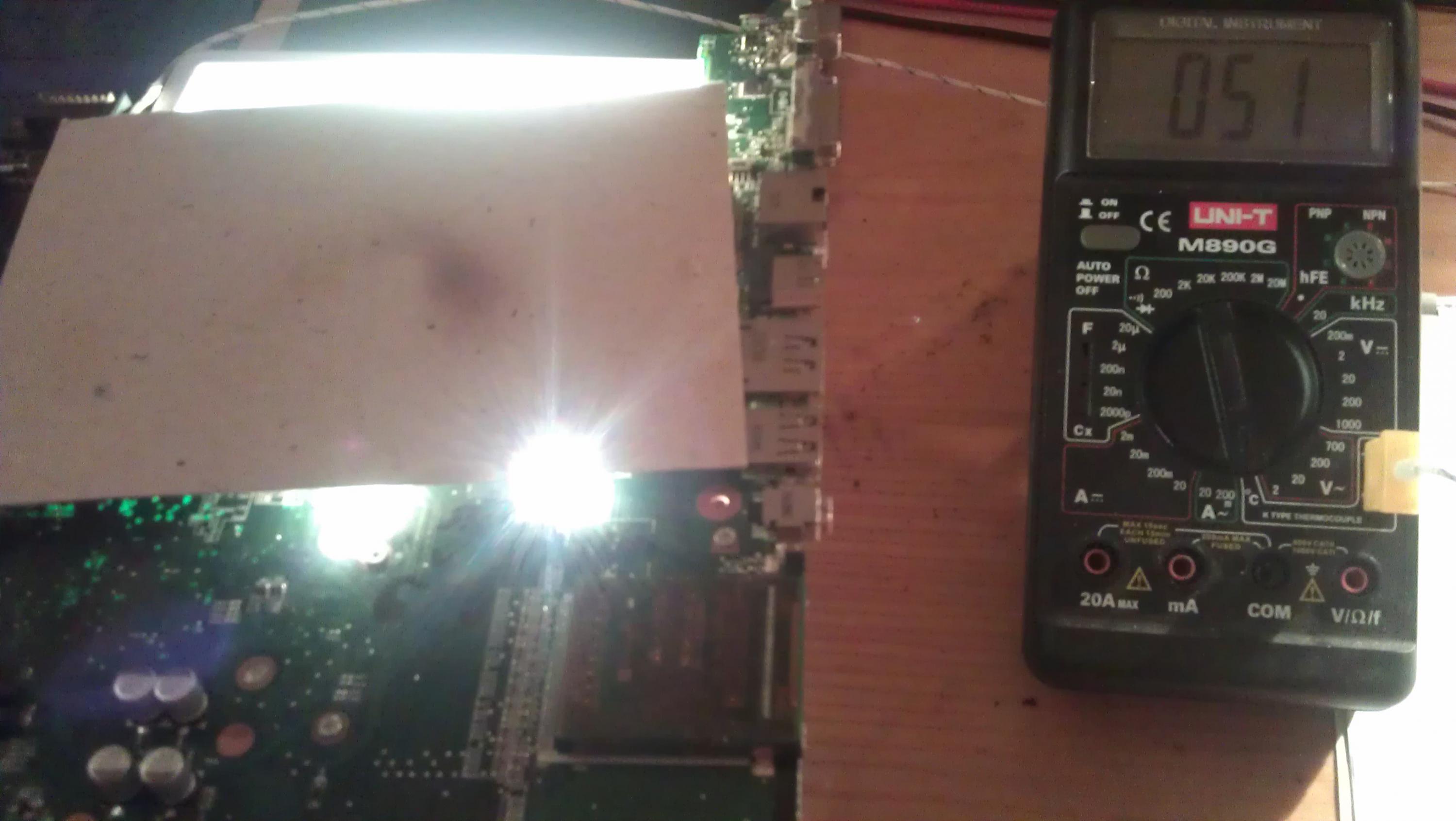

                        Re: Acer Aspire E1-531
                        or a 200W halogen light for 6eur, multimeter with thermo probe and a piece of bold paper on top
                        i was using it when i start to work on BGA. confirm it work without any problems.
                          can you explaine a bit more about this set up? have you got pictures of it in use.

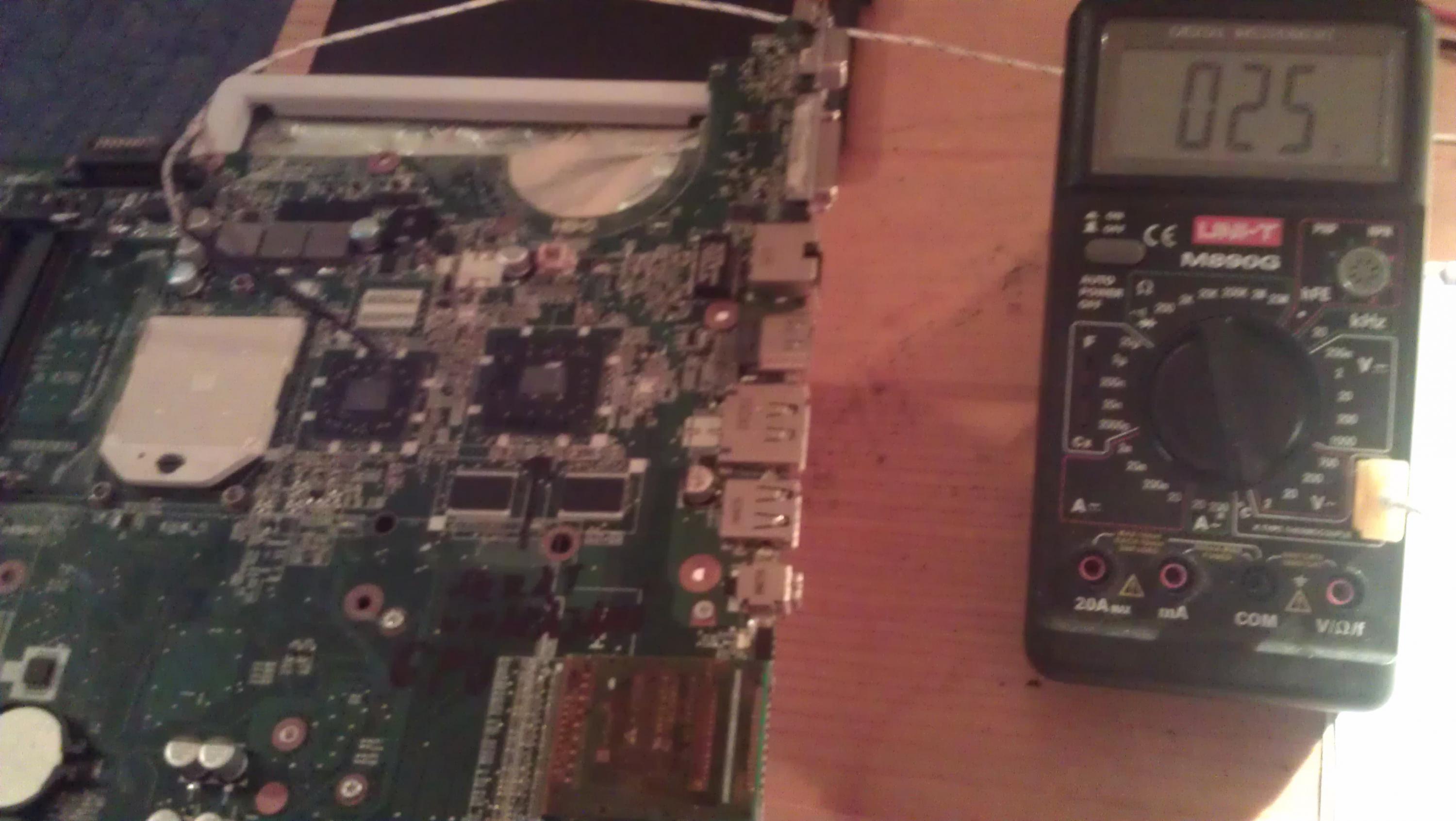

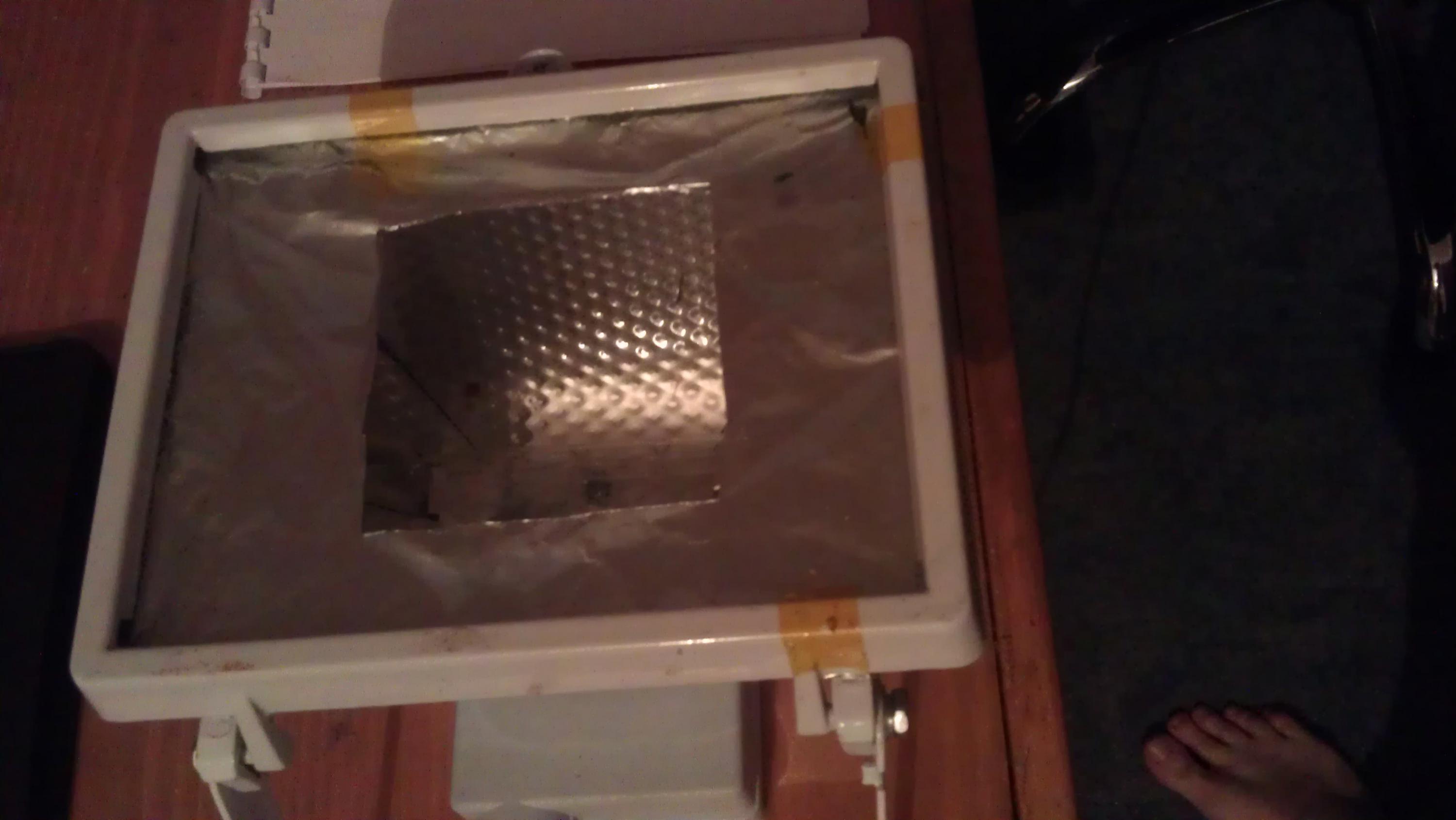

                            i dig out some old pictures.
                            i dont recommend using higher walues of lamp. 200W is fairly good enought to not damage the board or components on it. even chip is less heated than with station so it is safe for ati igp that like to die in 220+ celsius.
                            i see it on youtube video from some it guy from russia. he repaired almost everything with very shitty tools
