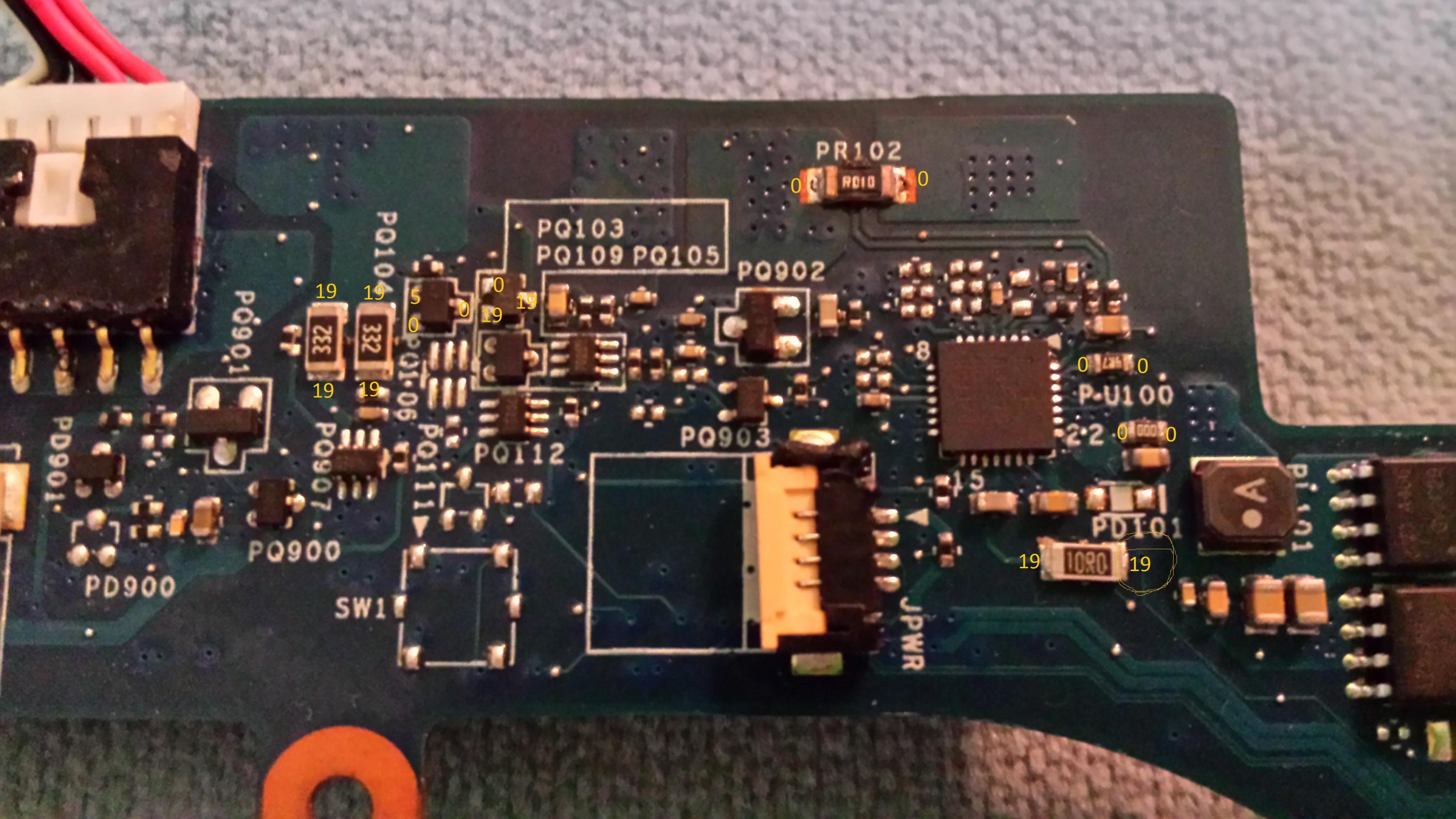

    Can't get 3.3 or 5v because 19v can't get past second power fet (PQ101). I have 19 volts on one side of the fet but nothing on the other. It reads fine in diode mode. Gate voltage is high though (19v), so is that why it's not opening? That would make sense except that gate voltage on PQ100 is also 19v but voltage passes through that fet just fine. Aren't both gates powered by the same source?

      Yes, I have a power supply, used it with 1.5v and 2a to legs 5-8 of PQ101 and voltage stayed steady and amps were .07, is that considered a short? What are the components of the gate circuit, still learning how to read these schematics? Looks like PR105, PQ105a and b, PQ103 and 104 and PR103

        check for acin, dcin, acok signals on PU100. P-channel mosfets are switched with negative voltage.

          PU100 pin 13 ac ok,see if that is ok

            check both sides of pr119

              I've got nothing at all 3 pins so the chip is getting no power (dc in), so now I've got to find PR109 but this board isn't marked too well. PR102 is marked but out of 3 other resistors in the general area, 2 of them have no voltage on one side.

                  chceck pins of pq105

                    There are 19v at pin 3 and 5v at pin 6, the other 4 pins are 0

                      check voltage of pins of Pr118 and PQ109

                        Have nothing on pins of PQ109, cant find PR118, very little on this board is marked. None of the resistors in the area of PQ109 measure 47k resistance so there's no telling which one it could be. Did locate what I believe to be PR109 (remember, no DCIN to PU100) and with my power supply put 2A to each end of resistor. PU100 gets warm with probe on one side of resistor, so removed PU100. Pad of PU100 still warm with 2A put to PR109. So chip itself not short? Next put the 2A to trace #22 and it shows short too. PC111 short?

                          remove pc111 and u see. when removed u must see voltage on sides of pr109

                            Still don't know where PR109 or PC111 is. However, found shorted cap on other side of board with power supply and now have 19v on both sides of large resistor (the one below PU100 with the circled 19) which I thought was PR109. It isn't because I still don't have 19v to pin 22 of chip. Do have 3v to pin 2 though, so the large resistor must be PR113? Next short is on one side of upper resistor to right of PU100 (the one marked 4R7)

                              on pin 22 of chip u see capacitor that must be pc111, check for short and if u have remove it

                                PR113 should be small in size. The big resistor must be PR109. You should see by traces which cap is connected to pin 22 of PU100.
