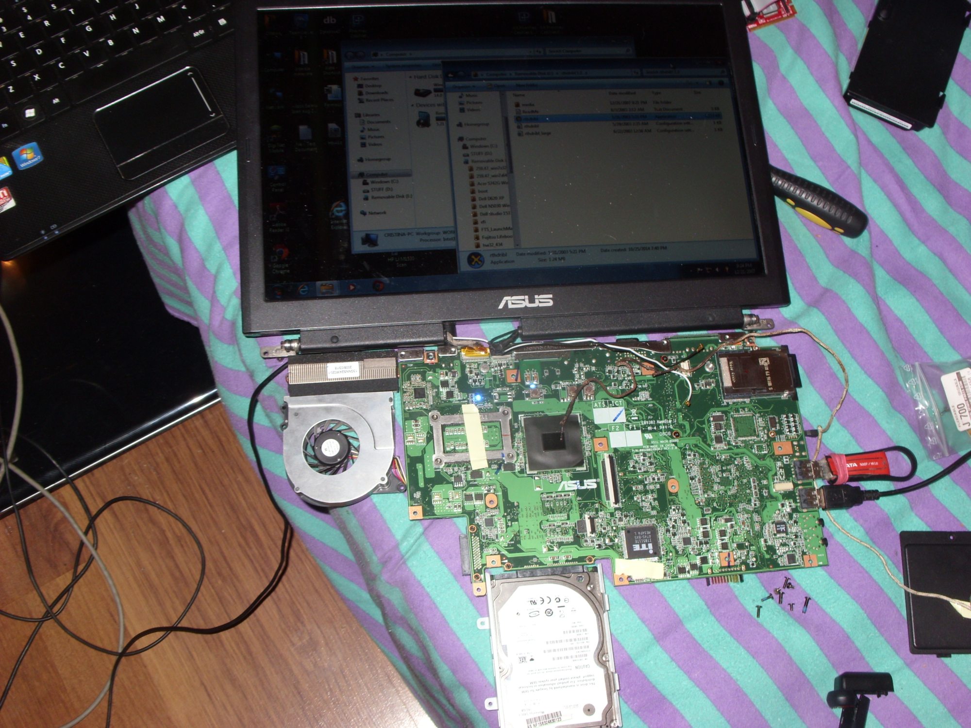

    I have this laptop in with a pretty weird issue. If you turn it on after it's been sitting for long, it will power on fine, but shut down by itself a few seconds afterwards. Sometimes it'll make it to the welcome screen but that's it.
    If you keep trying to start it, it will eventually drop into a continuous power cycling with the power LED flashing about every second or so, power button unresponsive. All rails seem to be present at their right voltages while it's on, and they all cycle along with the LED. 3.3v and 5v standby are good and stay stable. Nothing's getting hot.
    I would reball the NB but this seems to me more like a weird power issue. What do you think? Schematic attached.

      Just noticed i don't have Vcore. Or rather i have, but it's 0.02v then completely off. There is an ISL6262 in charge of Vcore. Scoped it and while it gets a steady 3.3v enable signal while the LED is on, i only see some oscillation on the gates of the high side FETs. Nothing on the low side.
      So i guess it's safe to say that the ISL6262 is damaged. I don't think i have one of those, i'll have to go buy it on Monday. I'll keep you updated.

        This is weird. Without CPU i can see the gate drive waveform on both high side and low side FETs with my scope. It looks fine and has the right amplitude. Board still power cycles without CPU btw.
        With the CPU installed, i only get a brief pulse on the low side, and nothing on the high.

          ISL6262A damaged for sure. There was a short randomly appearing between gate and source of the high side FETs. Removed FETs, they tested ok. Short was still there on the board. Put FETs back on the board, short went away on one phase. Applied power, short came back on both phases. Removed ISL, no more short.
          Will replace ISL6262A and let you know how it goes.

            Ok, this board is officially voodoo. I thought i'd try to put the ISL6262A back on and give it one more shot and what do you know...
            Got CPU Vcore, board POSTed and booted just fine. Ran all possible tests on it - no problem. It's back together now and works great.
            The only thing i can think of is tin whiskers that grew under the QFN and shorted out those two outputs. While i was heating it, i pressed with my tweezers on the QFN to make sure it's soldered properly, and a couple small solder balls came out from underneath - which means that there was excess solder on the pad on the underside of the QFN. I had not added any.
            I don't think it could've actually been something inside the ISL6262A, as shorts in semiconductors don't just heal themselves. But it will remain a mystery.
            Either way, i'm happy that it works.

                There are several traces that have the via under the QFN, close to the soldered pad (which of course, is grounded). It's not out of the question that over time, some tin whiskers could've grown under there long enough to touch the pad and thus short that trace to ground.
                I'll keep the laptop until Monday and if all remains good, it will be going back to the client.
