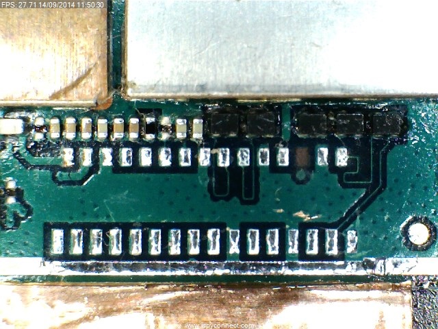

    Hi everyone,
    wondering if anyone here can give me some advice on fixing a lifted pad on my HTC one m7 smartphone? I don't have much area to play with in regards to adding a new trace, I have attached some pics of my problem, and I'm hoping someone can give me some good advice? I don't have schematics of the phone, so if anyone knows anything about the screens Fpc connector pin-out, that would be a bonus?
    Thanks for reading
    Re: HTC One M7 Mainboard
    no problem. just scratch the green layer and solder a wire as a pad

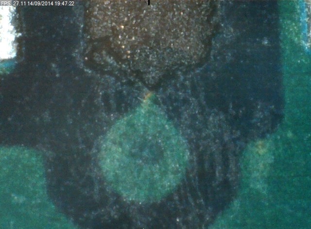

      Thanks for reply, but I'm not sure If I can? There seems to be a dark spot in the middle,Is this another layer? The area is so small to scratch, this image is @20x magnification?
      Any ideas welcome?
        Here's another image at 380x magnification
          just clean it using 99% alcohol or lacquer thinner to see it clearly...
          then just scratch the the green layer you can do it..
