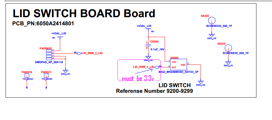

    Hi to all!
    Have problem with led lcd beck light signal from motherboard after one of lcd chips burned and fried something on MB.
    Have schematic and I fixed burned spot but I'm afraid HM65 on MB is fried too.
    So I need advice how to override MB signal for beck light switch on?
    That should be done on lcd. What to do?
    Regards to all!

    check the lidsw signal is 3,3V present.

      Thank you for your effort and sorry for such late answer.
      I checked lid sw signal and it is present. There is 3.3v.
      I have that voltage on screen as well. That is what confuses me.
      Any additional idea?

          I succeeded to do partial repair. Now I have light but can't regulate intensity of light. So bee it.
          I just installed 15K resistor between pin 7 and 8 on motherboard screen connector.
          Maybe my case help somebody else in future.
