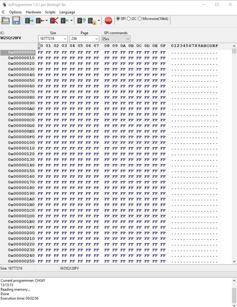

Question about IC 25R128JV
  • jocastillo
    • Jan 2016
    • 6
    • México
    I have a 0PDL board with a 25R128JV BIOS IC and a CH341 programmer, but I can't find the specific BIOS IC model in the programmer list. I read in some forums that selecting the 25Q128JV would allow me to read it, but it only reads FF . The question is, is it that the programmer doesn't support this IC or the information is corrupted?
    I have tried Asprogrammer, Neoprogrammer and CH341 programmer special edition, all the same result
  • mon2
    • Dec 2019
    • 14713
    https://winraid.level1techs.com/t/ch...-issue/96563/4
    select the JV version of the chip and test again. You have selected FV in the tool.
    • jocastillo
      • Jan 2016
      • 6
      • México
      In this programmer only have fv but in the others, neoprogrammer and ch341progeammer autodetect It as 25q128jv and only reads FF
