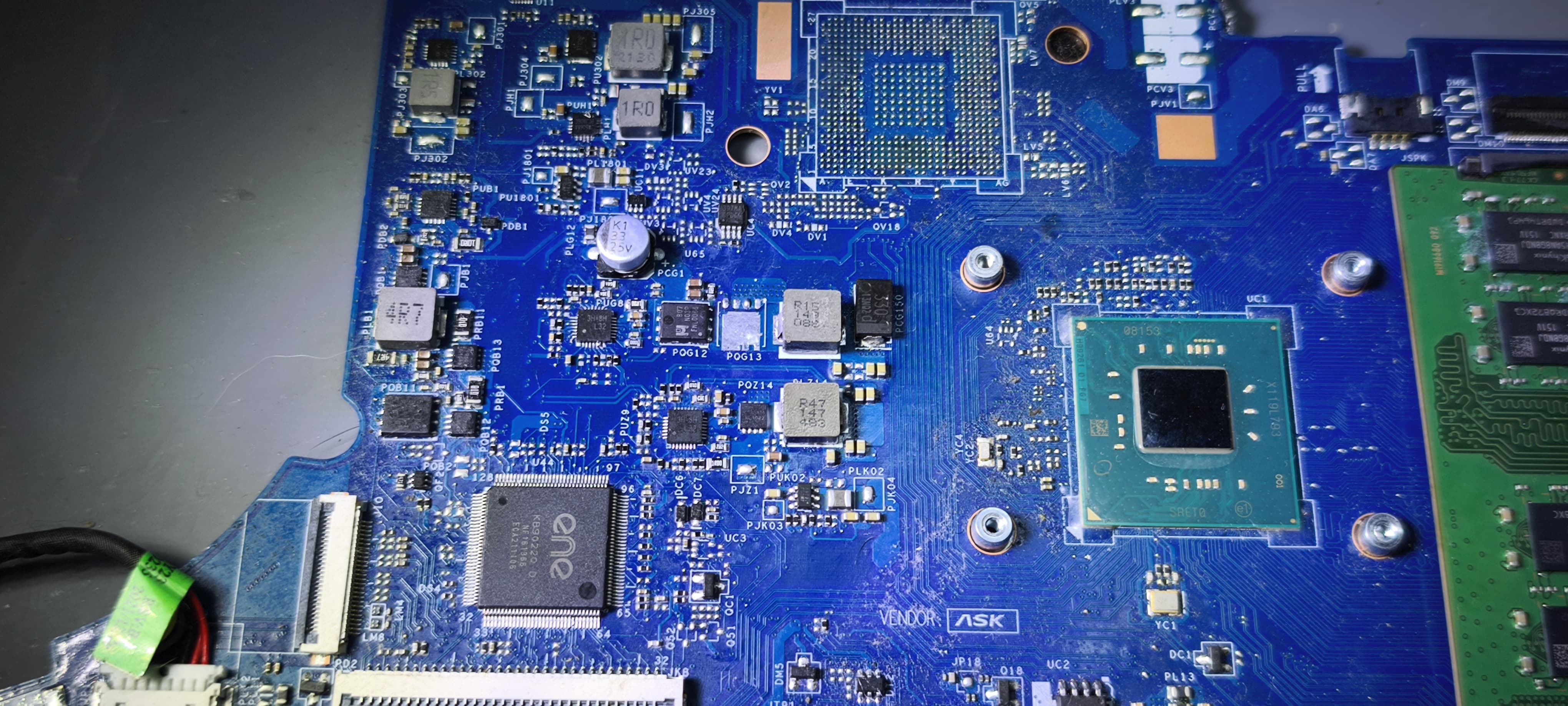

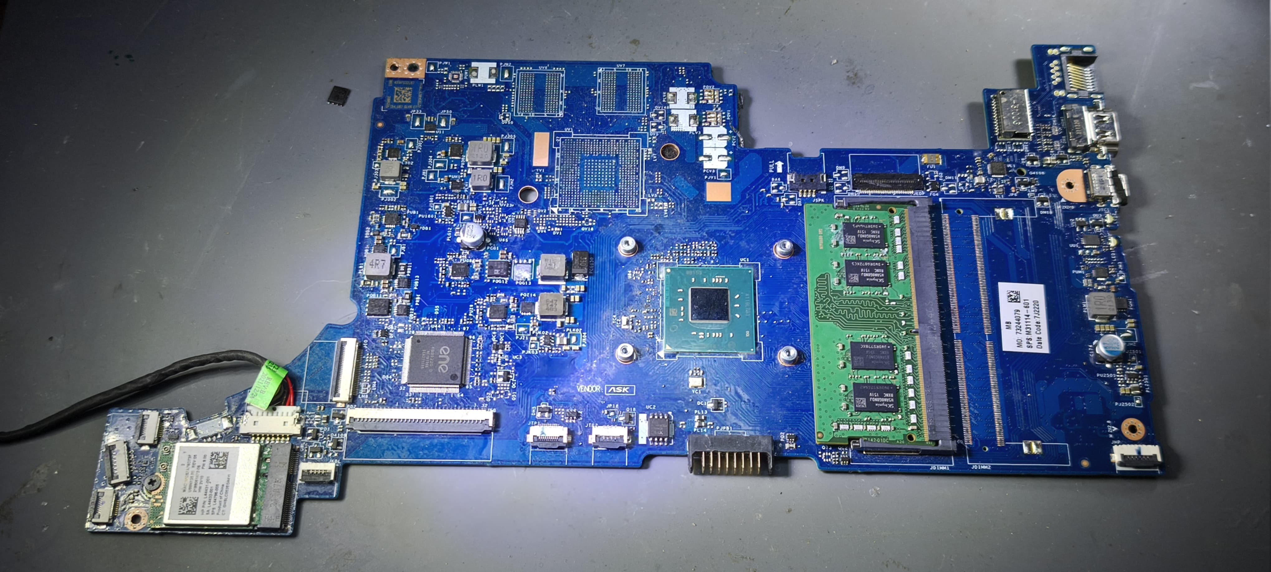

    Hi colleagues.
    Here I am asking for help.
    I've entered this HP and it won't turn on. I can't find a schematic or boardview.
    The first fault I found was a JW5069a IC (compatible with JW5068a). It had an internal fault, which was replaced, and now I have a stable 19V. When I press the power button, the LED appears, but it still consumes 500mAH.

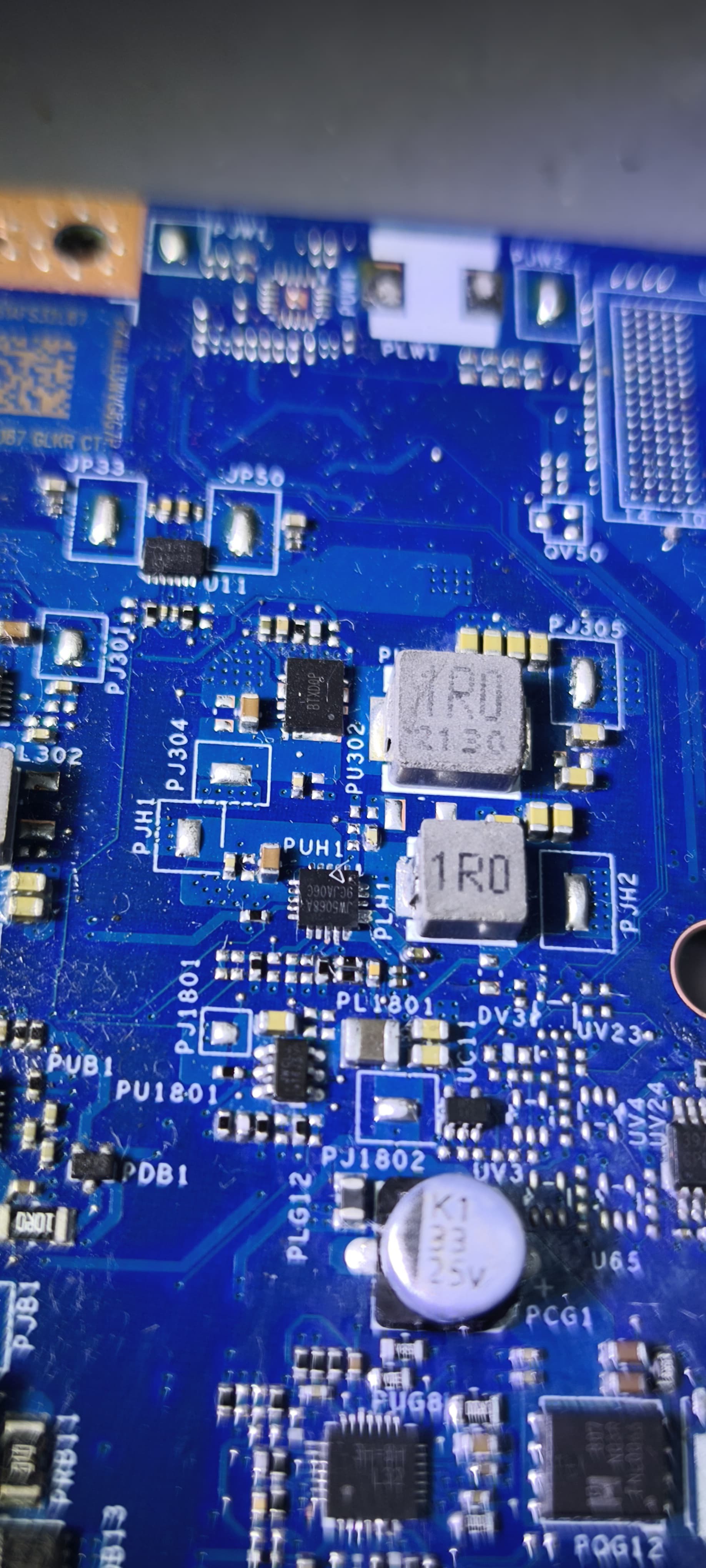

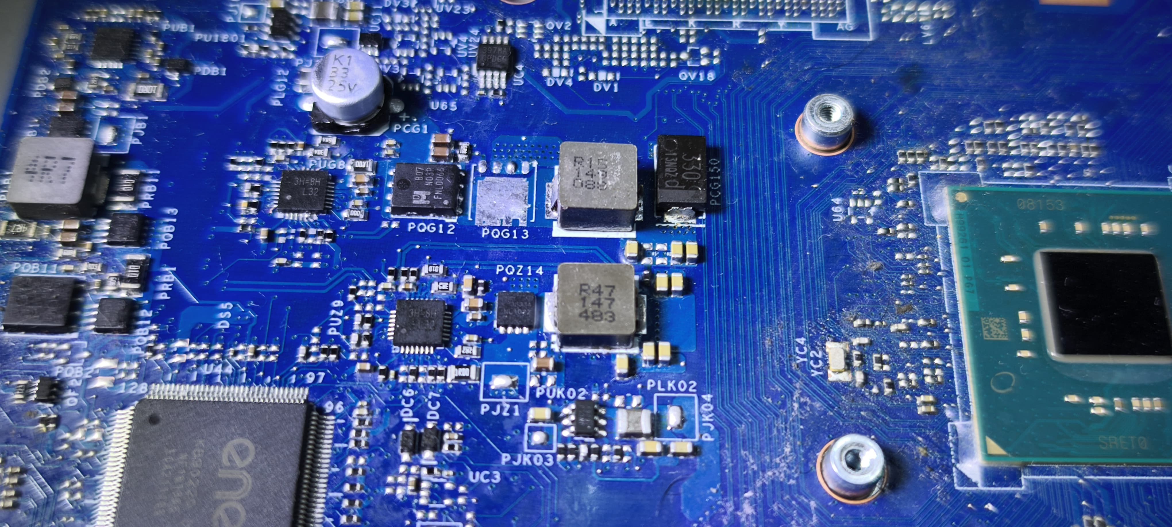

    I continued taking measurements and found that the PUG8 IC is not receiving an EN on pin 2.
    PUG8:
    Pin 1 5V
    Pin 2 0V
    Pin 3 1.8V
    Pin 8 5V
    Pin 12 5V
    Pin 13 19V

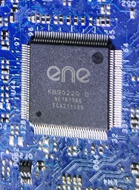

    Pin 2 of the PUG8 shows continuity with pin 72 of the KCB ENE KB9022Q D. Where I also have 0V.
    Checking the PLG13 coil. When a voltage drop occurs, it measures a short. I checked the PQG13 mosfet off the board; it shows no faults, but the board shows continuity between Source and Drain (without the mosfet connected).
    When I lift any pin on the coil, it no longer shows continuity.
    As a reference measurement, the PLG13 coil should have a voltage of 0.70 or 0.72V (reference voltage of a device with the same board in operation).
    I've attached some reference images.
    I'm leaving a reference to the KBC. I understand you can take some measurements with the PDF I'm leaving.
    If you need higher-quality images, I can upload them.​

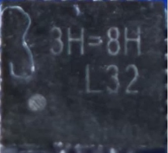

    Which part is PUG8? Is it the 3H=8H regulator?
    This is Richtek RT6585BGQW
    https://www.richtek.com/assets/produ...85AB_DS-07.pdf
      Yes, I've been investigating, but this IC, as you indicate, 3H=8H, has 28 pins. 7 on each side, it's more similar to RT3601EAGQW
      https://www.alldatasheet.es/datashee...3601EAGQW.html
      What do you think?
      I'm worried about the pqg13 that shows continuity between drain and source. I understand that's why I don't have the EN on the IC.
