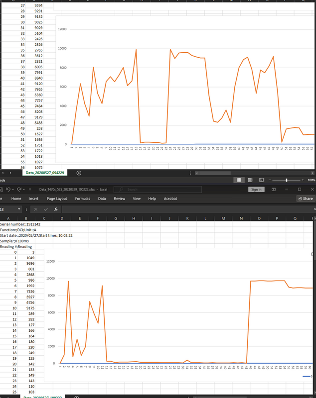

    Hello guys, I have a ThinkPad T470s that no longer starts (black display). As a reference, I have another T470s board that works normally. The defective board (with fan and display only) shows power consumption as shown in the linked image . The lower chart shows the defective board (it stays at 500mA forever), the upper chart shows the reference board. x-axis shows seconds. The heat sink also gets warm. From all this, I conclude that the CPU is operating.
    The fuses are all fine and a visual inspection of the board showed nothing unusual.
    I also checked all the voltage rails and various signals such as RSMRST (1.0V), SLP_S3, SLP_S4 and SLP_S5 (all 3.3V), as well as RTCRST (3.0V) and PWRBTN (3.3V).
    They are all identical to the reference board.
    Next, I flashed the BIOS with a clean ME region and I also flashed the BIOS from the reference board, but that didn't change anything.
    What could I check next?

          I'm wonderng about your questions: as I described in my initial post, the CPU is running, the heat sink is getting warm and the current consumption also indicates a running CPU. How can that be without having 19V at PQ1 and PQ2 and without having working 3V and 5V rails?

            Abolutely right@rumpumpel1. What about DRAMRST# on bad board?
            • rumpumpel1
              • Jul 2019
              • 162
              • germany
              Re: ThinkPad T470s dead
              for both boards DRAMRST = 1,2V
