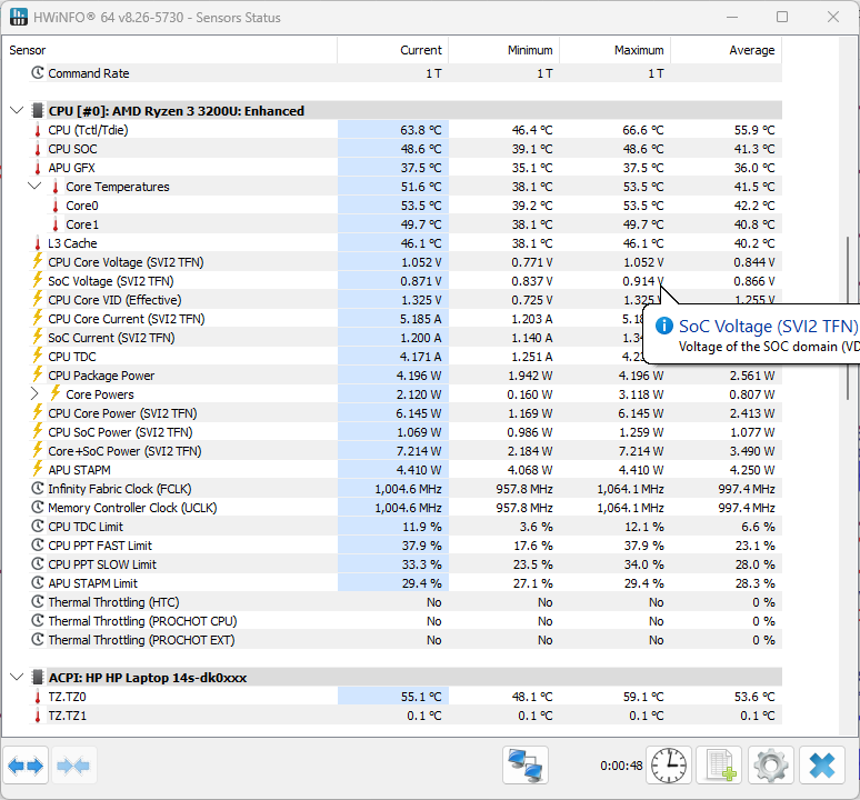

    HWINFO64 may tell the reason of the throttling, you have to scroll down, it can be thermal or power related

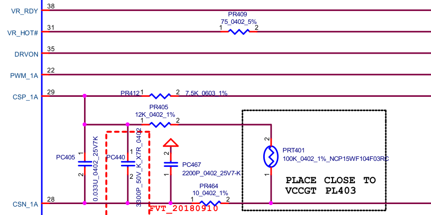

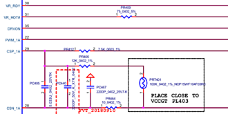

                  If those measurements are done with power disconnected from the board, then it's strange those resistors read lower than their supposed value, as they're used as pullups and pulldowns
                  When you removed PRT401 and it didn't throttle anymore, i'd suspect any component related to it to be out of spec
Name:	Captura de pantalla 2025-07-30 180940.png
                  Measure voltage at VR_HOT# at PR409, should be close to 1.05V; removing it is not recommended for long term use

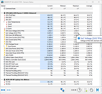

                  Does HWINFO report any strange readings? (I don't have anything with Intel CPU to compare, but look for something like this), either on the ACPI TZ or the CPU/iGPU current/temperature/power values

                      The current sense for VCCGT CSN_1A and SW_1A from PL403 (page 89) goes back to PRT401 and PR412 (page 87 of the schematics), so the issue was related to PRT401 indirectly
                      PU402 receives a PWM signal at pin 2, an EN signal DRVON from PU401, and it's supposed to drive PQ401 (pin 8, DRVH) and PQ402-PQ403 (pin 5, DRVL) for VCCGT (when it was required)
