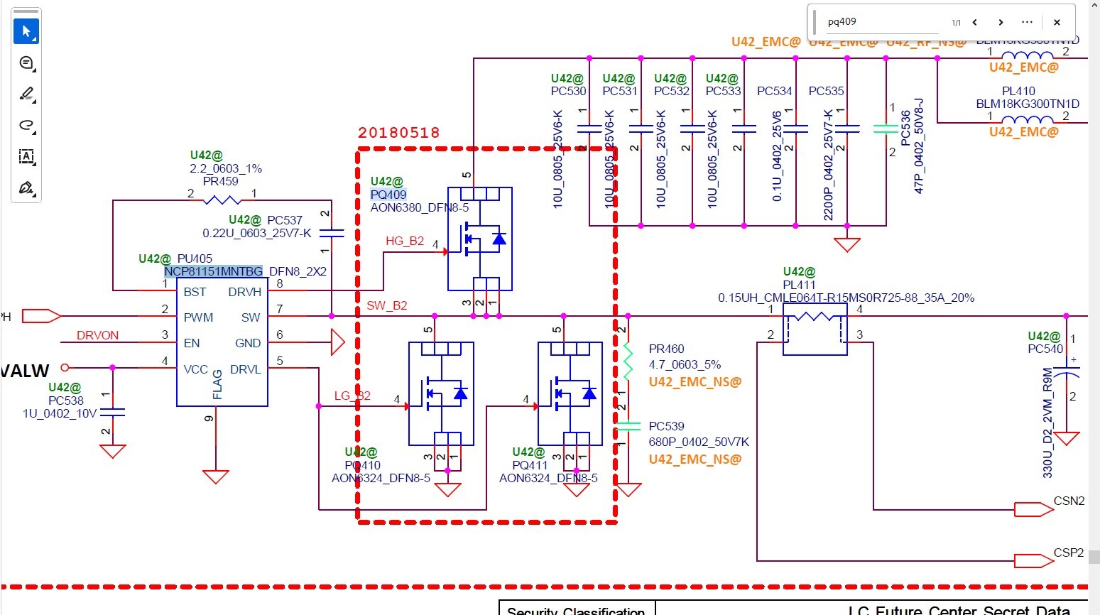

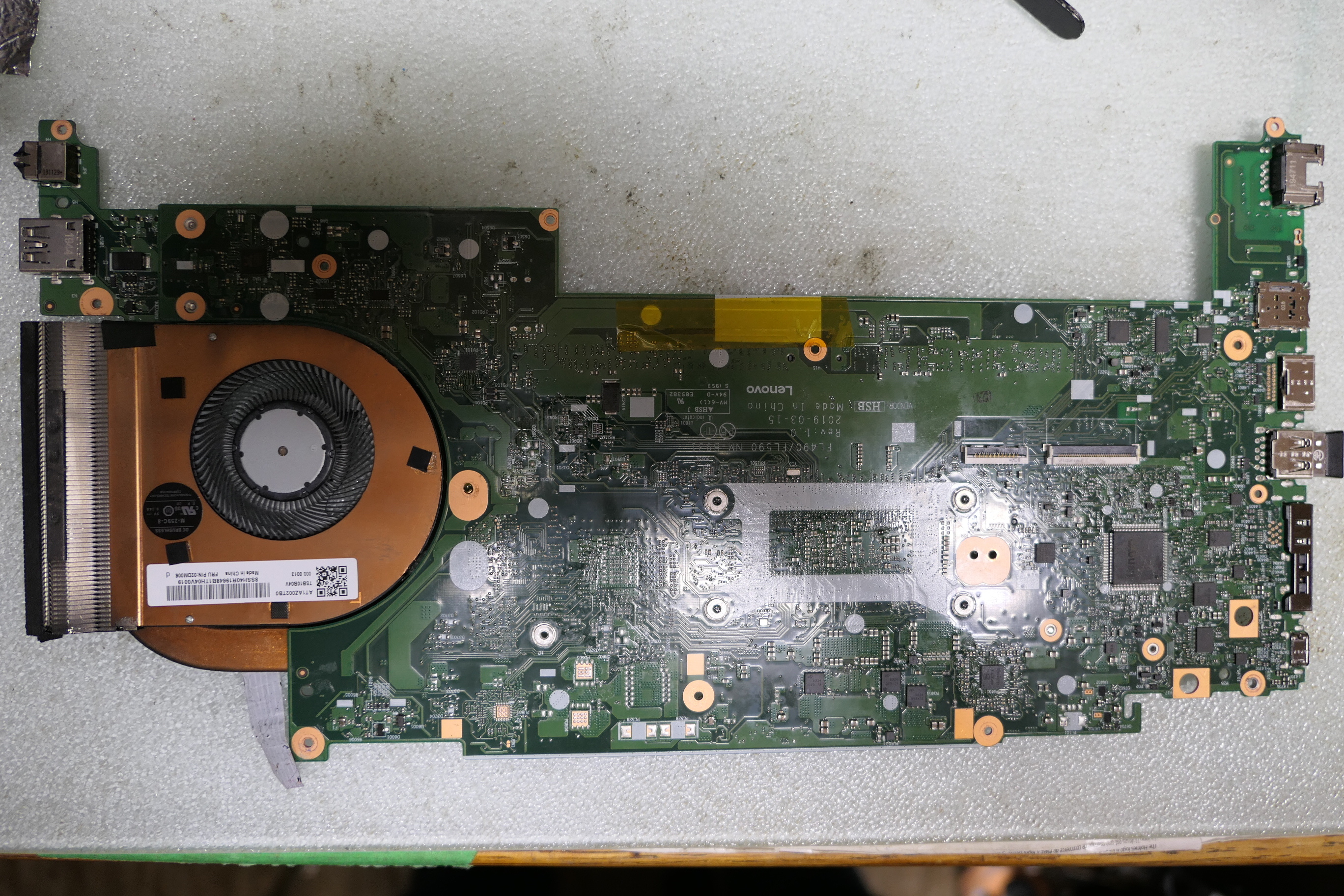

    Links to the schematic and board view is attached
    Schematics: https://www.badcaps.net/filedata/fetch?id=2077260
    Boardview: https://www.badcaps.net/filedata/fetch?id=2105881
    I checked PRT401 to PRT405 and they look ok. Also checked PR1 to PR9 and they also look ok.
    Not sure what to check next, so any advice would be more than welcome! Thank you!

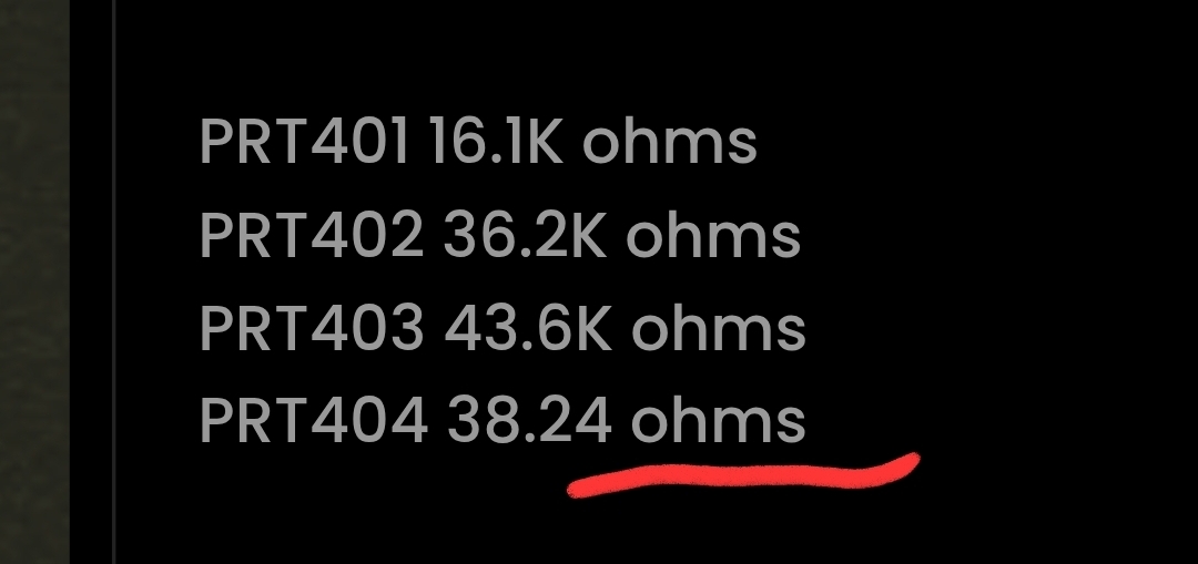

          When I trace VR_HOT# I come across PRT401 to PRT404 which are thermistors I think (NCP15WF104F03RC) and I'm not sure how to test those, when I check them no power applied, here is what I get:
          PRT401 16.1K ohms
          PRT402 36.2K ohms
          PRT403 43.6K ohms
          PRT404 38.24 ohms
          When power is applied and when the fan starts spinning:
          Power applied Fan starts
          PRT401 16.52 Kohms 16.35 Kohms
          PRT402 38.4 Kohms 46.8 Mohms
          PRT403 44.1 Kohms 54.4 Kohms (this is Kohms)
          PRT404 38.3 Kohms 43.5 Mohms
          There is no voltage on PRT401 to PRT404.
          What do you think ?

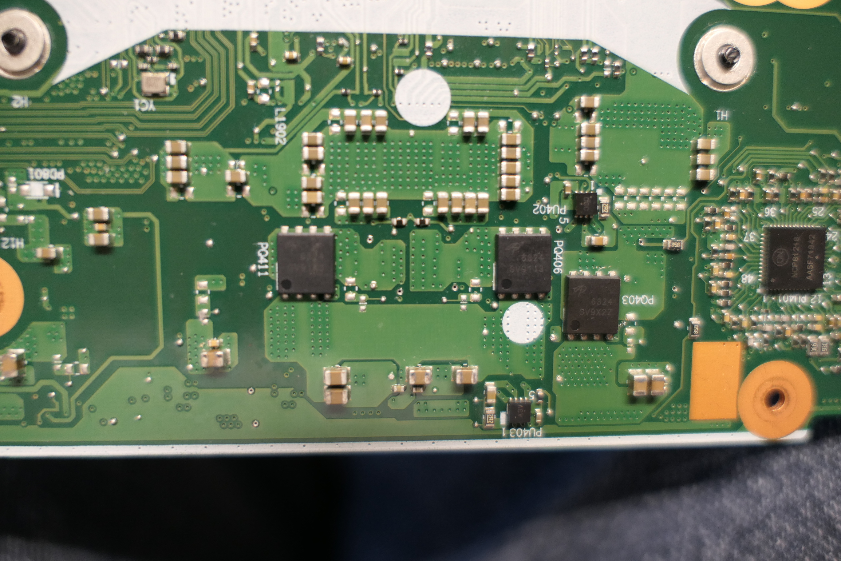

                  I should mention that I have no voltage on PL403, but I think that is for the graphics chip which is not present on this board - or maybe it's related to my problem?

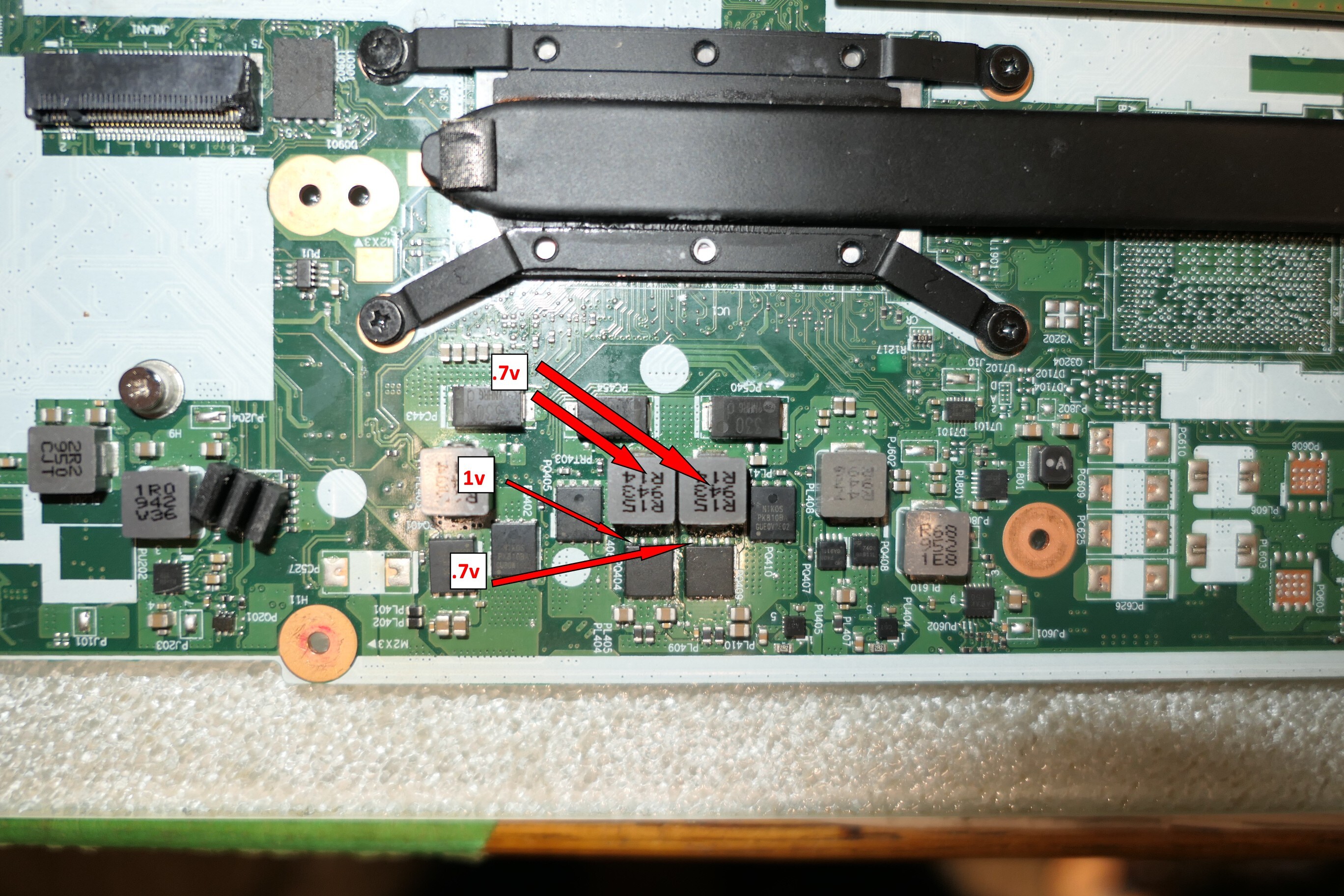

                      I actually tried both, charger and battery, charger only and battery only. When it boots, it gives me the message that BIOS recovered from self-healing. Here's the weird part - I did a test. Removed PRT401, thinking this is probably not needed since there is no graphics chip. What do you know, it's zipping away - still showing that it throttles, but the CPU goest to 4090 mhz ?? Is it giving it's last signs of life, I don't know but this is somewhat weird. I have it on charger only right now.

                        It's part of the iGPU, so i would not remove it since we don't know how this all is connected together.
                        What i am more interested in now is this one. A typo or really in Ohms? Additionally with NTC thermistors the resistance should decrease and not increase when the temperature rises. So the previous measurements of the four thermistors are somewhat confusing.
                        Maybe you can measure again after the board was running for a while after 10 - 15 mins or so
                        It would be great to finally find a faulty one, but even four faulty thermistors doesn't sound right to me.

                          No that is a typo, should be a K in there, sorry! System seems to be running normally with PRT401 removed. But I will replace it as you suggested and will see how it behaves. Will leave it on for around 15 minutes and then measure each one. Will report back.
