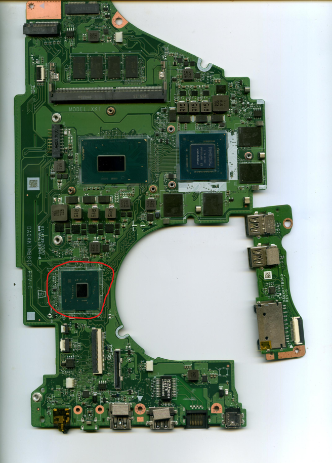

                          Which chipset is heating up during the injection? Is it the CPU / PCH (should be the very large chip under the heatsink)? If yes, then this is a no fix. The PCH is also a consumer of the 3v3 rail for its IO pins.

                            #33
                            Dear mon2,
                            It is not the CPU / PCH under the heatsink. It is the U7 chip on the boardview. Reference of the chip is : C.S FH82HM370 B0 FCBGA874
                            It is the chip circled in red:

                            • mon2
                              • Dec 2019
                              • 14986
                              #34
                              This is the PCH. To us, it would be a no fix. Too many balls onboard unless you feel comfortable to replace this device. The PCH is the host USB controller, etc. to assorted peripherals. Perhaps a transient through the USB port that killed this device.
