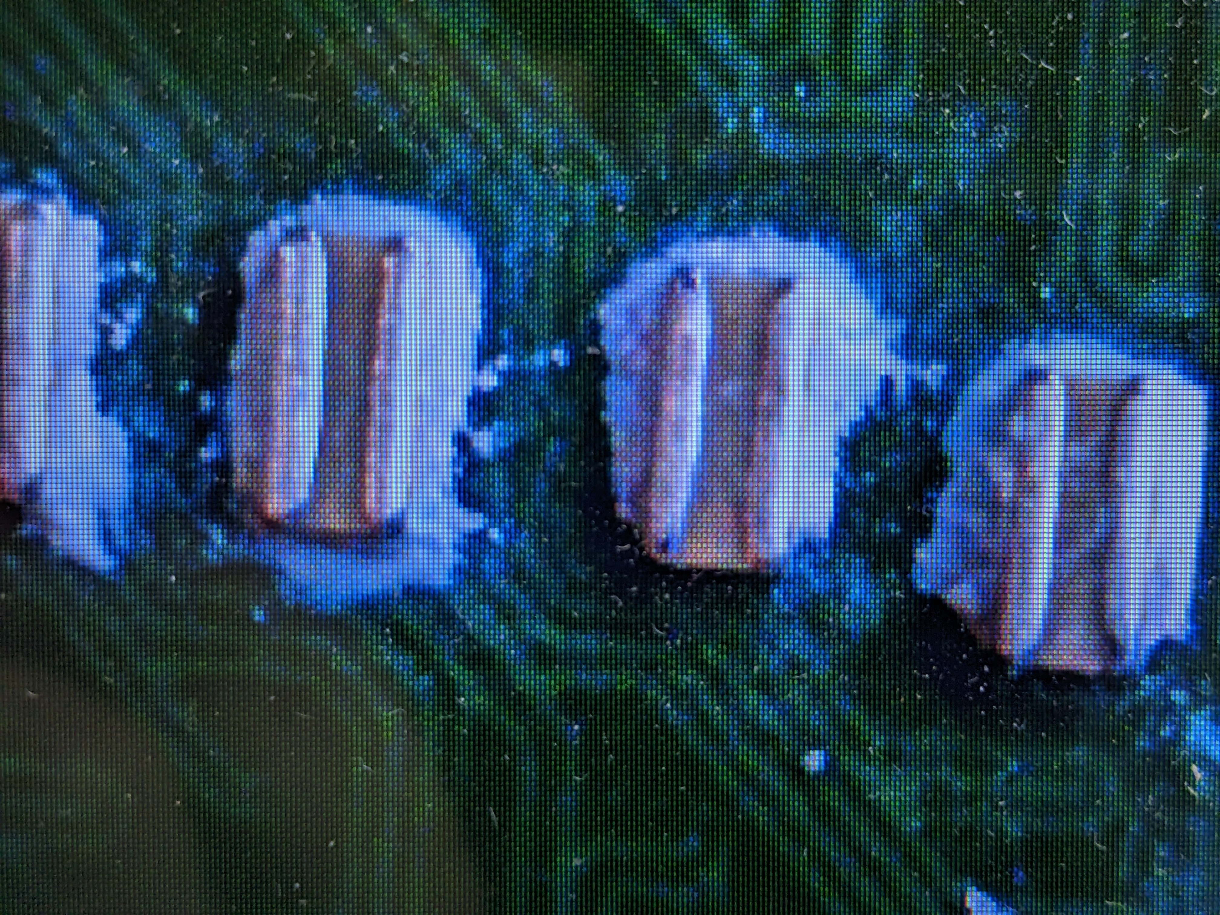

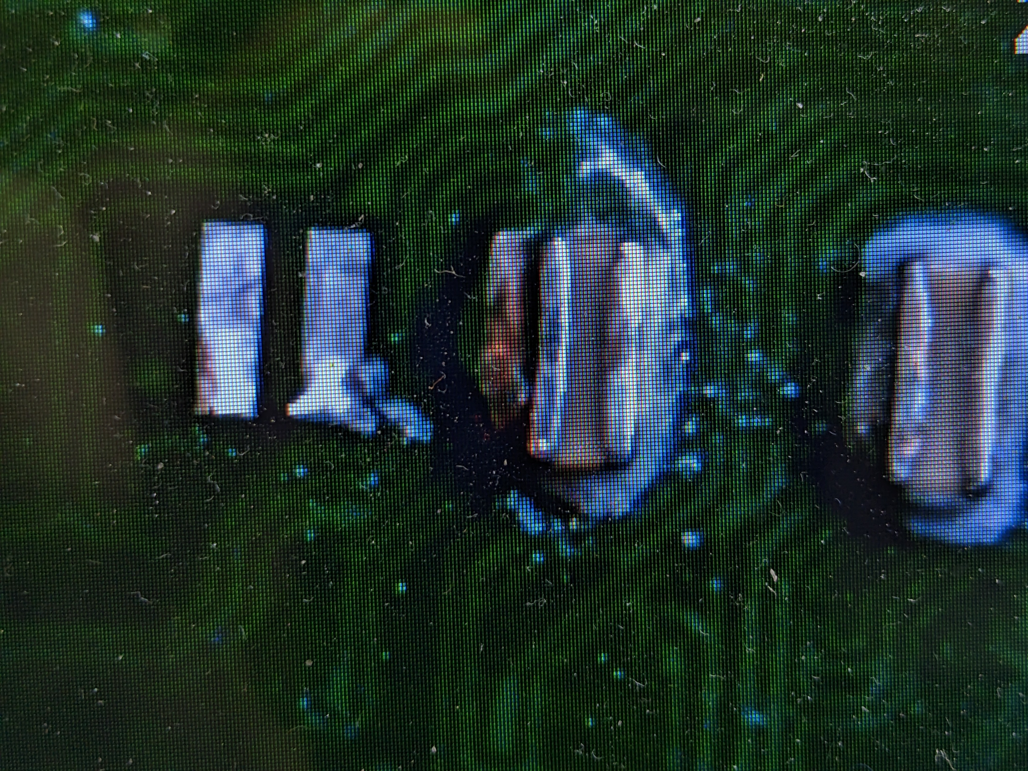

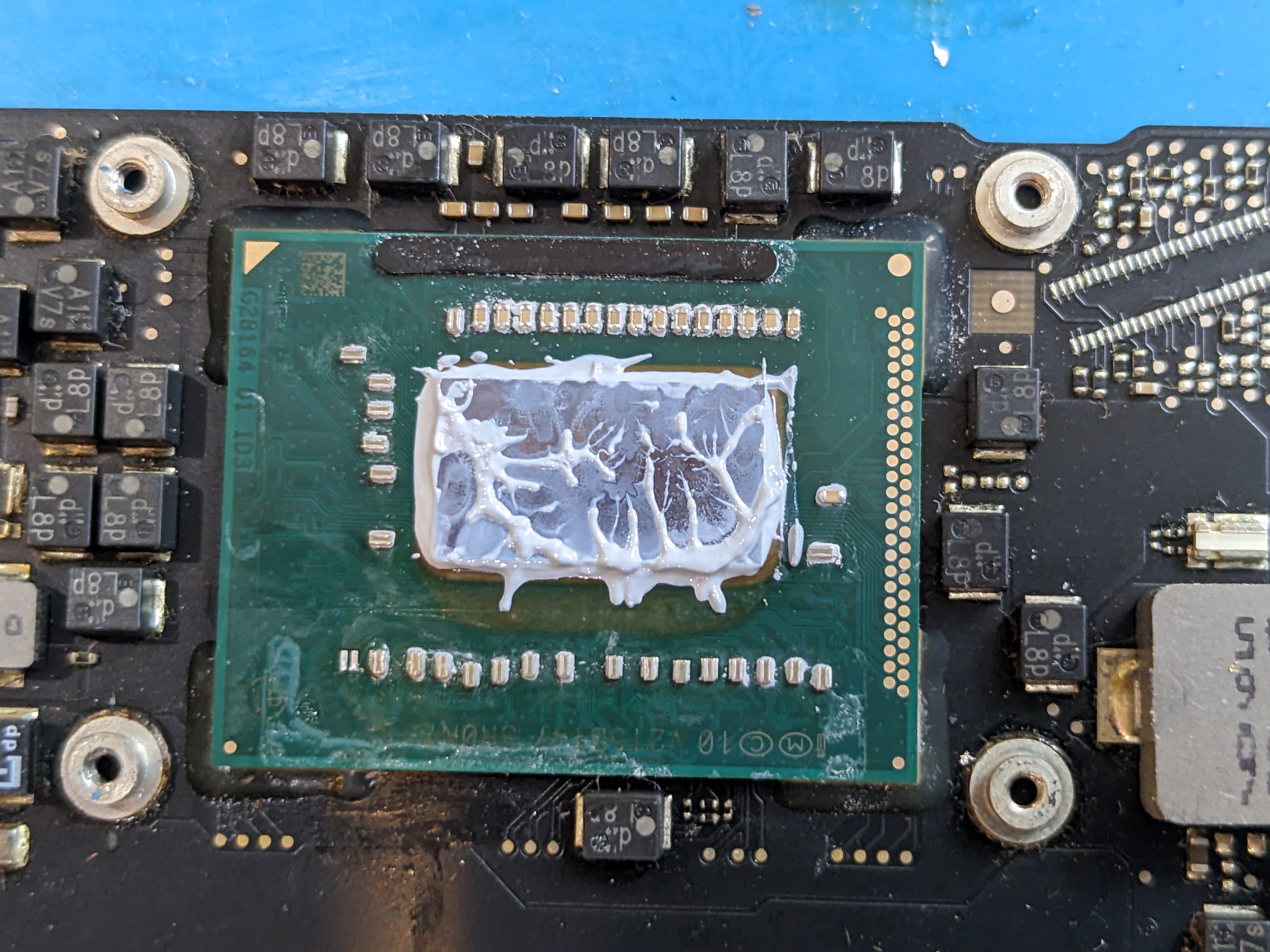

    When I was replacing the opposite side of the PCB, I did not remove the plastic tape on the AP so when it shrinks from heat, it knocked off some component and it is no where to be found.
    One of the component in the AP is missing. It is this weird long component. I think it is a capacitor but I am not sure.
    Anyone know what component is it and what typical value it is on the AP?
    The laptop that I was working on is a MacBook Air 2.

    I removed the one next to it and measured the capacitance and dimenion.
    It is 0.1uF 0510.
    I think it is this one
    https://www.digikey.ca/en/products/d...M030BC/3950819
