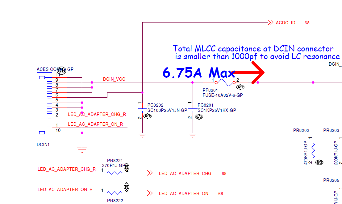

    Share the voltage to ground measurements of:
    acdet
    acok
    regn
    acdrv
    on the charger ic with both the power adapter and battery connected. Be sure the battery is a known good battery.
    also interested in the voltage to ground on each pin of the battery connector with the battery attached while charging.
    Adding to the list - measure the voltage to ground of each pin on the DCIN1 power connector.

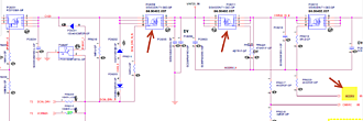

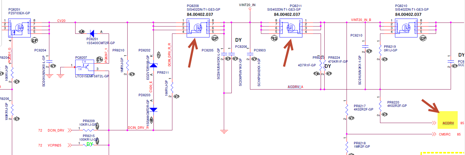

        ACDRV : 20,2V
        This may be textbook case of the battery charger article by piernov.
        Remove all power. See attached.
        Measure the resistance (not diode mode) across the following mosfets:
        source (1-2-3) & drain (5-6-7-8)
        source (1-2-3) & gate (4)
        gate (4) & drain (5-6-7-8)
        Post each measurement for PQ8208, PQ82811 and PQ8210 for now. When the gate voltage is at the same as the source / drain voltage, often this means you have a defective mosfet in the power path. This ACDRV voltage should be a boosted voltage = adapter_voltage + REGN voltage = 19V + 6V = ~25v.
        Suspecting that one of these mosfets is defective but share your measurements. Each should be hundreds of k ohms or higher else the mosfet is a suspect. Then the suggestion is to carefully flux and remove the mosfet and measure again while the mosfet is removed and on your workbench. Are the measurements still low?

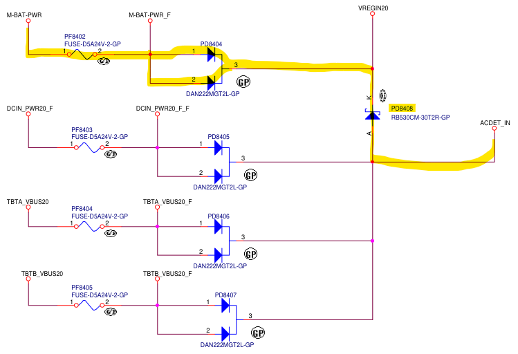

          Boardview here: https://www.badcaps.net/forum/troubl...-lpm-3-19770-1
          Also measure voltage at ACDET on battery only, should be 0V, if not, check PD8408, if it's shorted, battery voltage can leak to ACDET
          Click image for larger version  Name:	acdet 19770-1.png Views:	0 Size:	53.5 KB ID:	3678187

            Heh thank you for help.
            It was bad PQ8211 - was shorted in all ways
            Funny - i have searched for problems on mosfets near battery
            MANY THANKS !!!
            btw because gpu still makes problems - i have found another problematic mosfet PQA406 on DGFXCORE
            Now looks all fine i mean
