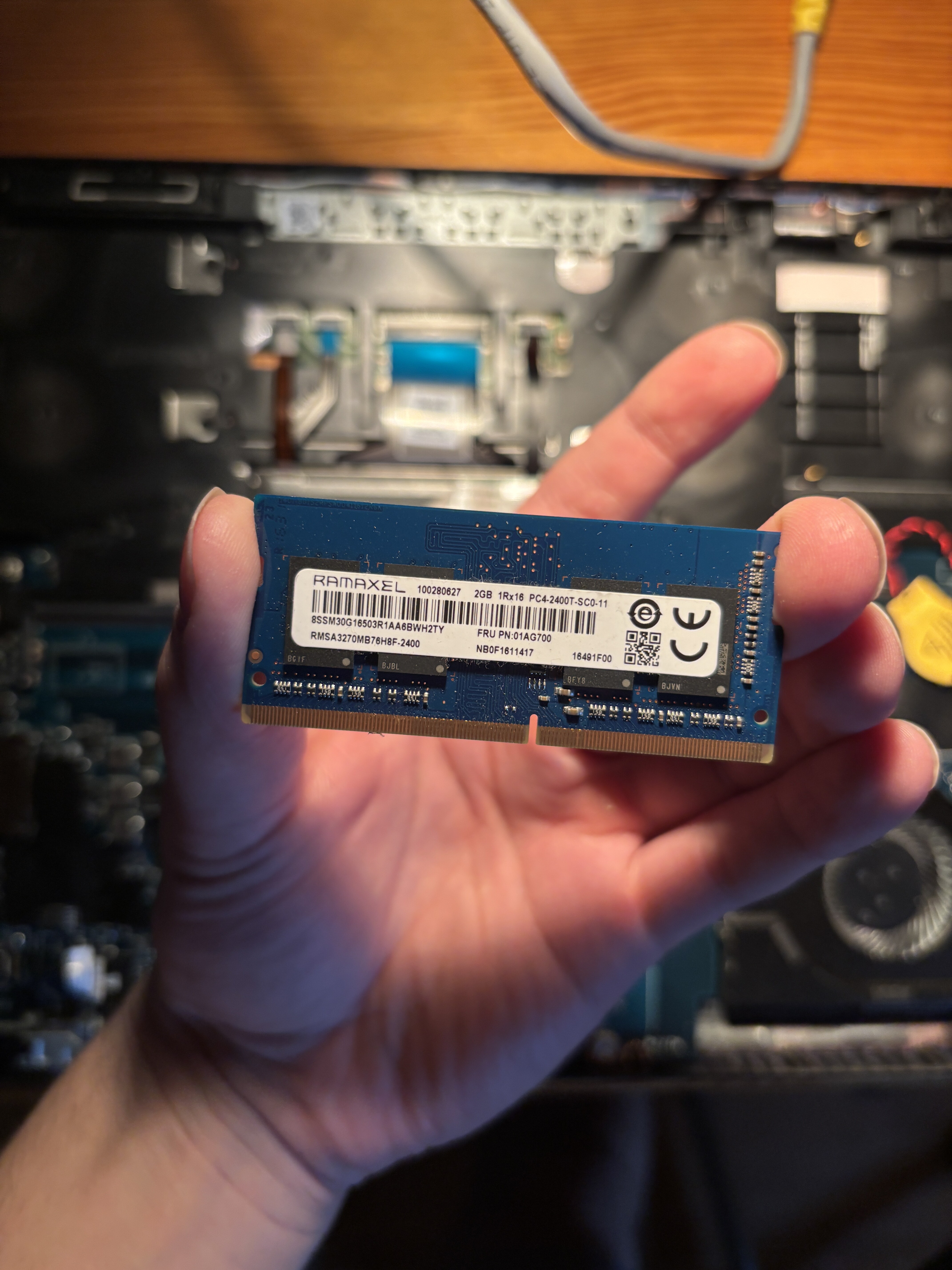

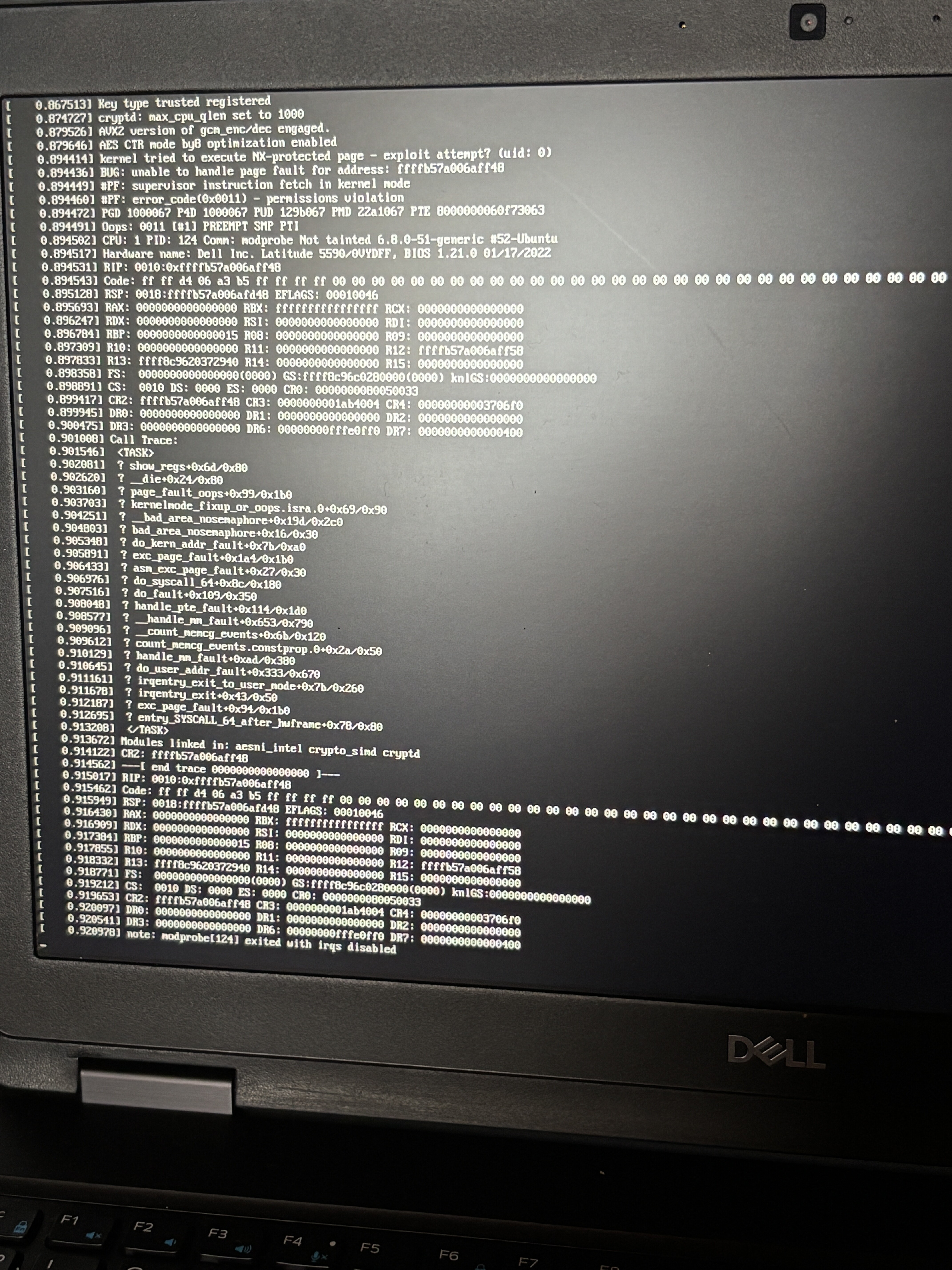

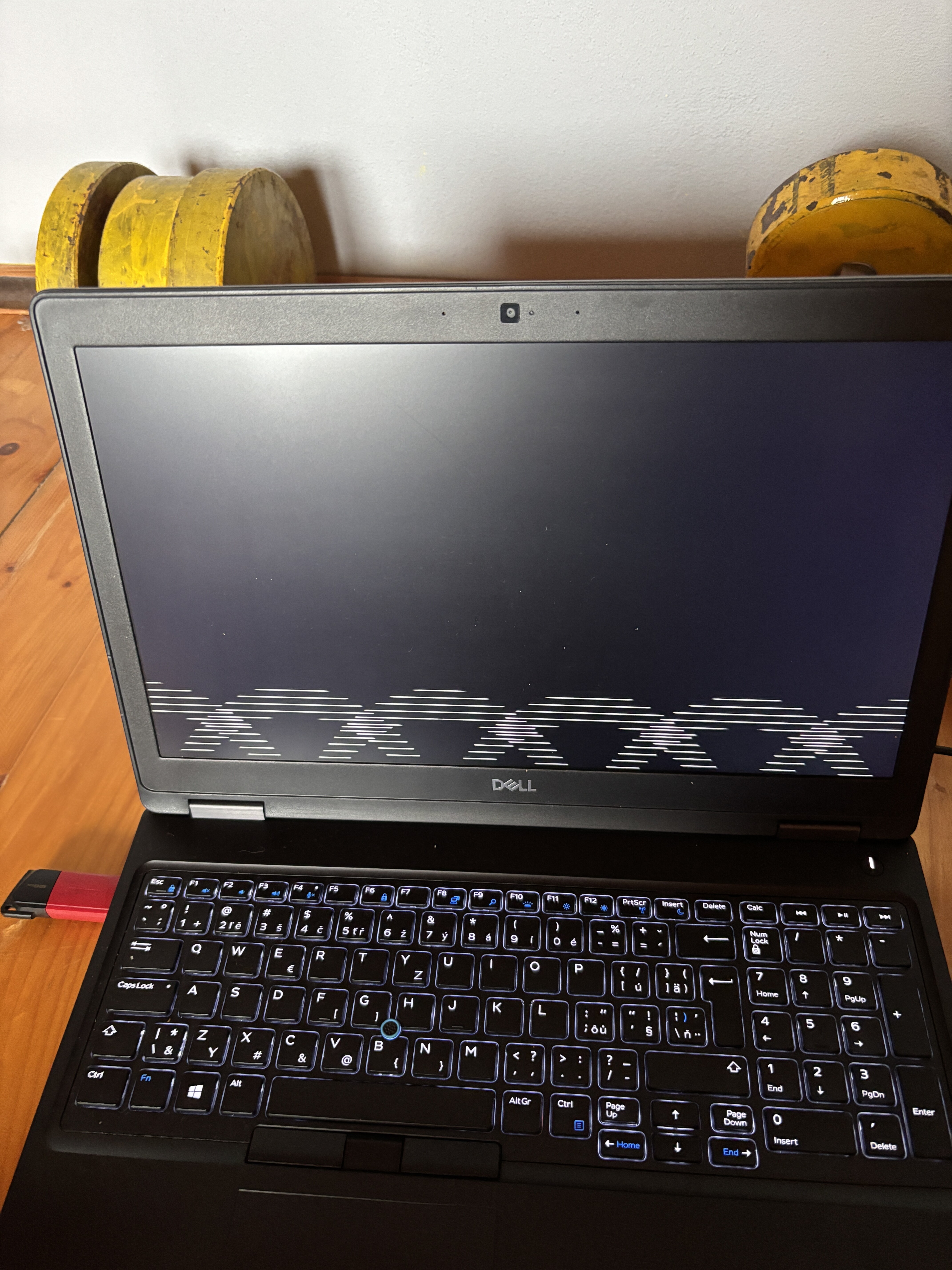

    I got a bare Dell Lattitude 5590 with missing battery, RAM, RTC battery and Storage, I wanted to put some components in it and use it as my home laptop. After adding a FRU 2GB DDR4 2400 SoDIMM RamaxelRAMI've tried booting Linux Mint from USB, I got an error while trying to boot it. I tried reseating the stick, different slot, didn't help.

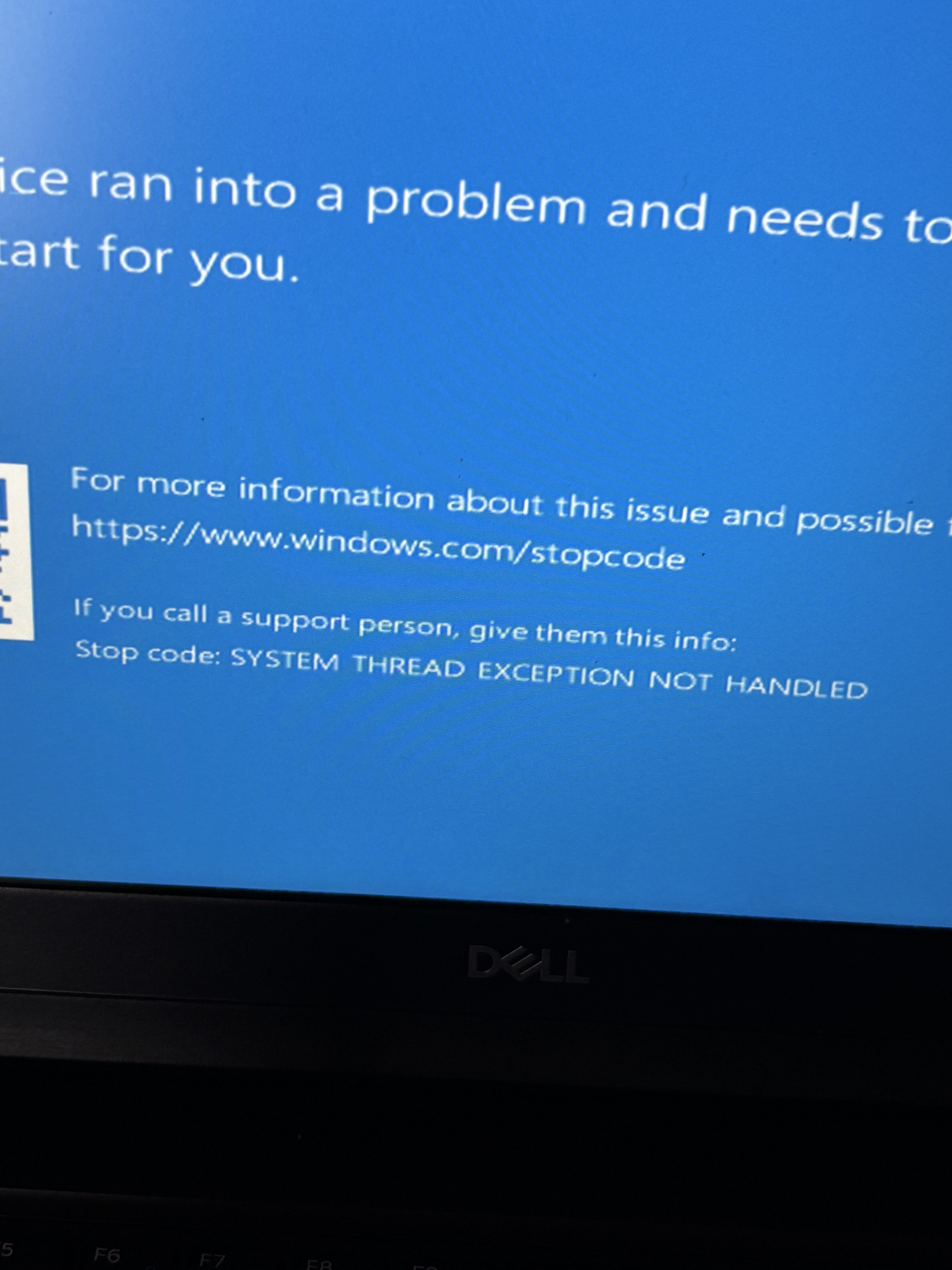

    I tried to boot Windows 10 installer, as that was the stock system my model came with, got a BSOD as soon as the installer started booting, different code every time. I've tried switching to AHCI mode, I've tried linux in legacy mode, I've tried compatibility mode, didn't work.

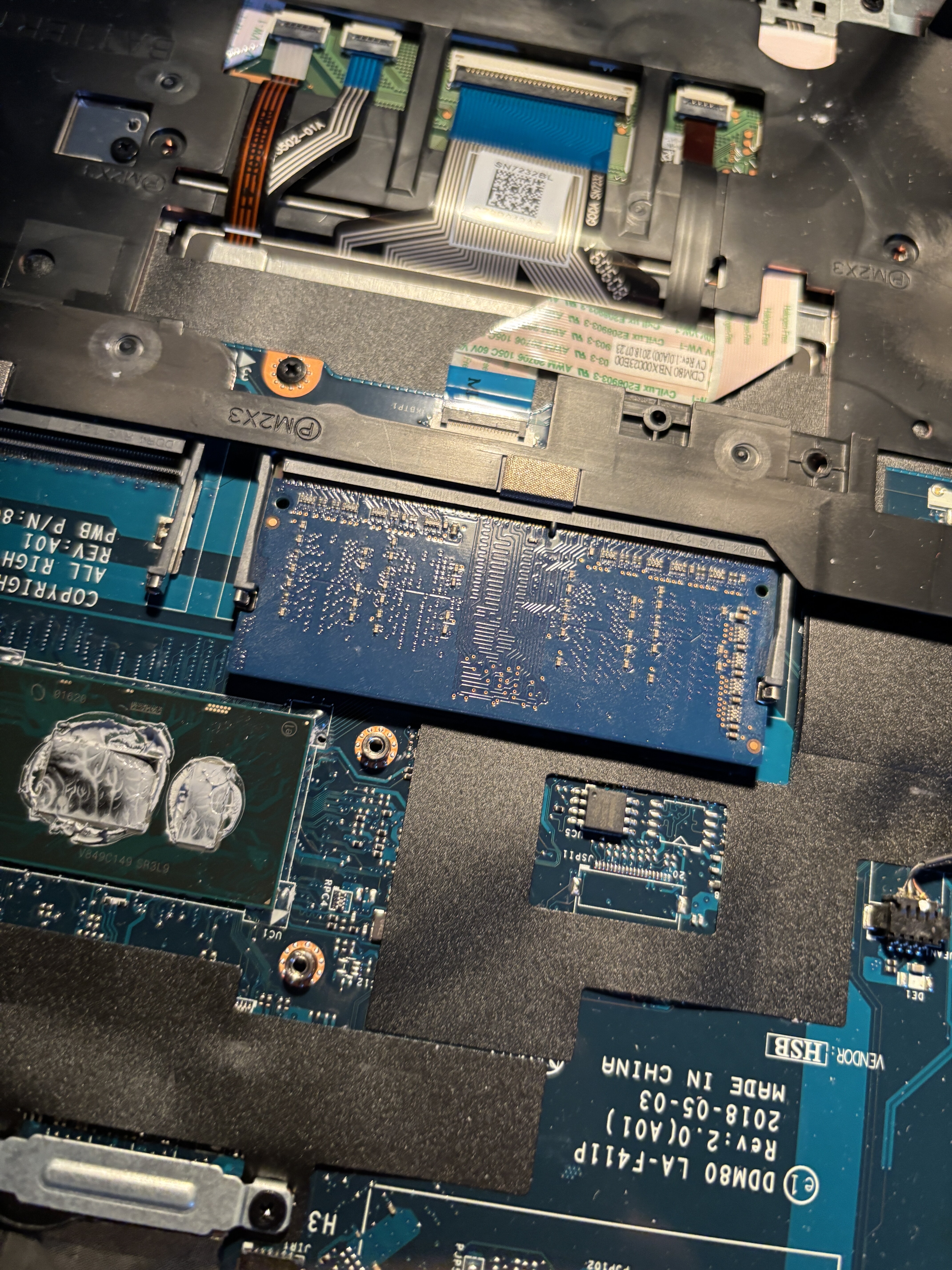

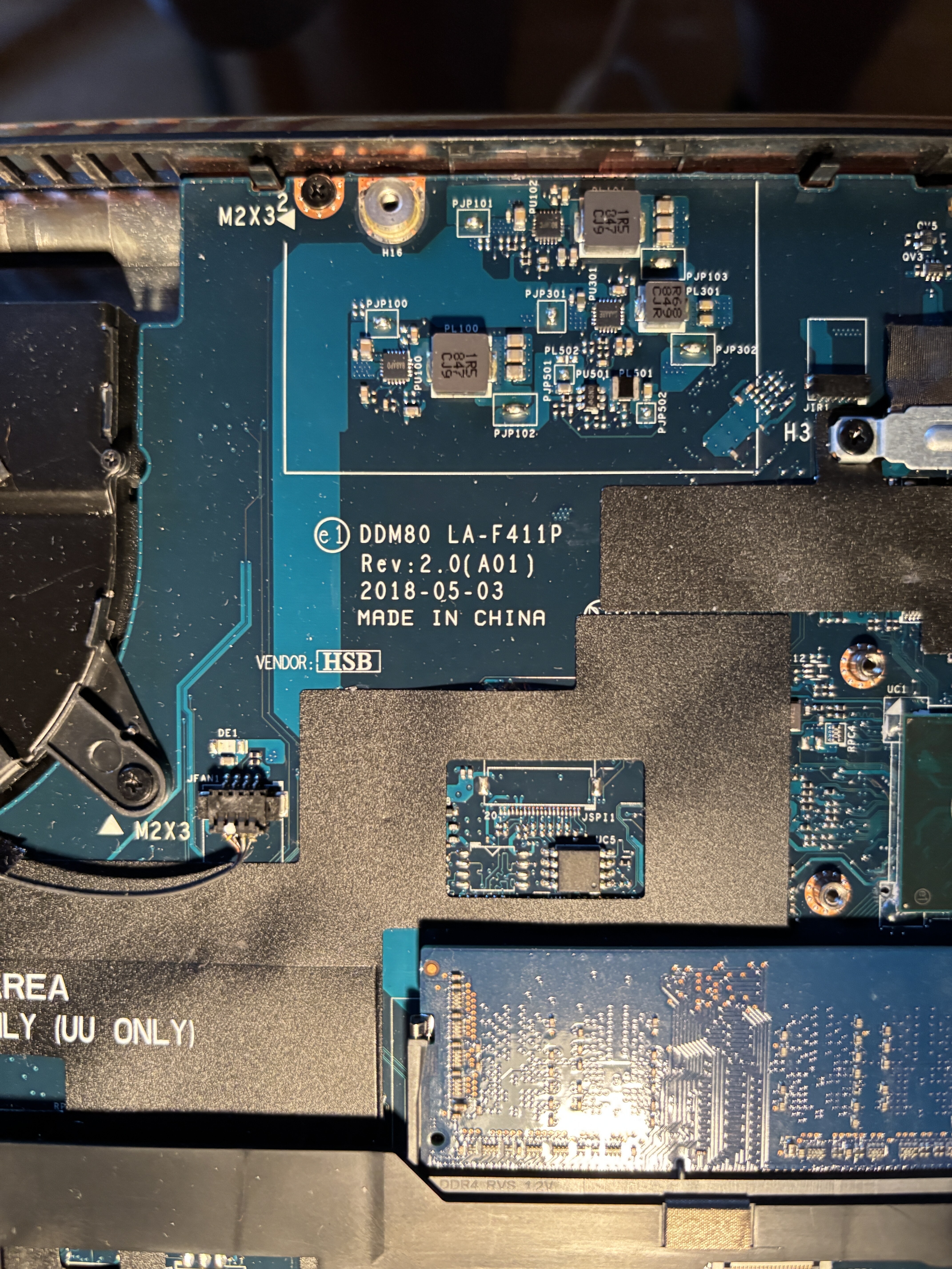

    Motherboard:
    LA-F111P
    RAM:
    CPU:
    Intel Core i5-8350U Quad Core 1,7GHz
    I attached the errors I was able to capture and motherboard model/ ram model
    SYSTEM_THREAD_EXCEPTION_NOT HANDLED - FLTMGR.SYS
    KERNEL_SECURITY_CHECK_FAILURE while booting to Dell restore drive
    SYSTEM_SERVICE_EXCEPTION
    Thank you for any help/advice. I want this laptop as my repair project and I hope it's fixable

    Hi, try with a different RAM stick (4GB or more), 2GB is too low nowadays for modern OS, even if you manage to install it, it will be very slow
    A single stick of 8GB DDR4 SODIMM laptop RAM, either 2666 or 3200, is very cheap nowadays, about 16eur, get one from a well known brand like Crucial, Kingston, Corsair, Teamgroup, Lexar, etc.

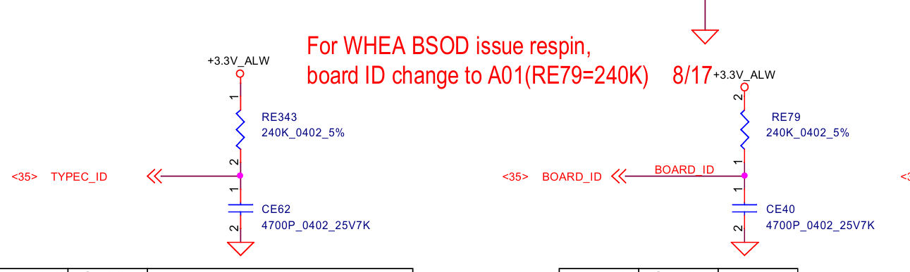

        I found schematics for the mainboard, I was just reading it, I have no clue what I'm looking at besides which component is what, but on the page 36 i found something about BSOD. Could it be somehow tied to the issue or it means something totally different? I attached the screenshot.
        EDIT: I also tried connecting an HDD with windows already installed, still BSOD after going through the DELL logo with windows spinning wheel under it. Only thing that's left for me to try is getting an M2 ssd or finding an cable for connecting an HDD straight to the motherboard. I tried replacing the RTC battery too.

            Memtest from linux mint worked, but after trying to create a bootable usb from your link, I get stuck at Retrieving CPU MSR data. I've read that it could be a faulty stick, but is it possible that it's a CPU issue as it says?
            I'll attach the memtest86 logs.
            Thank you.

              Okay I got my new memory, I tried switching it didn't help, but I found out the culprit.
              After thinking about motherboard repair, bios reflash, cpu replacement, everything guess what it was
              Intel® SpeedStep™
              I only booted into linux mint but I hope windows will work now too, if it doesn't I'll add an edit.
              Thank you everyone for your advice.
