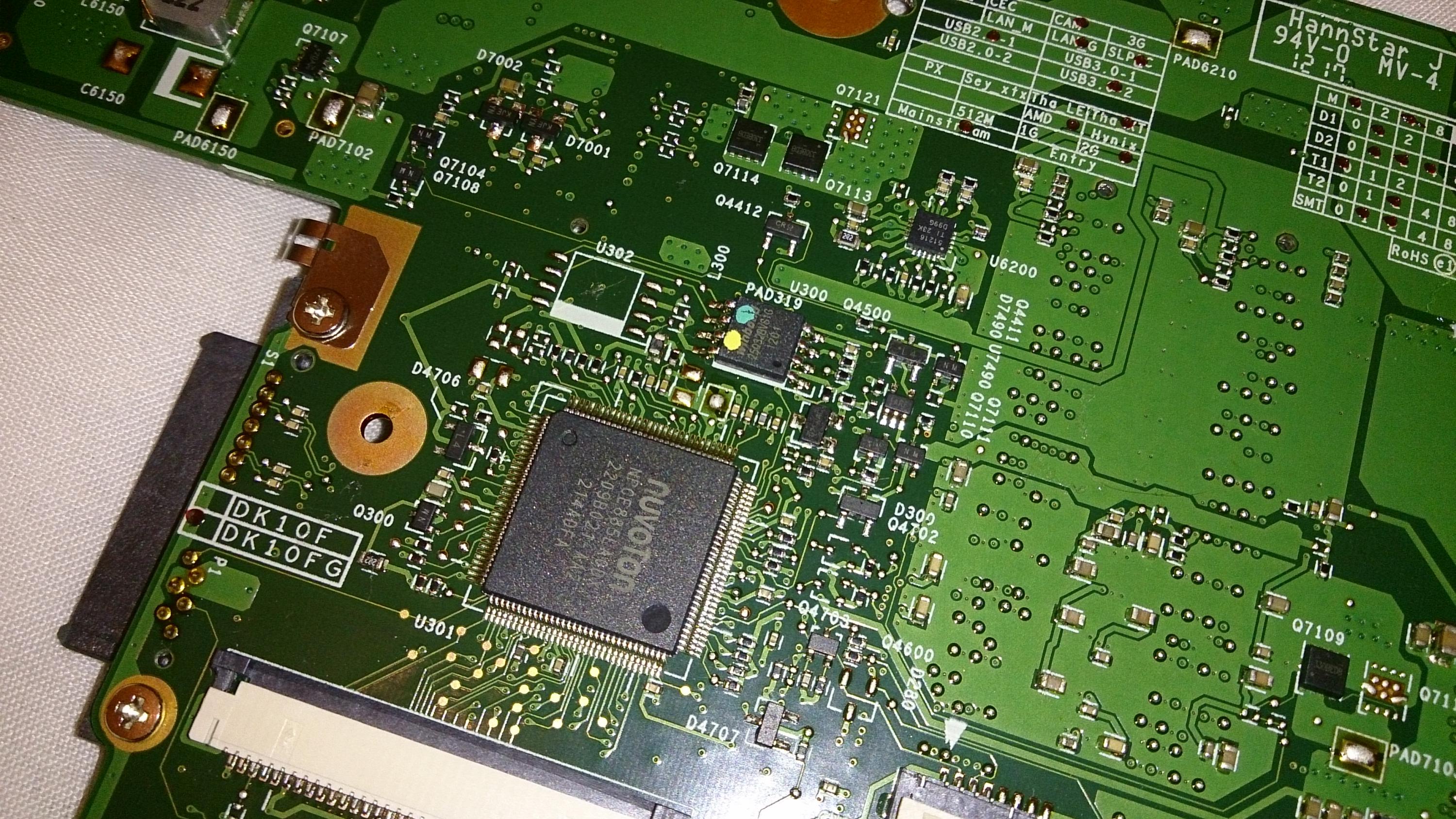

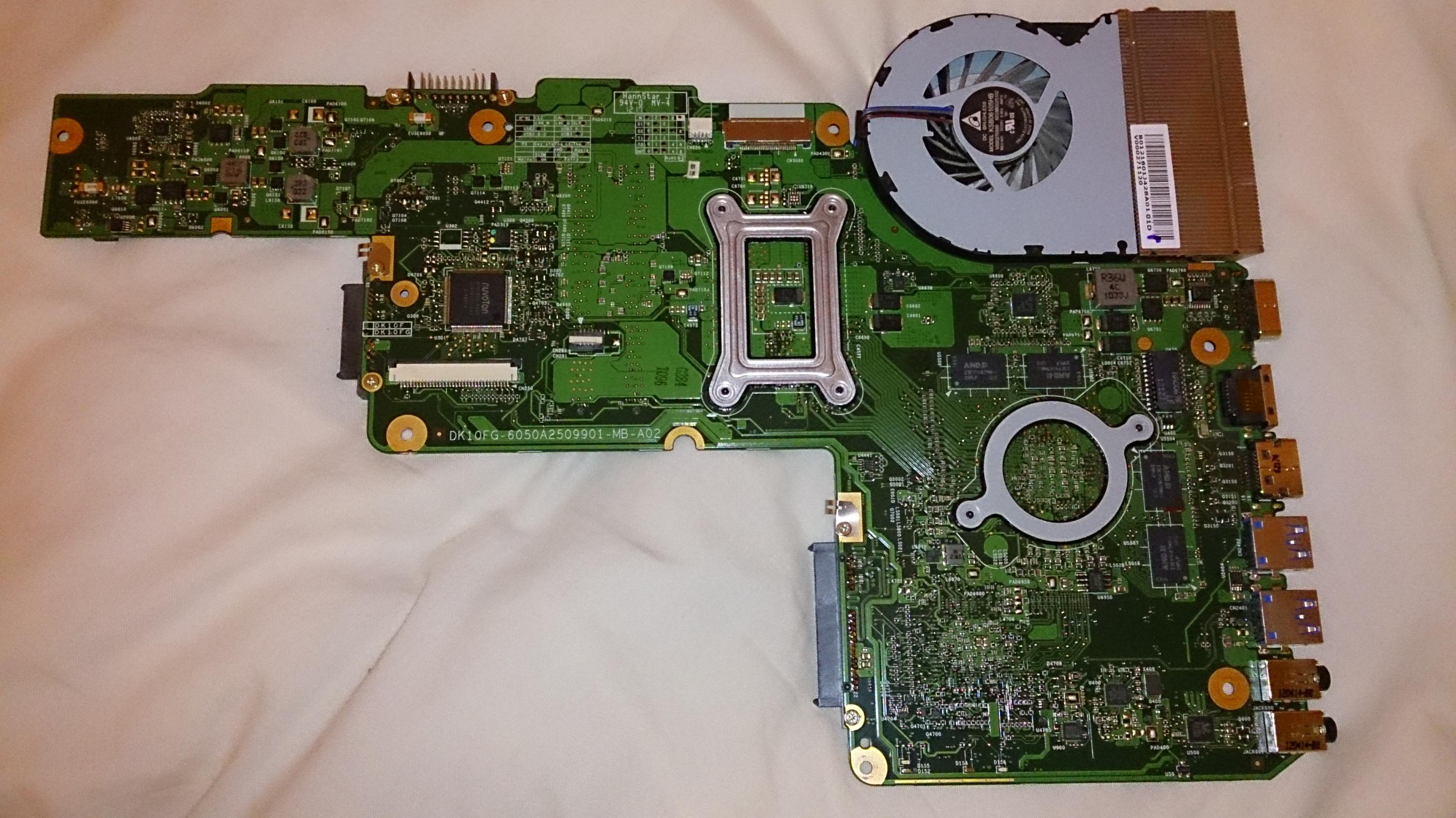

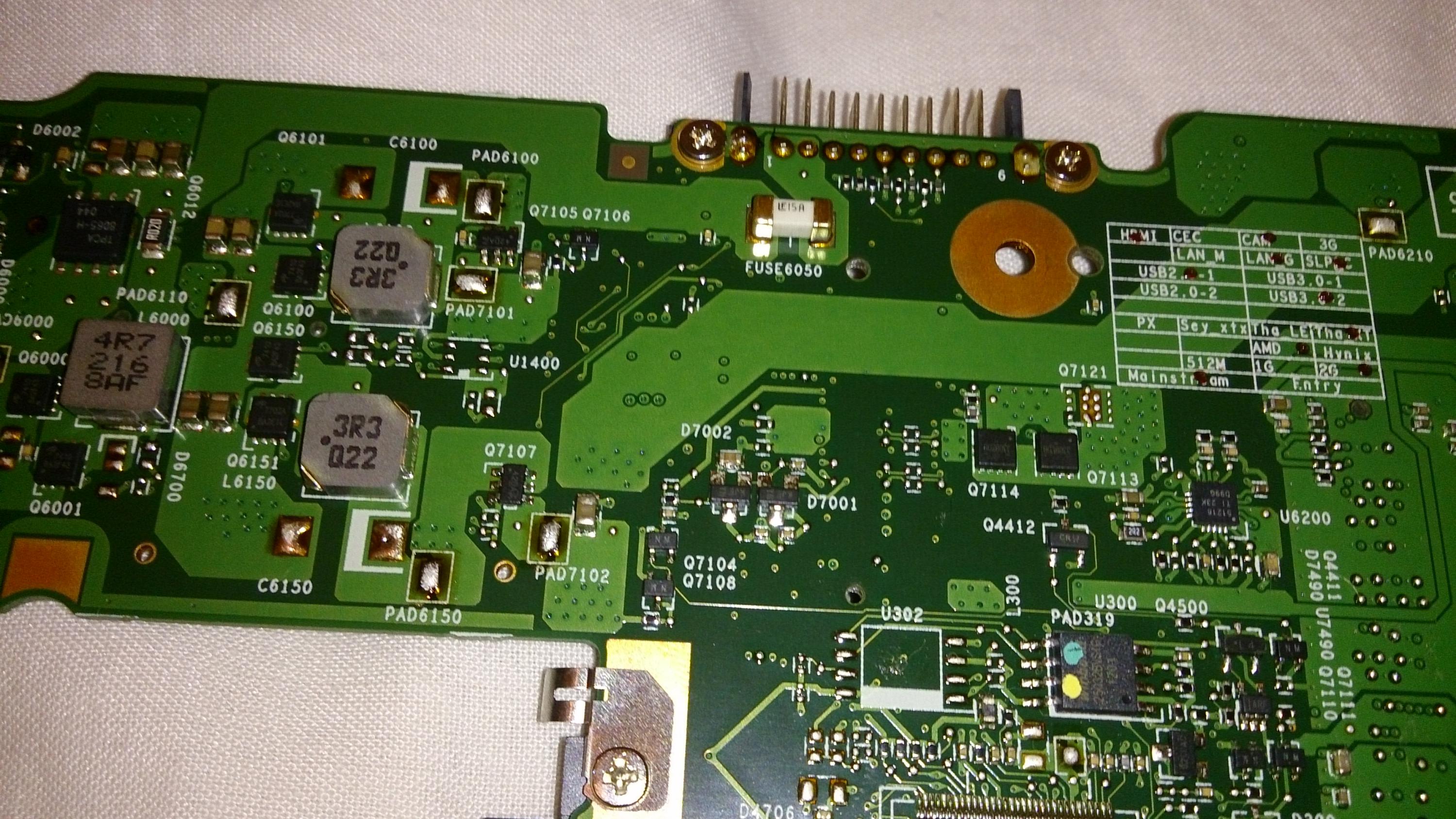

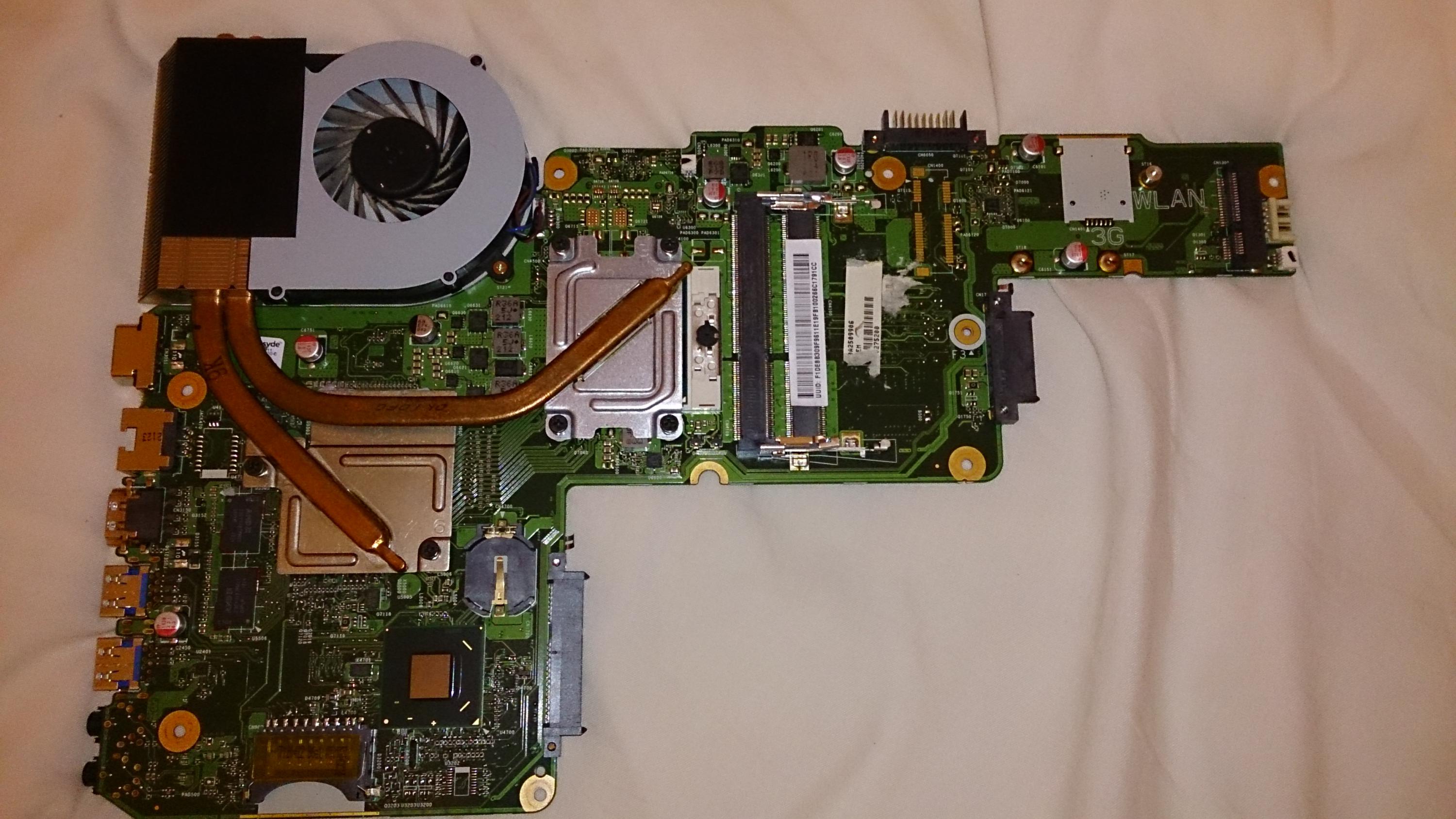

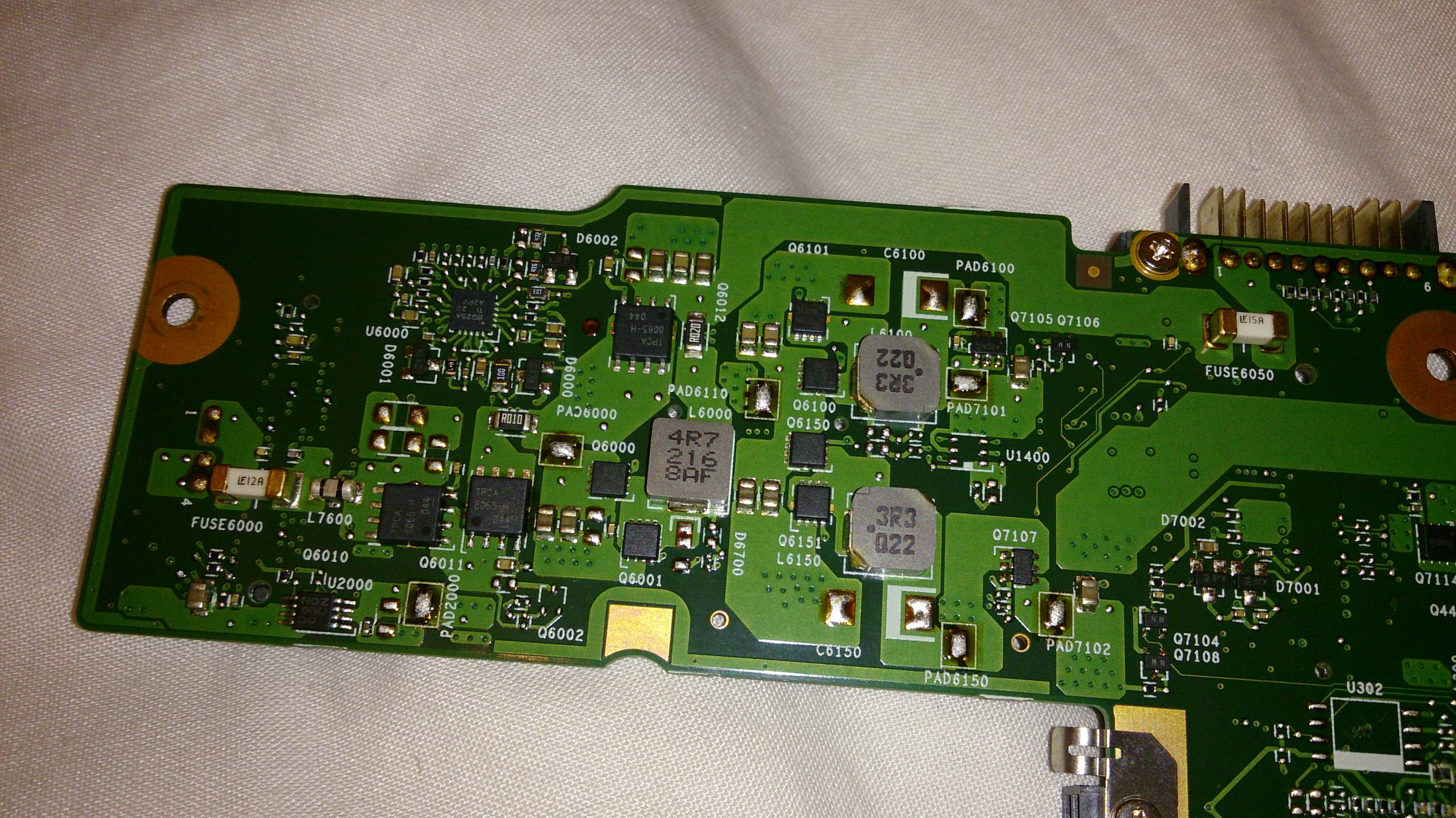

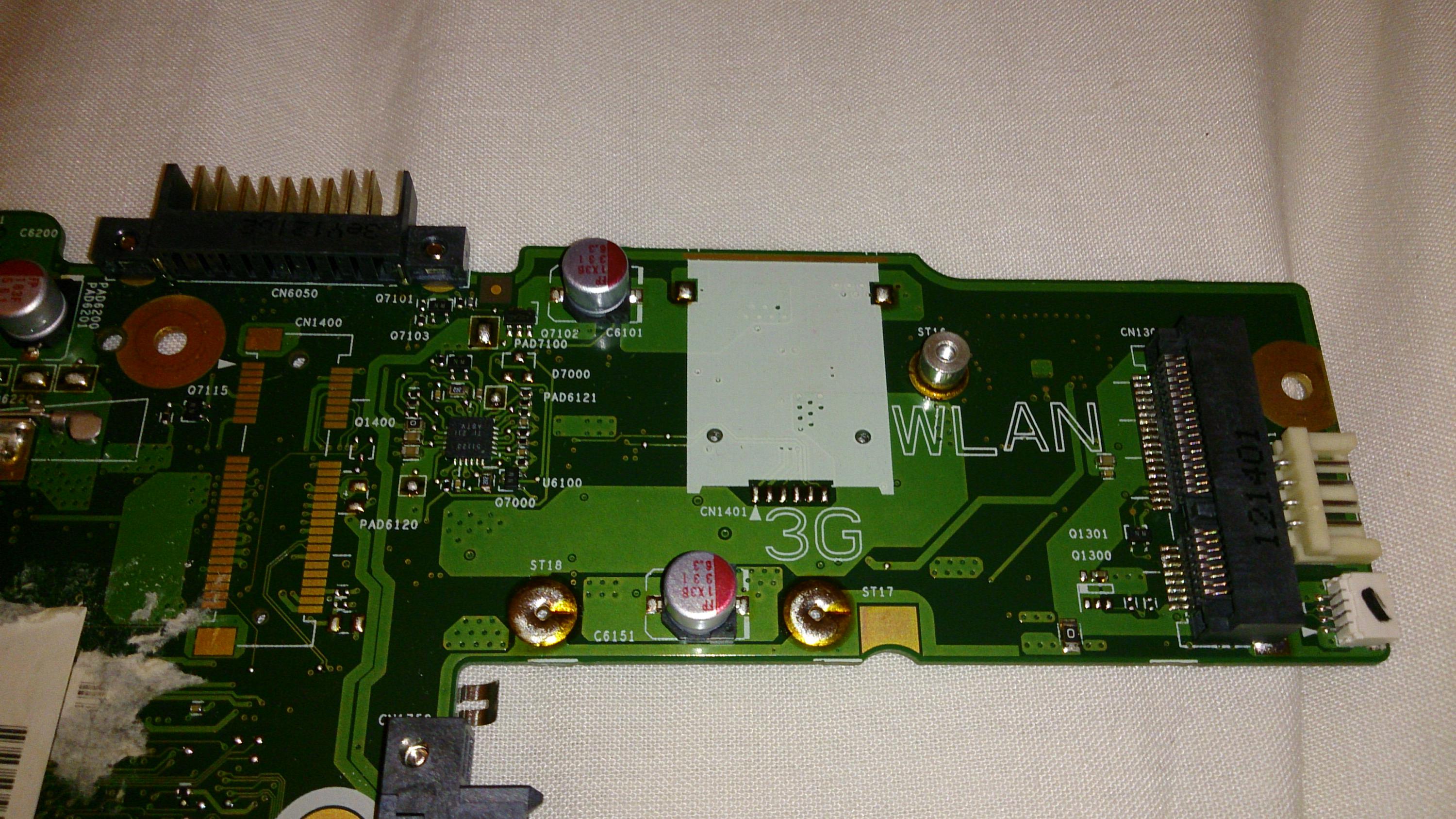

      Re: Toshiba L855-10P Totally Dead
      Hello again!
      The reason I stated the BIOS chip is because it has the same chip as the last laptop you helped me with (still working fine by the way!) and it had exactly the same symptoms. I don't think he tried to flash the BIOS here though.
      I have attached some pictures, I have tested voltages across Q6010, Q6011 and Q6012, I think these are mosfets to do with the power input (TPCA 8065-H), I think 1 of them had 19V and 2 had 3V.. I can't remember if that is correct though. I think U6000 is the chip that controls the power input.
      Thanks!
      Graham
        I will suggest not to continue but I guess you want!
        reason why not ,in the first and second pic. you can see the solder released the flux from it.
        so uber preheated or the ... my old friend OVEN.
        the chase for the oven came bigger when I saw it had a video chip dedicated.
        p.s. I was talking about QFN chips find the models and lets find the charging circuit first.

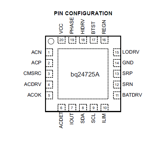

            ok!
            lets do this
            the QFN chip that u6000(I attach a pic)
            write down the values and post it; left to right.
            • grahamw01
              • Jan 2013
              • 256
              hello!
              Here are the voltages for each pin, the only pin i cant test is 18
              1. 7 - 7.5
              2. 7 - 7.5
              3. 7 - 7.5
              4. 7 - 7.5
              5. 0
              6. 2.685
              7. 0
              8. 0
              9. 0
              10. 0
              11. 3.1
              12. 3.1
              13. 3.1
              14. 0
              15. 0
              16. 6
              17. 5.85
              18. -
              19. 3.1
              20. 19.05
              Pins 1-4 cycled between 7V and 7.5V and the rest stayed at the numbers above.
              Also FUSE6050 (for battery) is 3.1V if it helps..
              Graham
                something its wrong there on those first 4 pins
                find the fets from the jack maybe we can see where is coming from
                      Hi everyone, thanks for your comments, the 3 mosfets i can see are below with resistances to ground;
                      Q6010: pins 1-3; 0.58kOhm. pin 4; 0.69kOhm. pins 5-8; 22.7kOhm.
                      Q6011: pins 1-3; 0.58kOhm. pin 4; 0.69kOhm. pins 5-8; 0.58kOhm.
                      Q6012: pins 1-3; 5MOhm. pin 4; 15MOhm. pins 5-8; 0.58kOhm
                      thanks!

                          BQ24725 should pull ACOK high when pin 6 is 2.68V, i think you need to chenge the BQ24725
                              one thing before changing that QFN chip , charge the battery somewhere and see if it works with only battery!
                                  If possible do so.
                                  QFN is the most likely failed component. Can't be 100% sure.
                                      wow guys, managed to charge the battery a bit on my ancient Toshiba L350, good job I kept it all these years! The laptop works fine off the battery!! So what does this mean?
                                      atsio - I don't know the pin numbers but;
                                      D6000 top left; flickers between 6.9V and 7.5V. top right; 19.35V. middle bottom; 19.09V
                                      D6002 top left; flickers between 6.9V and 7.8V. top right; 2.69V. middle bottom; flickers between 7.5V and 8.5V.
                                      thanks!
