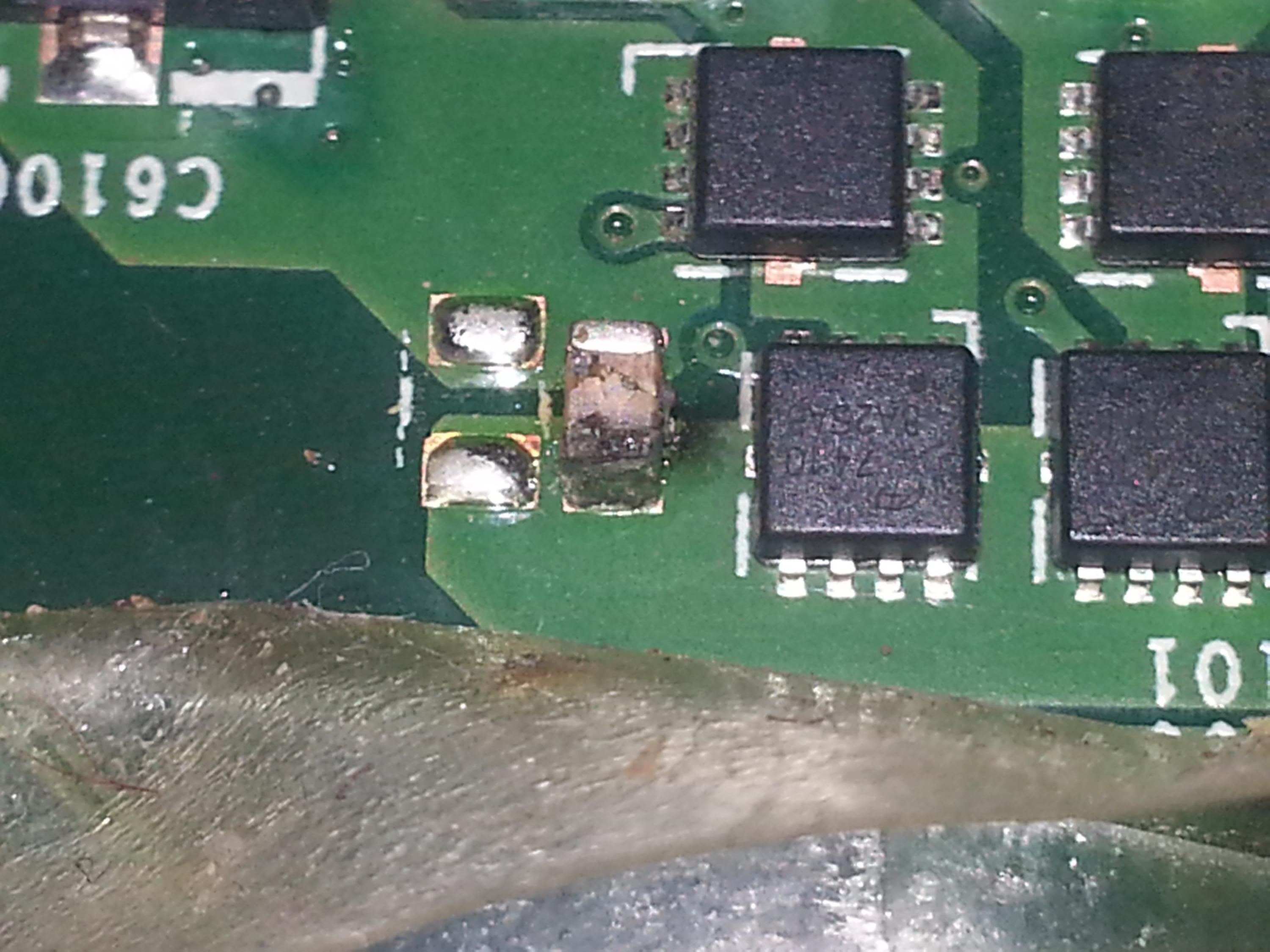

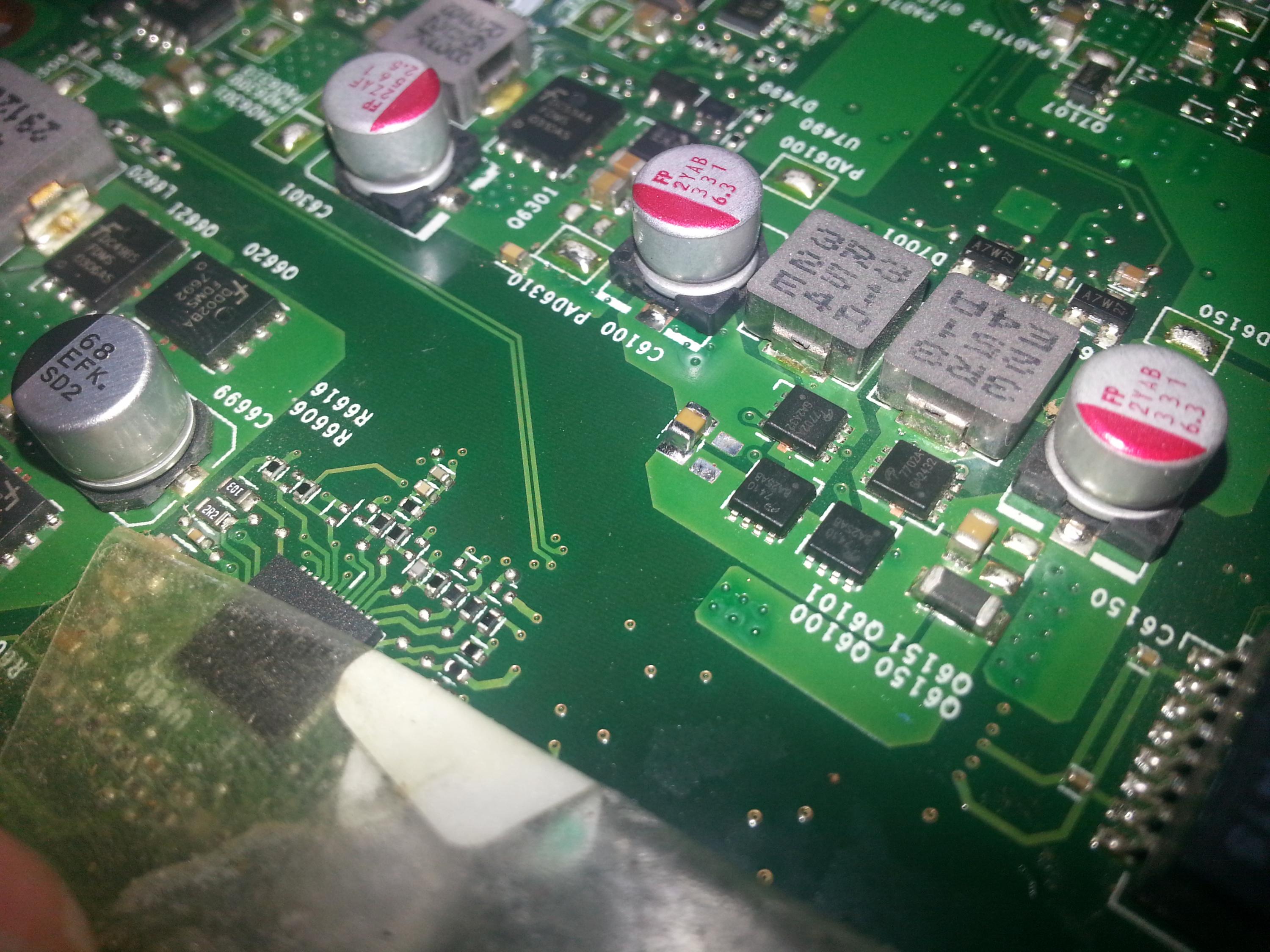

                                          I want to share the solution that worked for me...
                                          Received a Toshiba Satellite L855, motherboard DK10F with same problem:
                                          -> SYMPTOM <-
                                          Totally dead
                                          -> PROBLEM <-
                                          Only 1.2V at ACDET (pin 6 of U6000 BQ24725) -> Normally near 2.7V
                                          -> CAUSE <-
                                          Voltage drop on ACDET caused by the PVBAT rail shorted to ground
                                          -> SOLUTION <-
                                          Using variable or lab power supply feed the PVBAT rail increasing the current or voltage (do not exceed 19V), until the component causing the short becomes hot, in my case the failed component was the ceramic capacitor C6110 (or C6111), near Q6100, rated at 4.7uF 25V
                                          -> NOTE <-
                                          Also discovered FUSE6050 15A open, replaced it too
