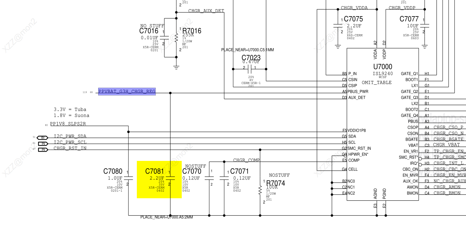

    Hi everyone.
    I have a MacBook Pro 15" A1990 touchbar with (I believe) a dedicated Vaga GPU. The exact Boardview and schematics doesn't seem to exist but I've been using the one for 820-01814 so far.
    The MacBook doesn't turn on, stuck at 5v and drawing only 0.19A.
    All 4 USB Cs ports behave exactly the same.
    There's no PPBUS G3H available.
    The resistance to ground from PPBUS G3H is 0.4 ohm. I have found the same resistance to PPBUS G3H from two coils near cpu/gpu area.
    Since the boardview I have is different exactly in this area, I'm only guessing the two coils to be LA650 & LA640.
    Should I assume the board brain dead at this point. Problem is I have no doner board if I need to replace any mosfets for the area.

    Based on the above, very few parts left that could potentially be the fault.
    Carefully, flux and remove C7081. Do not lose the part. They are cheap to source if lost.
    Click image for larger version  Name:	C7081.png Views:	0 Size:	192.6 KB ID:	3643098

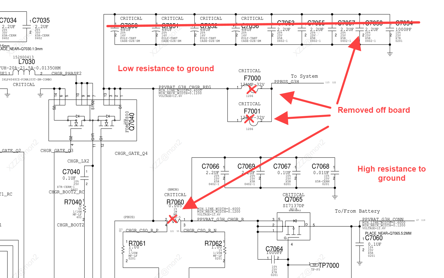

      I think my initial assumptions are not correct at all.
      I removed the F7000 and F7001 fuses and now the resistance to ground from the PPBUS G3H pad of the fuse is in K ohms and rising. From the other pad of the fuse (PPVBAT_G3H_CHGR_REG) I have 0.2 to 0.4 ohms resistance to ground. Does this mean the short is on this side? Should I inject 1V 1A to this pad?
      Could the issue be U7000 (Isl9240)?

            Remove all power. Meter in resistance mode.
            What is the resistance to ground in ohms @ L7030 (either side is ok)?
            Suspecting that there is a shorted capacitor in either the group of caps mated to the D1 of Q7040 or in the group of caps @ C7066-C7069.
            If you are comfortable, flux and carefully remove the current sense resistor @ R7060. Doing so will isolate the cap groups. Then test again the resistance to ground of the PPVBAT_G3H_CHGR_REG rail.
            Respectively, test the resistance to ground of C7066. If the short remains, suggest to carefully flux and remove each cap starting with C7050 (flux and lift up one leg to remove the part from the rail). Bulk tantalum caps are common points of failures. We do not use them at all in our product designs and have devices running 24/7 for years and years and still working.

              Thanks mon2.
              Resistance to ground @ L7030: 35 k ohm
              Ok I removed the R7060 current sensor now. PPVBAT_G3H_CHGR_REG's resistance to ground hasn't changed. I have 0.2 to 0.4 ohms again.
              Resistance to ground of C7066 is in Mega ohms.
              Probably a very stupid question but I need to learn and confirm anyways : D
              Before taking out the current sensor, on continuity mode of my multimeter, both C7066-C7069 were beeping non stop. After the sensor is removed, they no longer beep continuously. Does this also confirm the short is no longer from this side? Because on the other side, all C7050 series are still beeping non stop.
              Is there another way to get a sense of which cap to start removing first?

                Correct on your understanding. Since you have removed the current sense resistor, the C7066-C7069 bank of parts are no longer mated with the shorted part. This confirms that C7066-C7069 are not suspects.
                There are not too many caps in the remaining cluster of caps. We are assuming that one of the caps is guilty so you will just have to patiently flux and lift up one leg of each cap till you (hopefully) locate the shorted capacitor. Essentially, you are plucking parts from the shorted rail in hopes of finding the bad one.
                Another method which we have not yet used is to purchase a milli-ohm multimeter. They are available for $50-$100 (estimated). Using this meter, you can test each cap while it sits on your board. The part with the lowest resistance is the guilty one. Amazon and Aliexpress offer these tools and is on my wish list to buy.

                  Well I pulled one leg on each and every one of these bastards and I still have a short. C7054 was a tiny nightmare that I had to use the heatgun for!
                  Click image for larger version  Name:	image.png Views:	0 Size:	6.9 KB ID:	3643077
                  PPVBAT_G3H_CHGR_REG's resiatnce to ground is still 0.4 ohm.

                    Can you confirm we are as per the attached diagram on this repair?

                      That's the exact current situation mon2 👌
                        • ahoonid
                          CapsLOCK
                          • Jun 2023
                          • 52
                          Done. No longer continuous beep. Resistance to ground is OL now! Was that the issue!?
                          • mon2
                            • Dec 2019
                            • 14673
                            Yes sir. Must have been an in-rush current and was too much for this wimpy capacitor.
