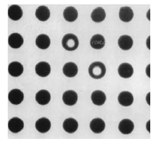

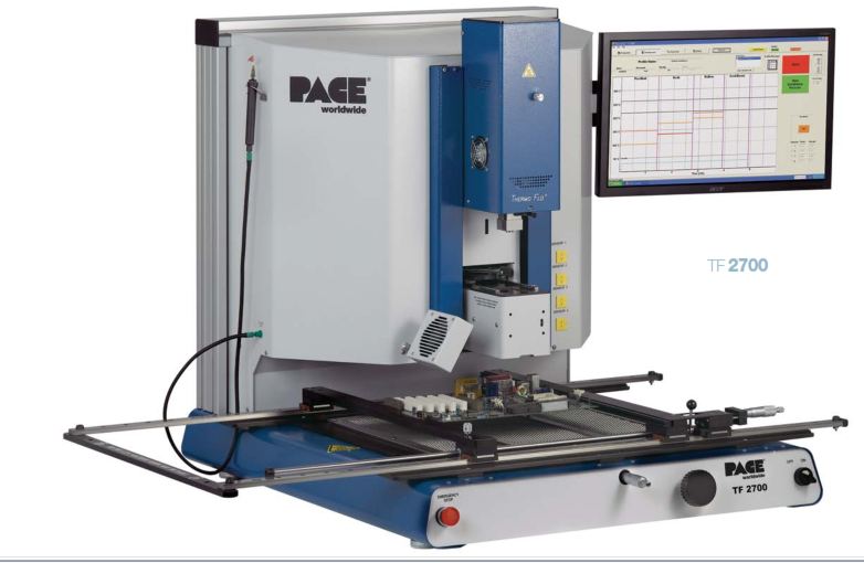

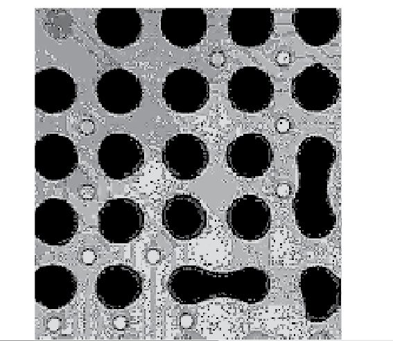

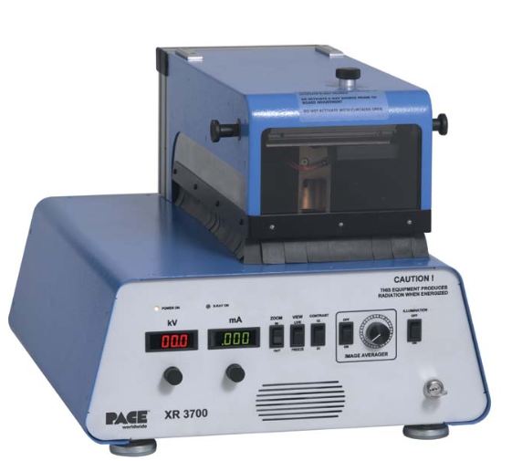

                  when you got right tools ,discussion don't take place

                    Had 3 DV6 coming this year all with GPU problems, but will try also to reball the NB (or better change them both).
                    I'll check more deeply the MB after a short vacation on which I am currently .
                    But looking at these tools you think if I had them that I would be here on forums asking for help (mostly because you would be deep in the business and had a lot of exp) .
                    Lets get back to real life and my cheap multi meter :P.

                        Oh man i wanna this machine sooooooooooo much

                          I am in the same boat, sadly my budget isn't quite for that :P. Anyway is there any "cheap" solution like this?
                          • ktmmotocross
                            Boardkiller
                            • Feb 2014
                            • 3575
                            • slovakia
                            Re: HP pavilion DV6
                            Only if u have on stock some RADAWAY or RAD-X/fallout/
