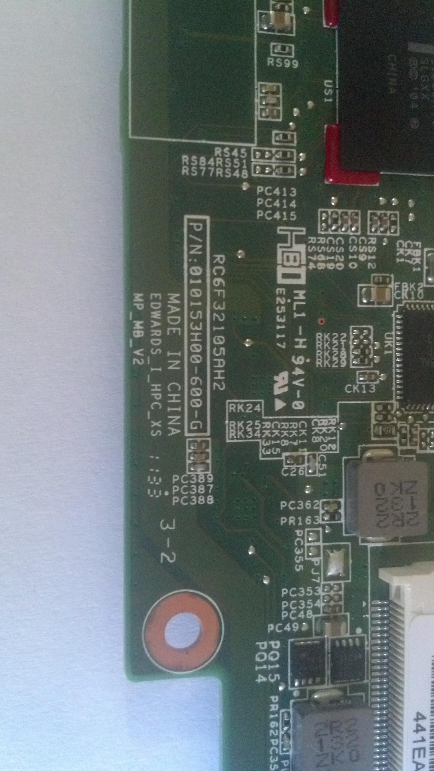

    Hello guys, I got HP mini here which I cannot confirm model. Upon researching it seems to be an HP mini 210 but I need to confirm this. There's no model on laptop or I might be misreading it. Problem is no light from dc jack. Might be bios. If someone have schematic and bios file please share. Thanks very much
    Check images.

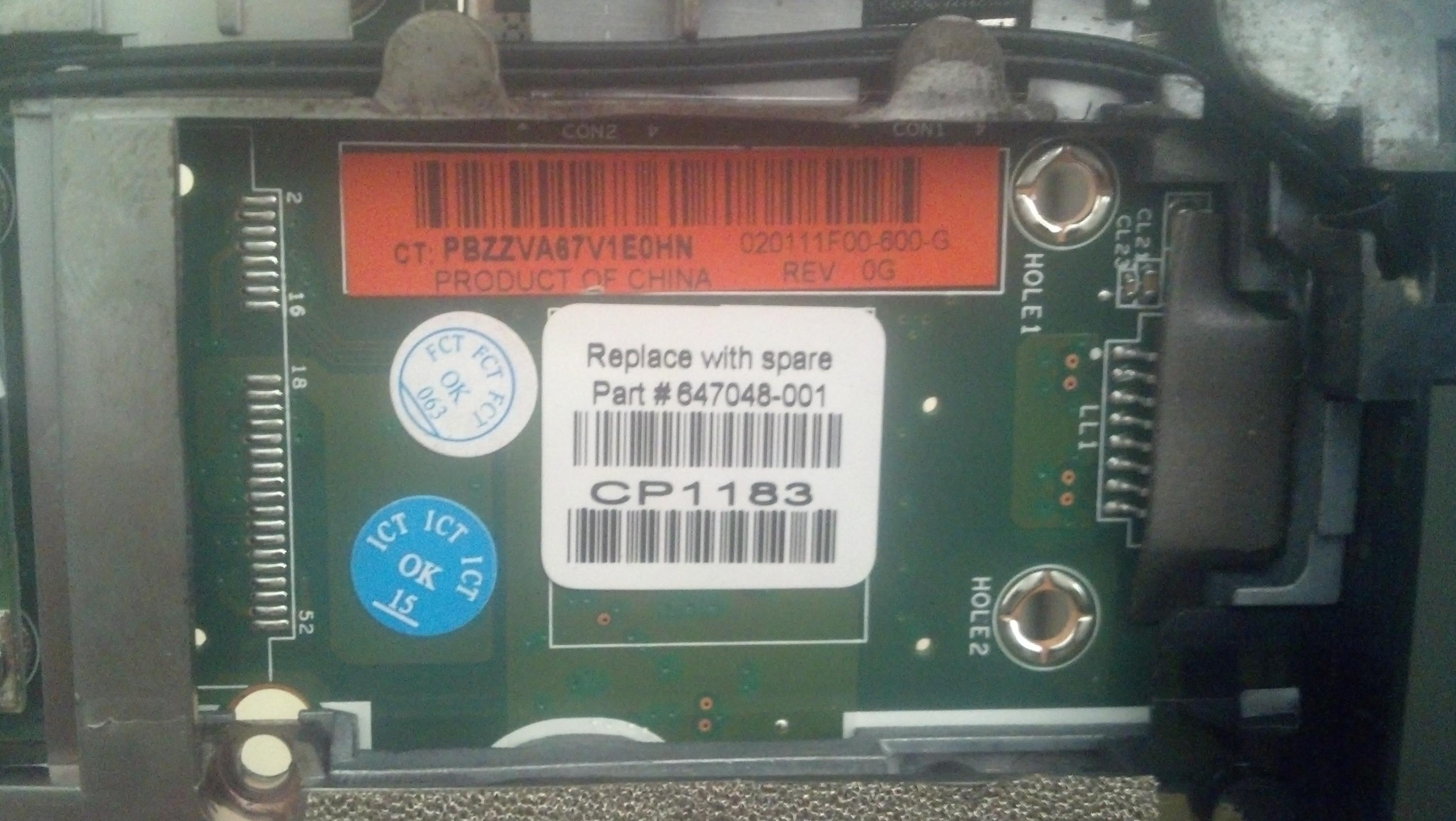

    when you enter the part number from your first pic into ebay, you get, HP Mini 110-3000 *** 647048-001 *** Integrated 1.66 Intel Laptop Motherboard

      Yes you're right but as soon as I browse further it becomes 210. I think I need to remove it from case to check processor. thanks man

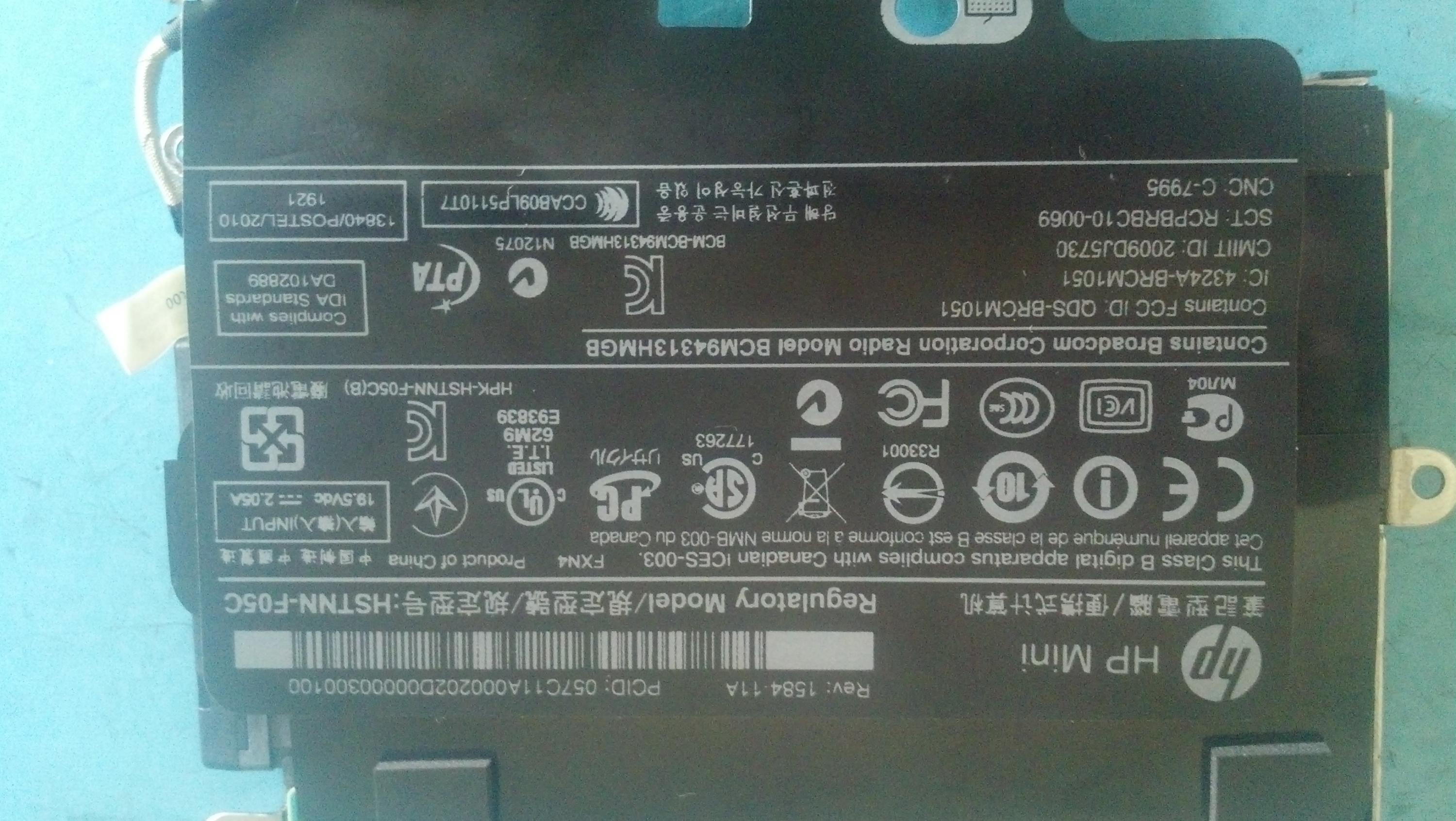

        Hi - I tried under HSTNN-F05C which suggests 210
        but on hp forum it says HSTNN-F05C is not a model or part number
        I did spot a video and when they removed the back panel from a 210HD
        there are some white labels on the underside. does yours have any are they any help?

          processor is Intel atom N570 1.667Ghz dual core, memory is ddr3. I also find this code please check image again. Thanks.

              take a look at this, first and second post in particular, same motherboard code, https://www.badcaps.net/forum/showthread.php?t=26108

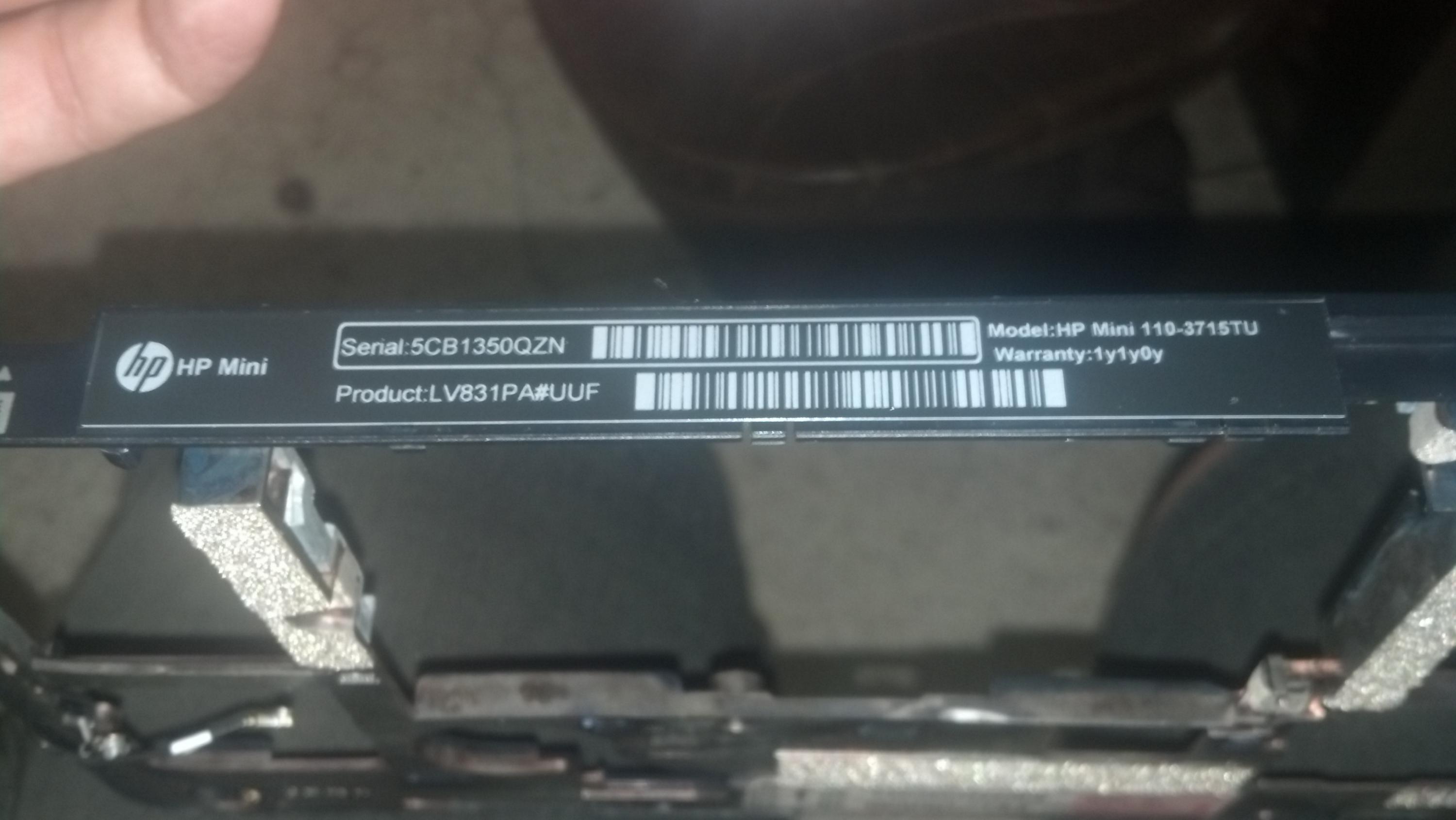

                Thanks very much guys. I have finally found the model no. Its an HP Mini 110-3715TU. The owner told me he put an electrical tape on the side of the sim card slot to make the battery fit. It was my mistake not to notice, but it was a clean cut. As if it was made from the factory. It took me almost 5 hours to figure it out, how stupid of me. Well now at least we can focus on the main problem of having no power.
