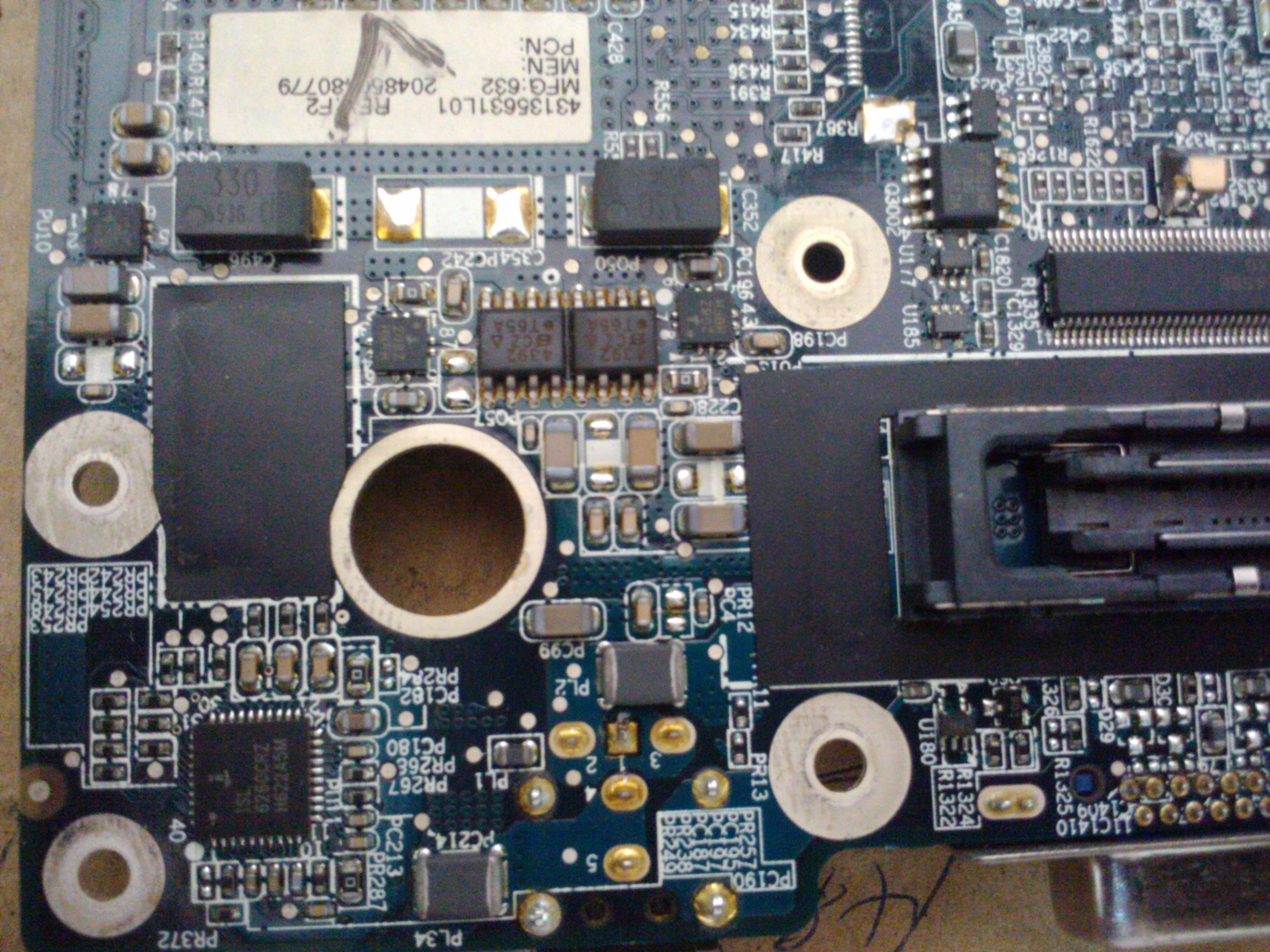

    Hello masters of our time I greet you all please I really need help I have this Dell D620 laptop. The AC supply is working - green LED on - but as soon as I plug it into the back of the laptop the LED goes off. I've tried a second power supply, same thing happens. Nothing is working.

    something is shorted in laptop tried with battery in/out

      Selldoor please what do you mean by battery in/out, I have tryed using battery and is working but it off the charger when I plug in the charger into the power.

        Re: Dell D620 charger plug in LED go off
        Ok it is good it work with battery.

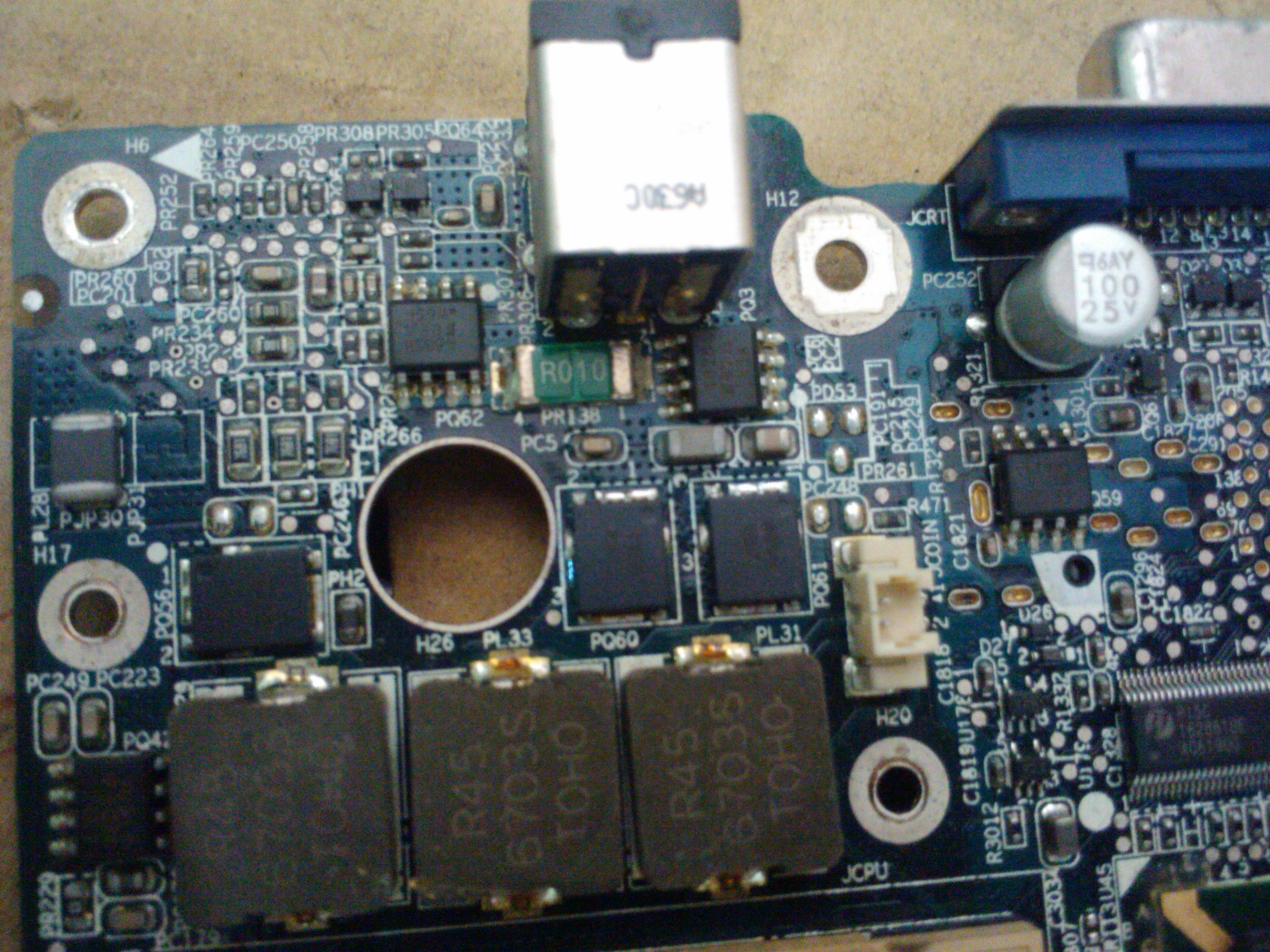

        You need to post a good clear picture of the motherboard with a close up of the area
        around the power socket
          this is it Boss thankx
            what is part number on PQ3
            on the other side check PC99 to see if it has failed shorted.
