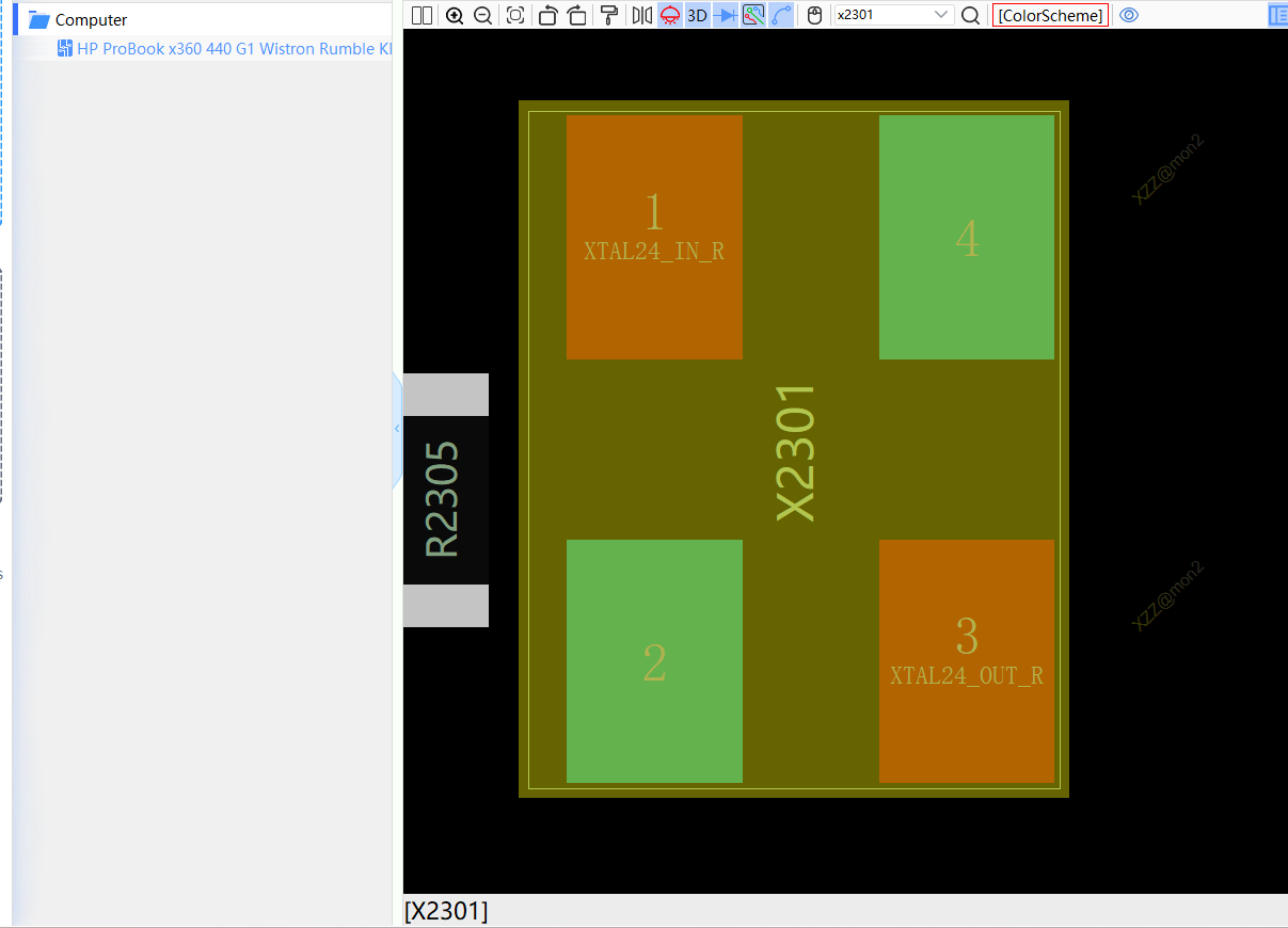

    Hi, i need help identifying component on HP x360 440 G1 motherboard ( Rumble 17869-1)
  • mon2
    • Dec 2019
    • 14316
    Part number with 'X' are usually for Crystals / clock oscillators.
    From BV, confirmed the part is a crystal - since the power rail is not showing in the BV, the part is not an oscillator which will require a power supply.
    The pin # shows as 24 so most likely a 24 Mhz crystal but not sure of the physical size. It could be a 2x3mm SMD crystal. You can measure with a micrometer and share the dimensions.

      Mfg Code: XTAL-24MHZ-182-GP082.30006.0531 OSC-3225-4P-3H36
      someting like:
      https://www.digikey.de/en/products/d...-L-R-T/2637768
        Click image for larger version  Name:	x2301.png Views:	0 Size:	58.3 KB ID:	3618206
        Thank you for quick and detailed answer.
        Dimensions are 2.5x3.2mm.
        someting like:
        Thank you.

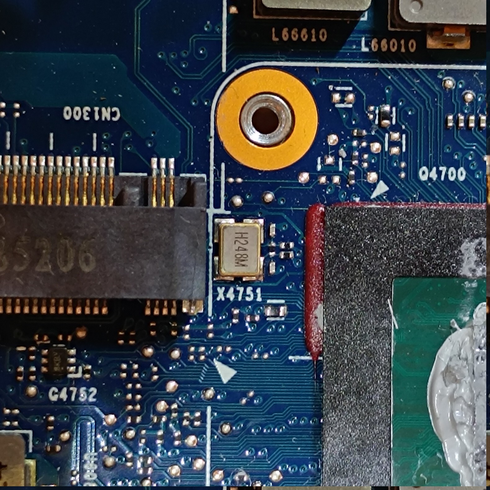

          Update, after cross referencing x360 440 G1 board with schematics and boardview of elitebook 840 G6 (Both being 8th gen/sharing same CPUs) i think i found the matching crystal,could someone confirm this?

            Transplatation successful, i stole X4751 from dead EliteBook 840 G5 motherboard, x360 440 G1 now starts and enters bios. I still need to reassemble the laptop and check if it really works as intended.
            mon2 ​ and NightcoreSenpai, thank you.
