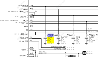

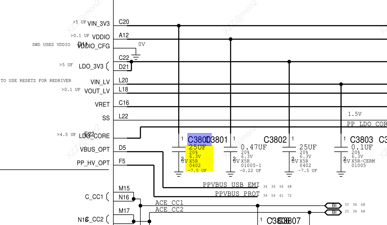

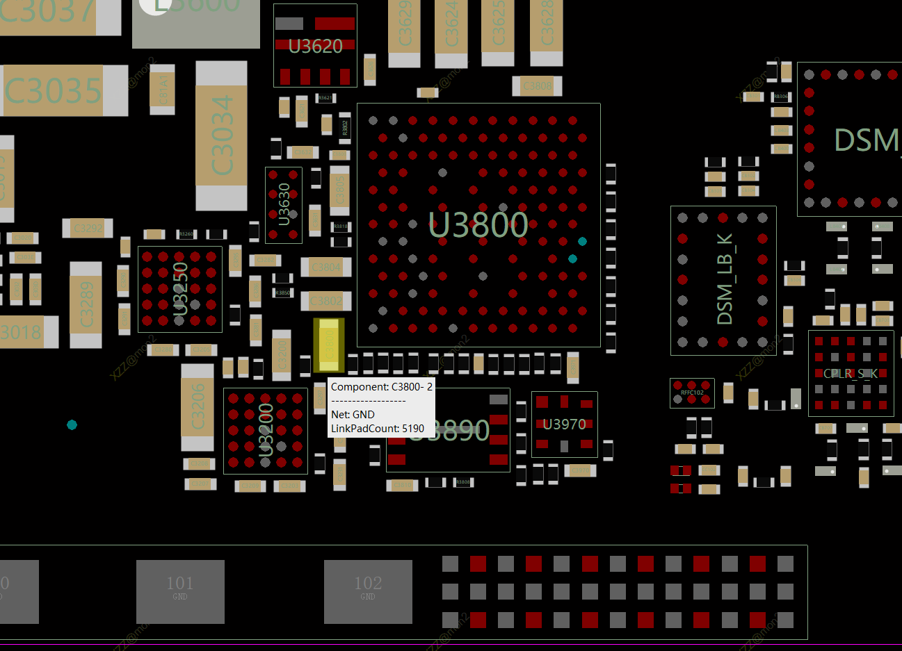

    こんにちは。マークされた部分のデータを誰かに教えてもらえますか? または、iPad Pro 12.9 第 4 世代のロジック ボードのボード ビューと回路図はありますか?

    Hello. Can someone give me the data for the marked parts? Or do you have a board view and schematic for the iPad Pro 12.9 4th generation logic board?
    C3800 = 25UF, 6.3V, X5R, 0402 - part value is not super critical. Let me double-check this part as the part does not look like 0402 in size from the pictures.
    Ok - the part location and size match the schematics = 0402. Just looks larger than 0402 to me.
    If possible, please measure the size (length x width) of this capacitor with a micrometer to confirm. To me, this part looks like 0603 or 0805 in smd size. You can always purchase a few of each size = 0402; 0603; 0805 to be safe. Schematic states 0402 in body size.
