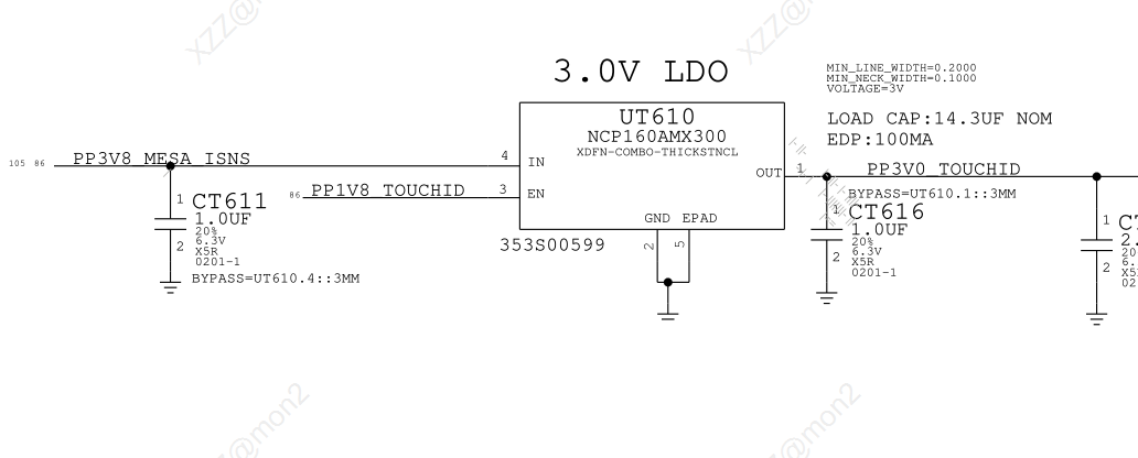

Macbook Pro A2338 no power. This chip is short and goes extremely hot. When removed the short is gone. Can someone help me out what chip is this?
Macbook Pro A2338 No Power
What is the reference to this part in your bv file?
It is UT610 from my bv file.
Part # NCP160AMX300
ONSEMI is the vendor.
https://www.arrow.com/en/products/ncp160amx300tbg/on-semiconductor?utm_source=google&utm_medium=cpc&utm_campaign=brand_g-ppc-us-sku-english-all-na-power_management-main-v4_q1_2025&utm_content=na_en&gad_source=1&gclid=CjwKCAiAzvC9BhADEiwAEhtlN0LnQmK529Bf_AfILPWl1al-ubULzNoKZ7ZuinllxJhYaWo5gQNaBhoCnPwQAvD_BwE&gclsrc=aw.ds
https://www.aliexpress.com/w/wholesale-NCP160AMX300TBG.html?spm=a2g0o.home.search.0
There are a few other vendors that are building in this package including Texas Instruments.
Before you replace the part, test the resistance to ground on the output rail of this device. If this part is getting hot, it may be because the rail is shorted or exceeding the specification of this low current LDO regulator.Last edited by mon2; 02-24-2025, 07:09 AM.
