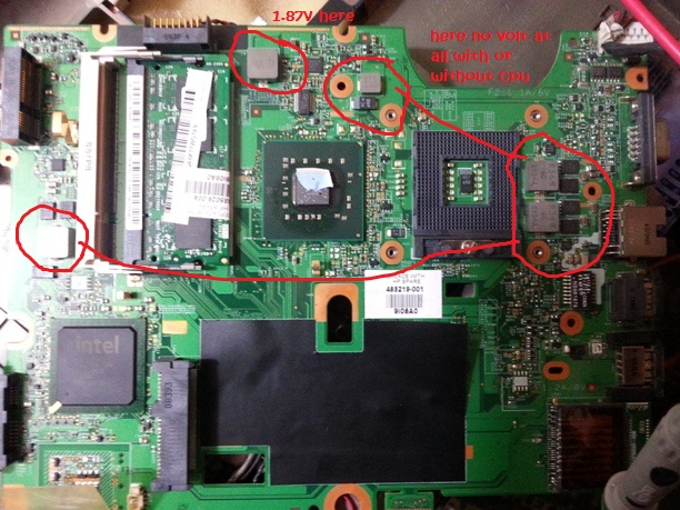

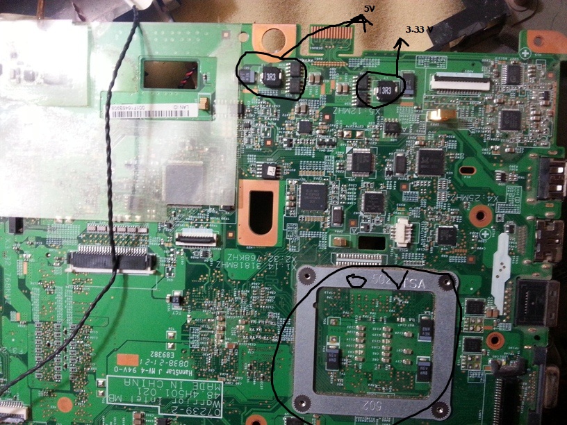

    this laptop does not display on monitor; the 3.3v and 5v are present, the voltage of ram is 1.79v , the cpu gets hot when power is on. but there is no voltage on cpu core. i changed cpu no luck.
    here are the volts i got

    i solved the problem by changing the bios because the old one does not hold software at all it was filled with ffff and cannot reprogrammed
