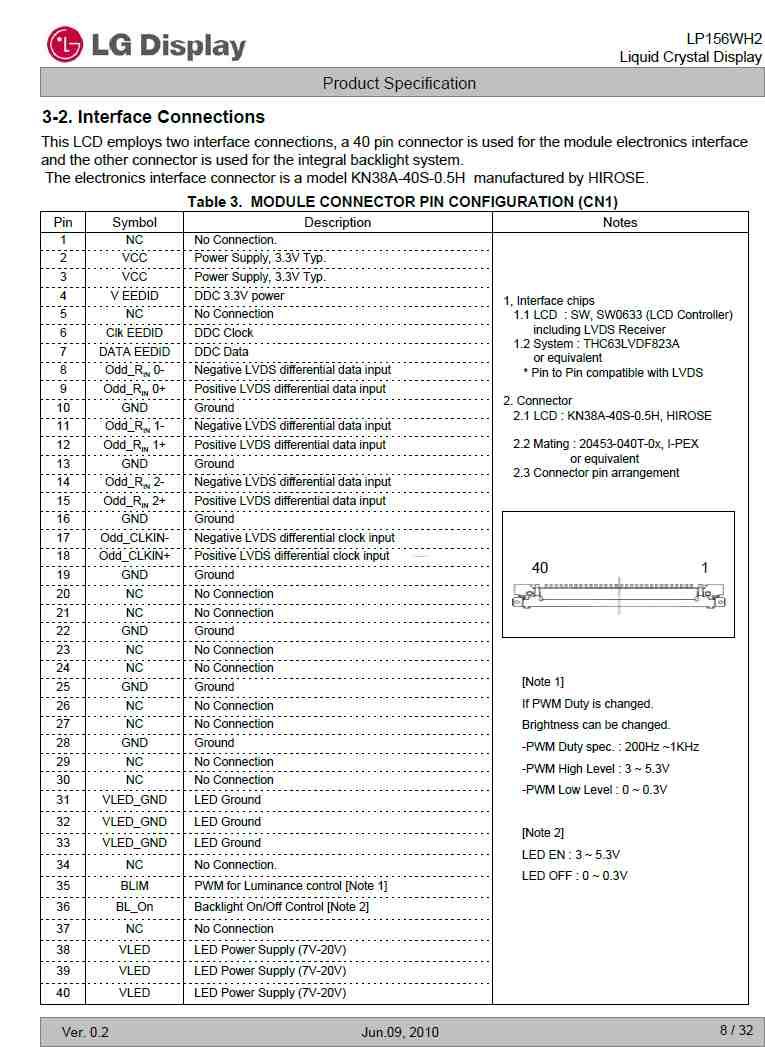

    1. i have try another screen but it just the same.
    2. i also try to trace cut wires of lcd cable going to the MB. continuity test ok.
    3. and i also did test voltage on lcd connector 40pin. i got 20v on pin 28, 29, 30
    3.3v on pin 2,3,4.
    and i don't no what to do next..

      Re: lenovo G450 no back light on led screen.
      check pin36
      it's the signal to turn the led's on.

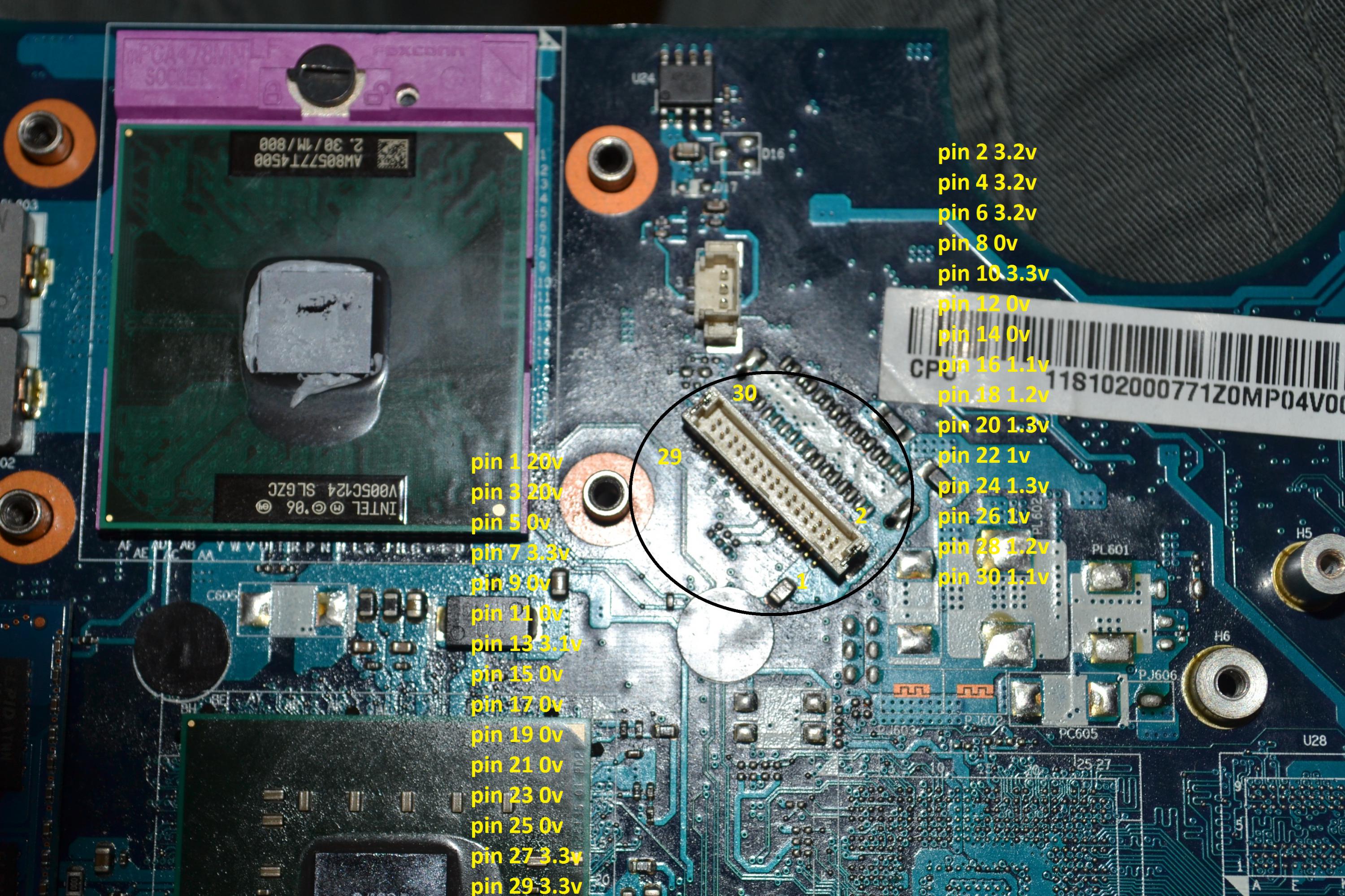

              connector JLVDS1.
              here is my voltage reading.
              pin pin
              1. 20v 2. 3.3v
              3. 20v 4. 3.2v
              5. 0v 6. 3.2v
              7. 3.3v 8. 0v
              9. 0v 10. 3.3v
              11. 0v 12. 0v
              13. 3.1v 14. 0v
              15. 0v 16. 1.1v
              17. 0v 18. 1.2v
              19. 0v 20. 1.3v
              21. 0v 22. 1v
              23. 0v 24. 1.3v
              25. 0v 26. 1v
              27. 3.3v 28. 1.2v
              29. 3.3v 30. 1.1v
                  Problem with SIO. You need to supply 3.3v to pin 9 of lvds connector. Check resistance to ground of that pin. Hopefully problem is C852

                                    U46 KBC : no voltage on lvds connector on pin INVT_PWM and DAC_BRIG
                                    check on KBC on pin 21 and 68
                                    • dj_ricoh
                                      • Jan 2013
                                      • 2073
                                      • uk
                                      DAC_BRIG needs to be ... I think around 3.1(2)v-3.3v its the adjust voltage. no voltage here no backlight. if you connect 3.3v direct you wont have adjust only full brightness.
                                      and INVT_PWM like the name say Invertor power
                                      • rickybucalan
                                        • May 2013
                                        • 322
                                        • philippines
                                        tnx for reply. hmmp i got 3.3v on pin 21 of u46 and 0v on pin 68.
                                        is the 3.3v on pin 21 will appear on pin 11 of JLVDS1?
