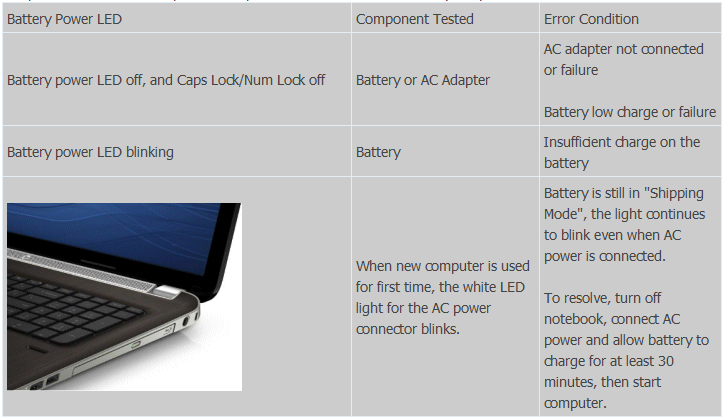

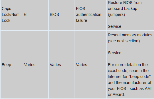

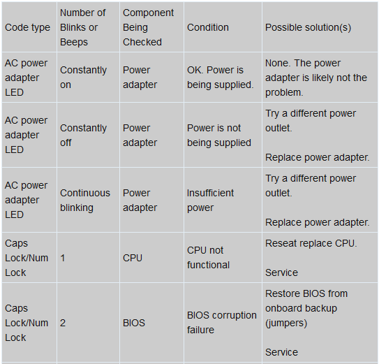

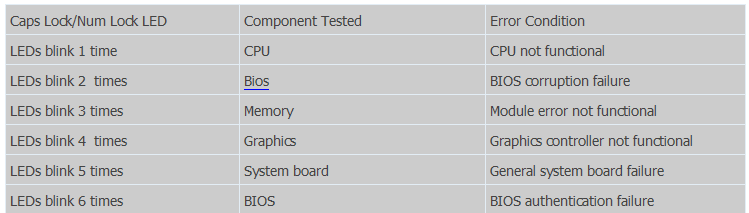

        Re: DV5-1000 led error code
        plz check blinking codes..!!!
