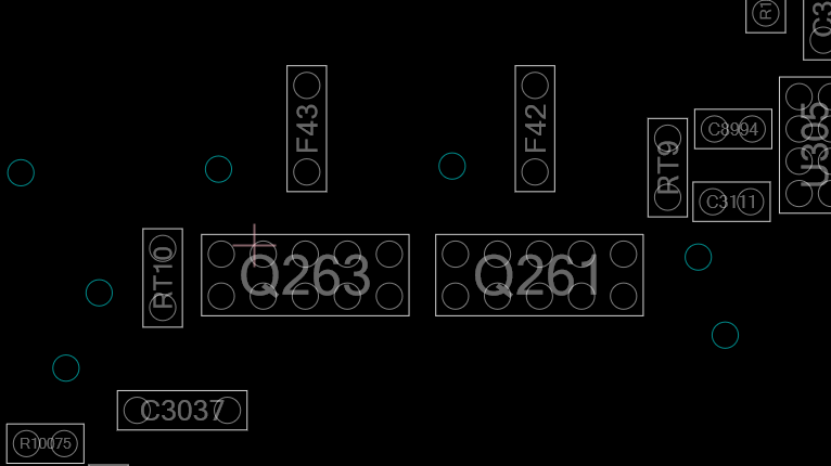

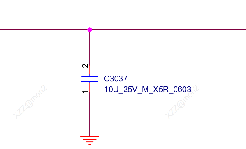

                            Hi, does anyone know the value for the capacitor above q263? it's blown on my laptop but i dont know the value to use to replace it

                              Is it C3037?

                              • Cavallonzio
                                • Mar 2025
                                • 4
                                • Italy

                                exactly, so I need to replace it with a 10 μF 25V capacitor, am I right?

                                  Yes With 0603 physical size.
