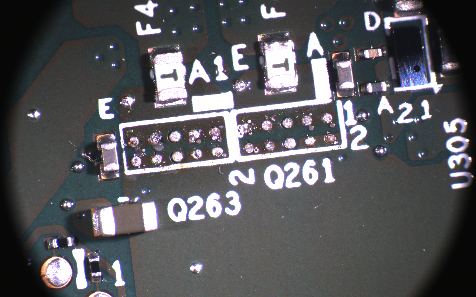

    I had a x1 Carbon Gen 9 come in with a no charge and no USB C power up problem (the machine would turn on with a new battery until it lost charge).

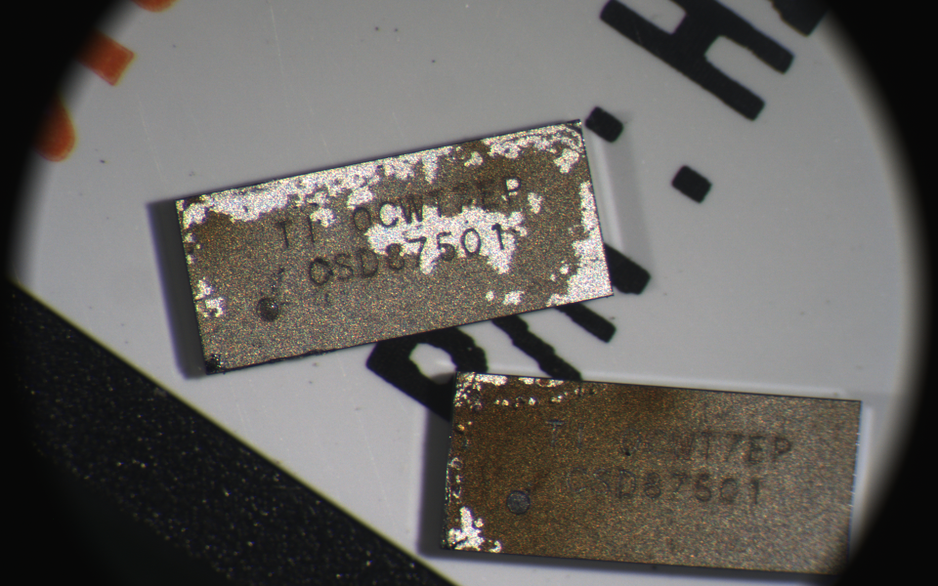

    I noticed lifting the protective black membrane near the USB jacks that two little BGA chips were stuck to the adhesive and had fully released from the mother board, one of them looking fully scorched. Q261 and Q263 power MOSFETS.

    These are LGA packaged components and have very little meat with respect to the solder balls to keep them in place. You can try to flux and rework the parts back into place.
    Alternatively, you can purchase new ones but keep in mind that the chip is supplied without solder balls (castrated) so you will have to reball these using an appropriate SMD stencil.

      You don't think I can get away with packing a bunch of solder paste on the pads and yolo-ing with a hot air tool balling them onto the surface of the LGA?

        It worked pretty well to just cover the CSD87501L with solder paste and use low velocity hot air. I would often get a bridge between a couple of the pads, but it was easy enough to remove with an Iron.
        I got this laptop sort of back up and running. One of the USB-C ports will trickle charge the laptop at 5V drawing a max current of 2.22A, In some conditions it will ask for 20V and charge better.
        I'm not sure if that's an issue with the data communication lines? This jack will not connect to USB drives.
        The Rear USB-C Jack will not charge, but works for USB drives. Very Odd behavior. I will check some of the ESD diodes on the com lines.
        I suspect this board had a solder flow issue during manufacture because I found an important inductor L79 loose, and the power mosfets in question were stuck to the black insulation plastic when I removed it.

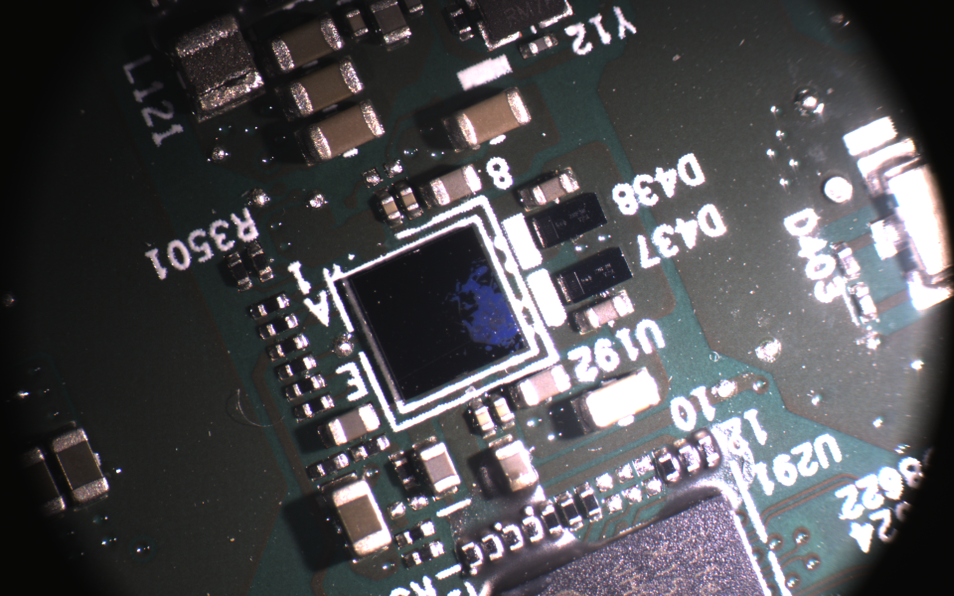

            The plot thickens. I wasn't happy with it's weird behavior there were some chips I couldn't see because the heat sink was hovering over them, and this is what I saw after removing heat sink.
            The weird part is there is absolutely no corrosion I've noticed anywhere else on the board yet this happens to be well away from any ingress points.

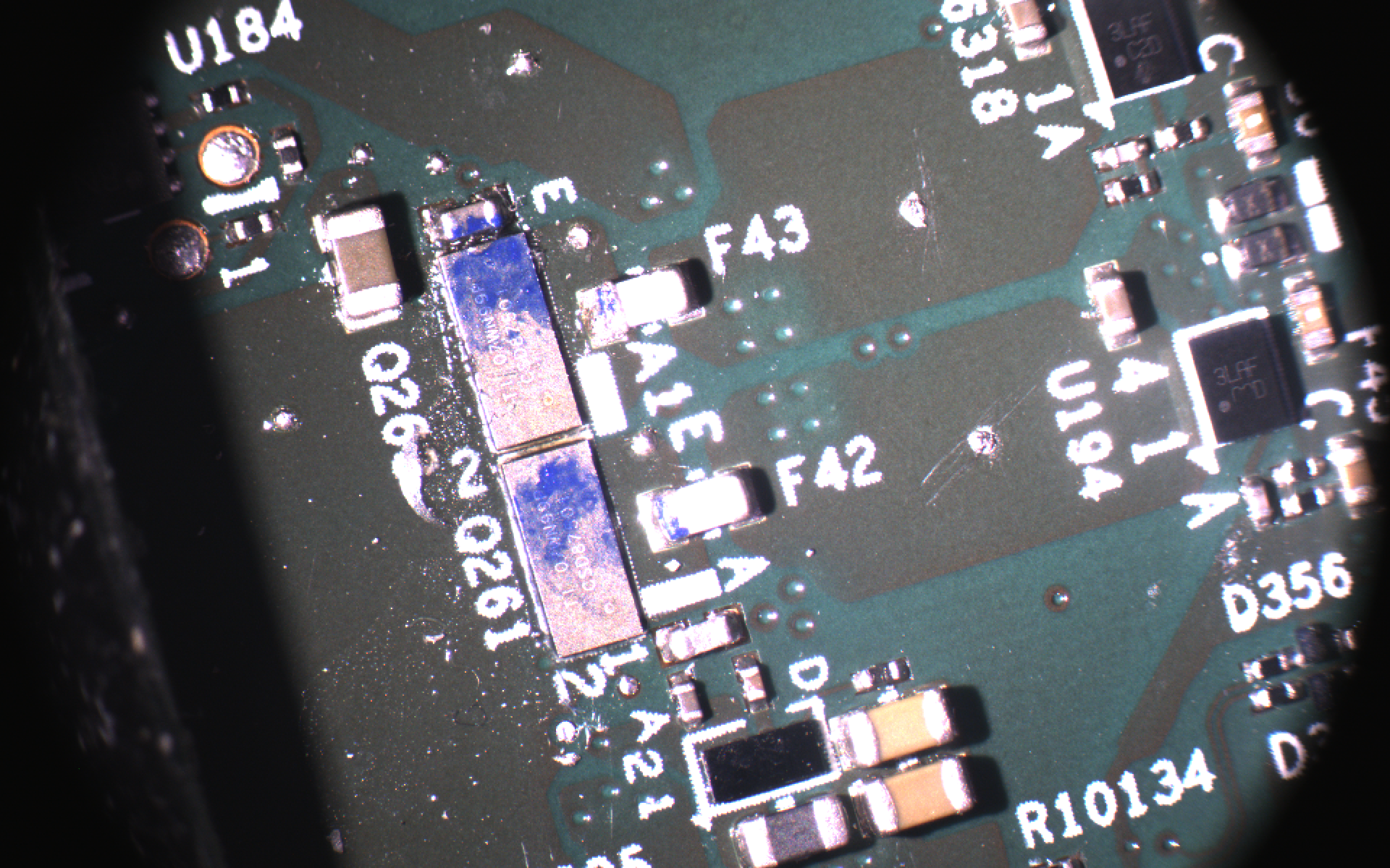

                      Funny I came across another of these x1 carbons. Allegedly a Lenovo tech came and replaced her board while it was under warranty; however, one of the jacks still wasn't working and the tech said oh its just a loose jack you can only use one.
                      That sounds pretty sleazy since the jack comes along affixed to the replacement board.
                      I just received it because the charging has gotten erratic.
                      When I opened up the laptop I saw the attached images.
                      These are the same components I had an issue with, so it must be a very common failure mode for this model. There was also a bit of semi melted solder paste stuck to the board so whoever did the work didn't bother to clean up much.

                            I regularly come in posession of this model with the same issue: both USB-C ports come in drawing 5V/0A. It is those CDL mosfets that come unglued from the motherboard. I normally throw them away and use new ones. As Mon2 had been mentioned earlier in this thread, they are so tiny that the proper way to reball them is to use appropriate stensil. I use my soldering iron instead and that is just not enough. I also reball the motherboard surface as well. On several occasions, a USB-C port randomly switches from 20V back to 5V while still drawing closer to 3A of current. This problem I am still unable to fix. Only in a single case the problem was fixed when I ultimately updated the PD controller firmware.
