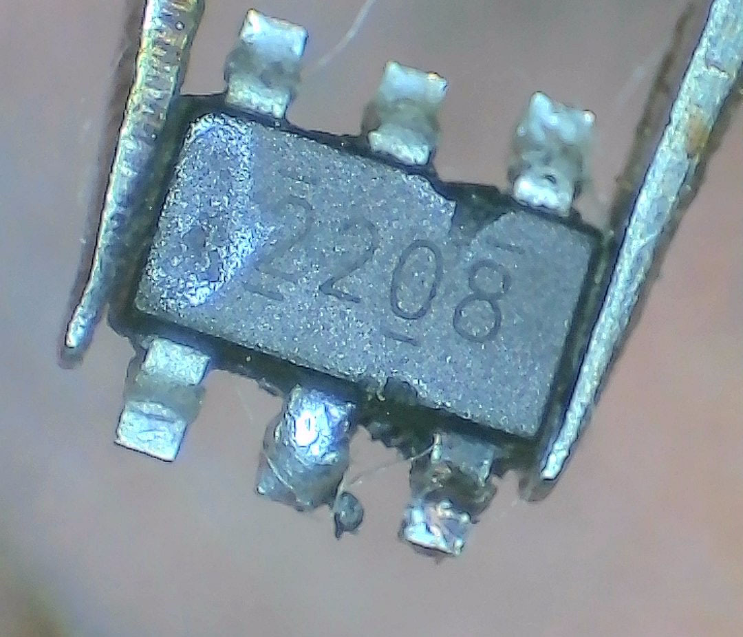

    Help identify this regulator, Thanks

    From which board? Share a pic of the board location to confirm the function of this part.
    It *may* be the TI TPS562208DDCR but need to check if you have the horizontal bar markings.

      Thank you, if that's it... thank you very, very much

        Suggest to apply alcohol to the top surface to clean off the flux / top side. Then compare the SMD markings of the TPS part with the 2208 markings. Do you also have the bars on the surface? Hard to tell from the posted pic.

          The bars are in a different position, is it important? From the data sheet I reviewed TPS562208DDCR, it is viable because the circuit is supplied by 12v 1a

            This is the same part (TPS562208DDCR) from TI.
            I would replace it and source the original from:
            TI.COM website ; often they supply free samples if you sign up for an account
            Digikey
            Mouser
            Arrow
            Use Aliexpress only if you must since this part is available through normal distribution.

              Sorry, but since you managed to identify it, it took me all morning searching through data sheets and diagrams before asking for help here.
