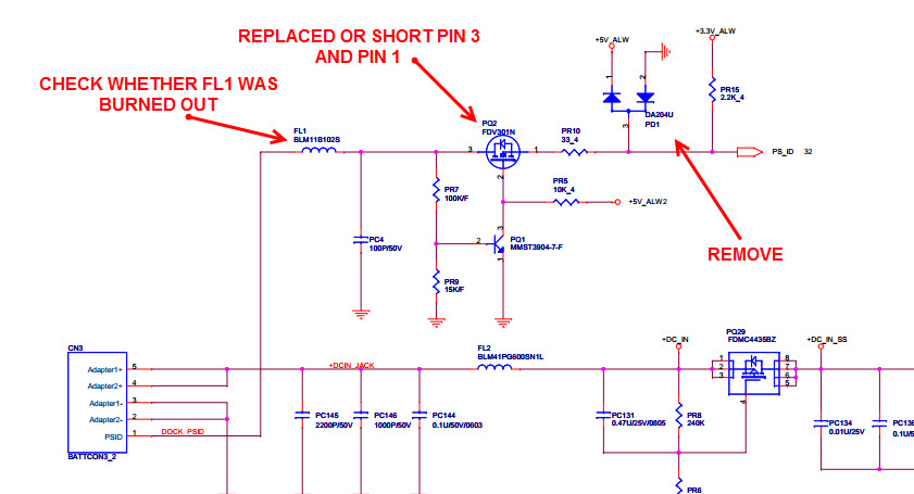

    I have new problem with Dell N4110 laptop. It doesn't charge battery.
    Battery Led blinks Amber/White.
    Adapter type is unknown in BIOS menu.
    Test performed:
    Checked with new battery same problem.
    Flashed BIOS same problem.
    Please help if anybody faced such problem.

    Re: Dell N4110 - Battery won't charge
    It does not charge because it could not recognize the adaptor type
    Try this
      @vvacl
      Thanks for your input.
      I changed IO chip and it fixed my problem.
        Sio?kbc?
          I mean SIO/KBC.
            Originally posted by dspok
            I mean SIO/KBC.
            how did you know it was the KBC?
            and good job btw!
              and good job btw!
              3.2v was present in PIN no. 87 of ITE8518E, just to try I changed it.
