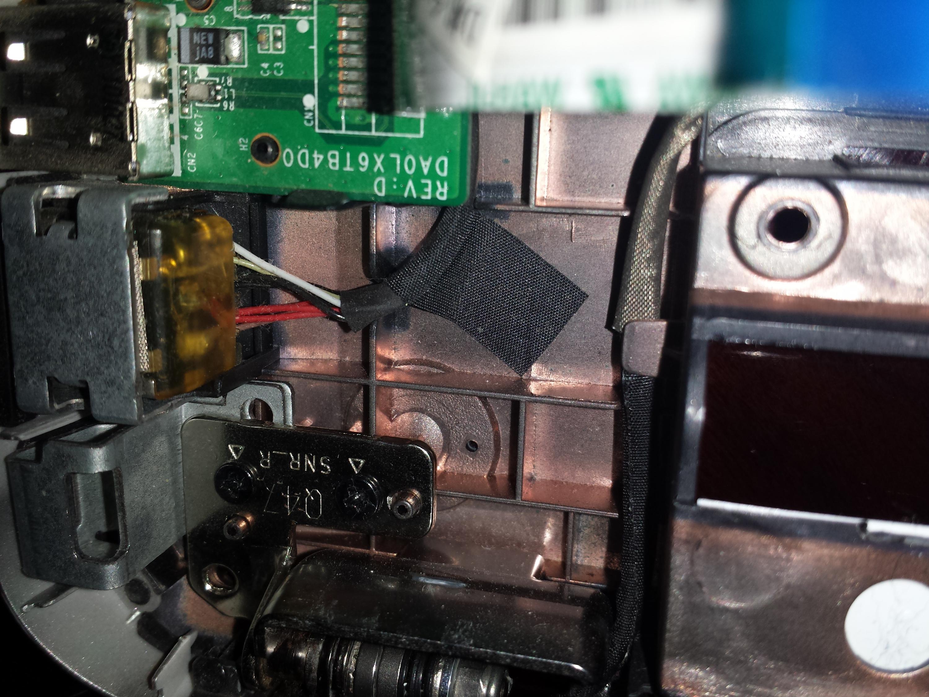

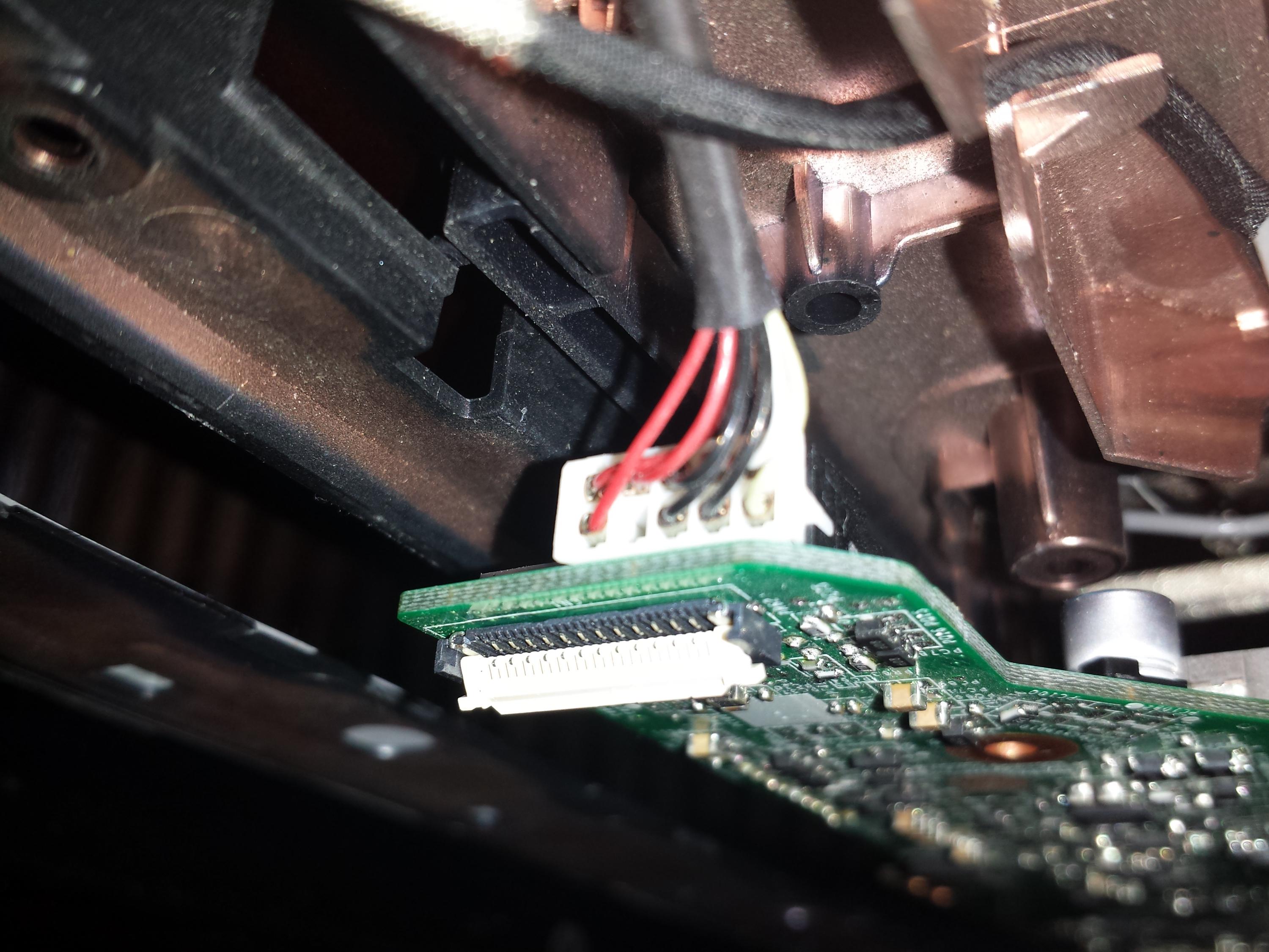

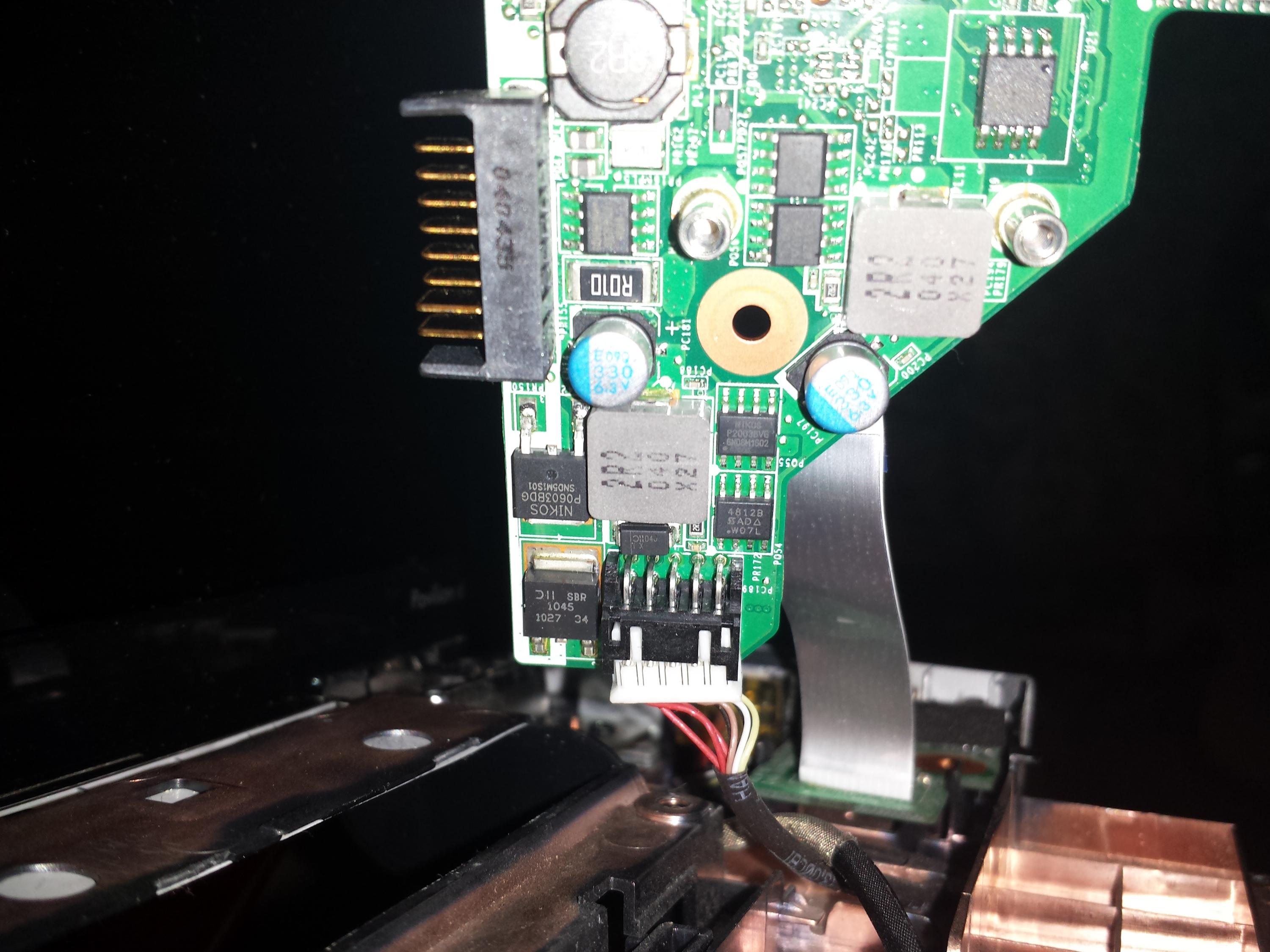

                  Re: HP Pavilion No Video on Display
                  Originally posted by lefos
                  Can you see in the panel if there is picture? There might be dark picture (no backlight) if so then you have to check if there is any fuse for the backlight on the mainboard.
                  I did shine a flashlight and there was no picture. The only thing that looks remotely like a fuse that I can see might be on the dc jack pictures attached

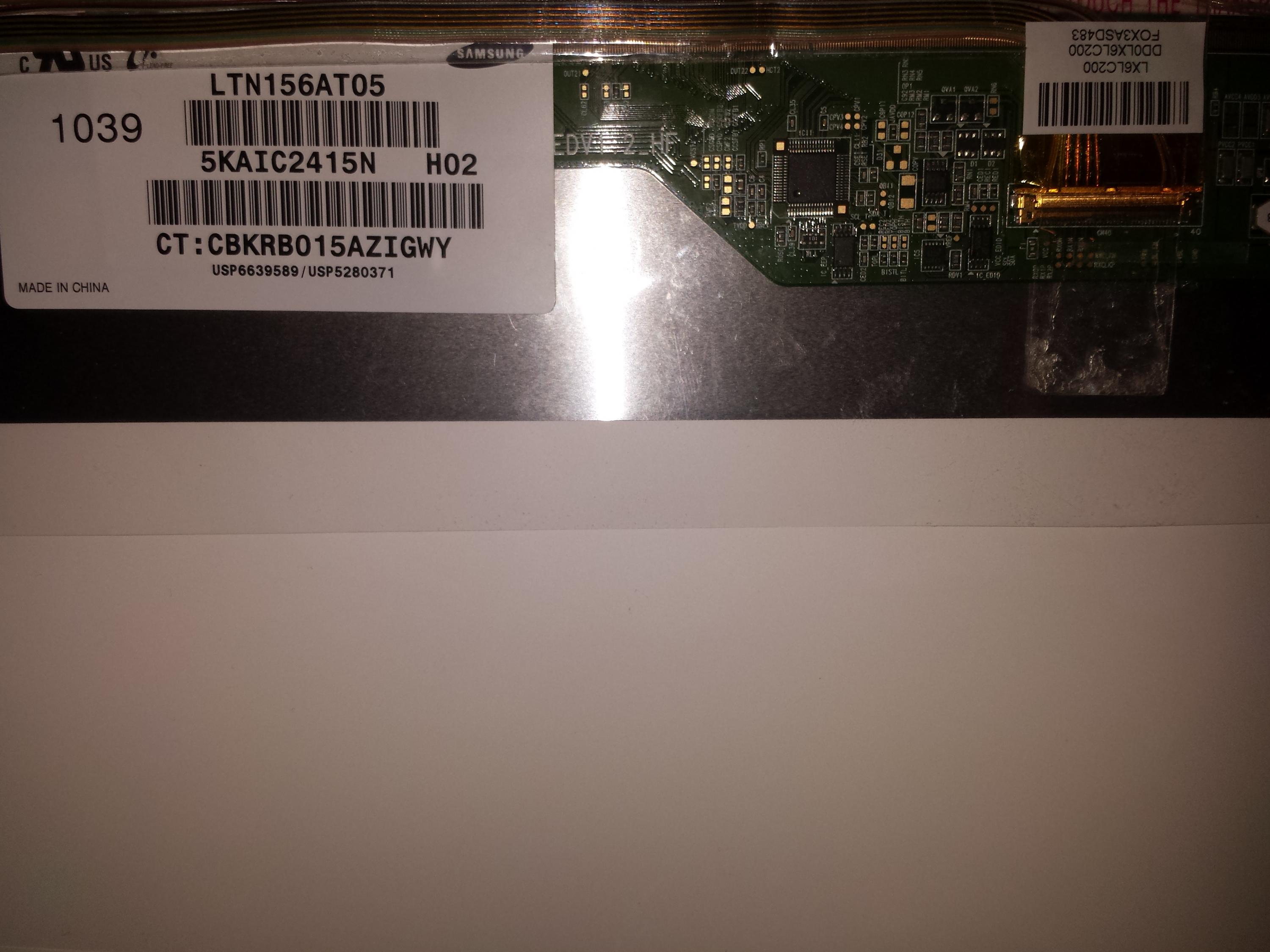

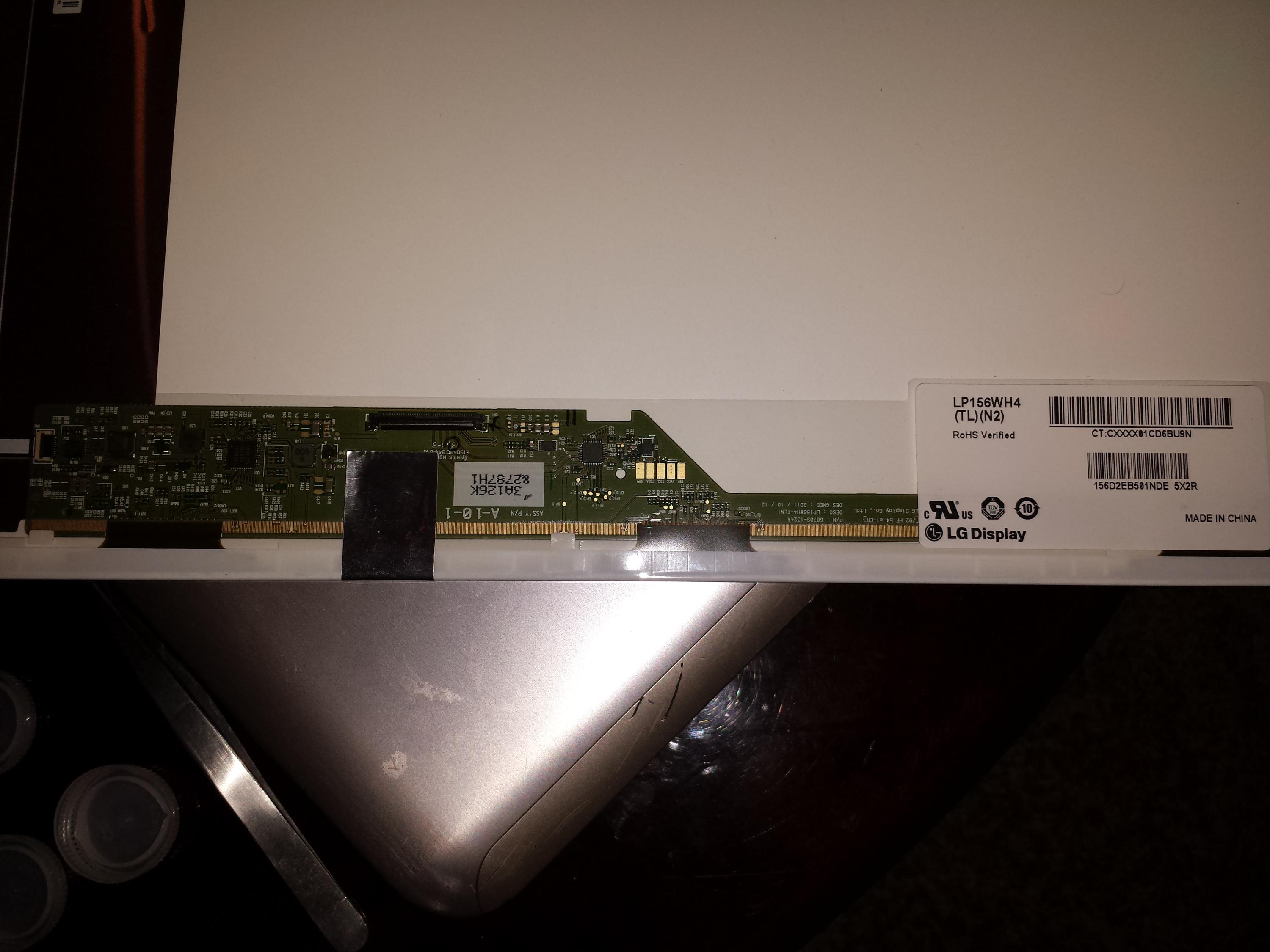

                          Do you have panel model numbers for the both of them?
                          • blu
                            • Sep 2013
                            • 11
                            • US
                            Finally got attachments working again.
                            models #s in pictures
                                  post a picture of the screen connector on m/board and the surrounding components
