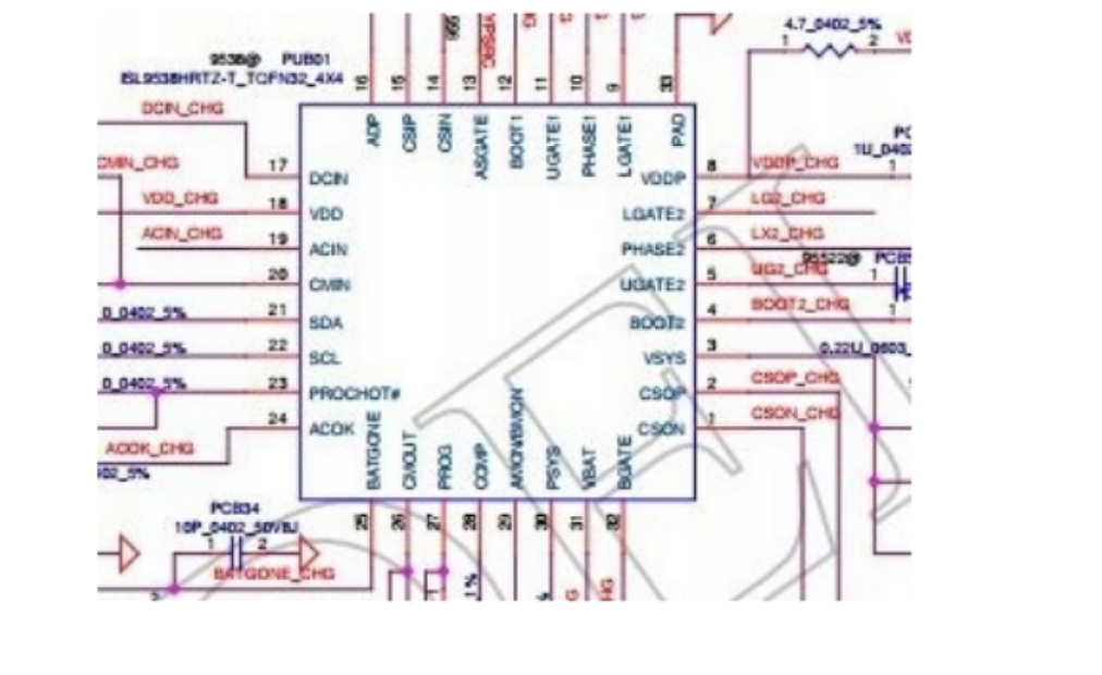

    SMD Asking equivalent, Can I replace ISL88738H WITH ISL88739
    Can I replace ISL88738H WITH ISL88739?
  • mon2
    • Dec 2019
    • 14415

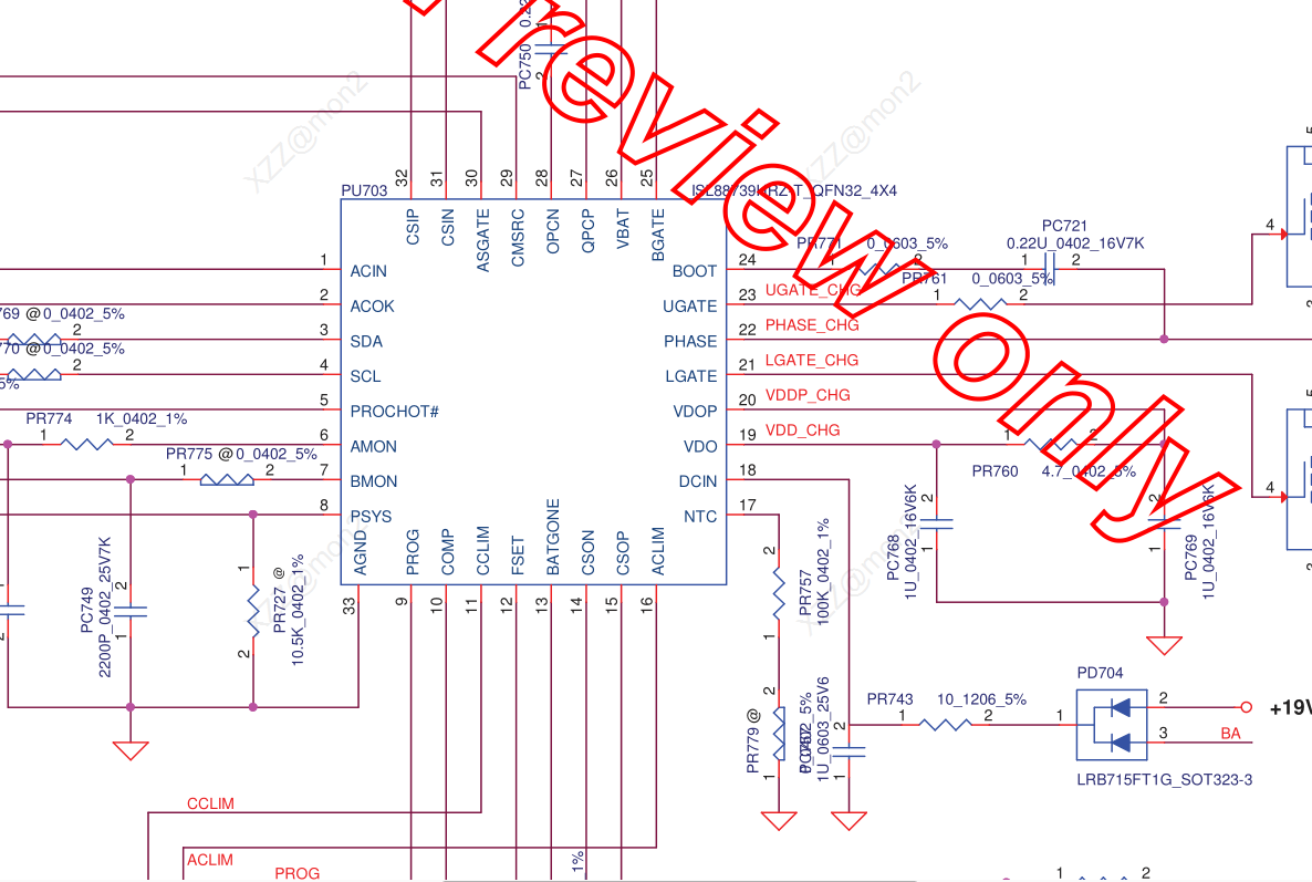

    See attached.
    Short answer - no. Many differences. See SDA / SCL for example. Different pin locations.
