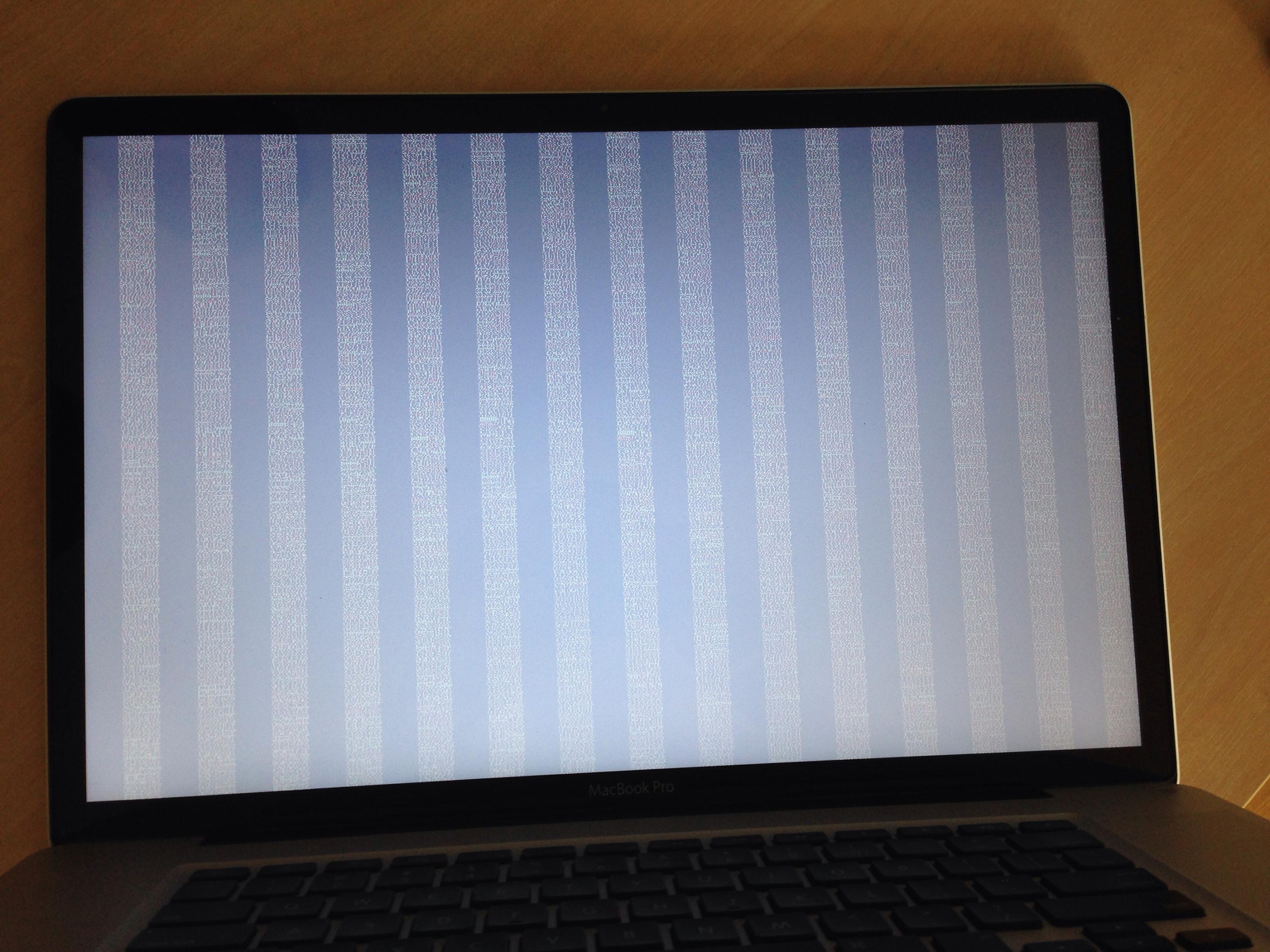

    Hi, i have this macbook pro 17" that have white screen i show apple logo with artefacts. I try to change RAM and turn on widouth HDD. Is this a GPU fail?

    yes. gpu.

      so reballing or replace GPU?

        did you try an external display ?

          Definitely GPU. No external monitor testing required. What GPU does it have exactly?

            i think nVIDIA i do not have the macbook currently at my home. There is no external connector

              if it is a Macbook Pro A1297 It has a mini display port for external monitor

                yes but i do not have cable for it

                    try to reflow on black video ram on gpu side.
                    before replace gpu.
