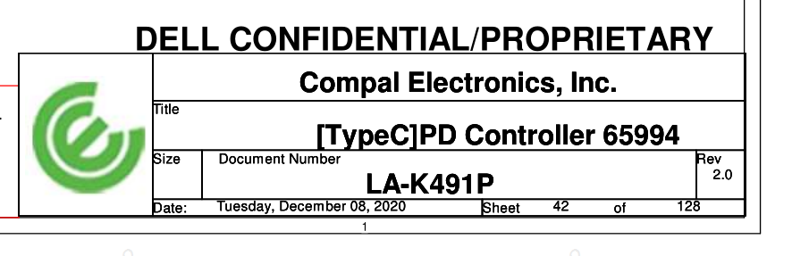

        My schematic for the LA--k491P has the TPS65994 onboard.
            Yes mon2 you are right, TPS65994 is the PD controller on this motherboard. I got the boardview for this model but stil no Schematic, do you have the schematics to share with us.,trouble shooting will be easier. I have already shared the boardview in the schematics for LA-K491P thread.
            • mon2
              • Dec 2019
              • 14720
              Yes I do but in a locked PDF. Let me PM you.
