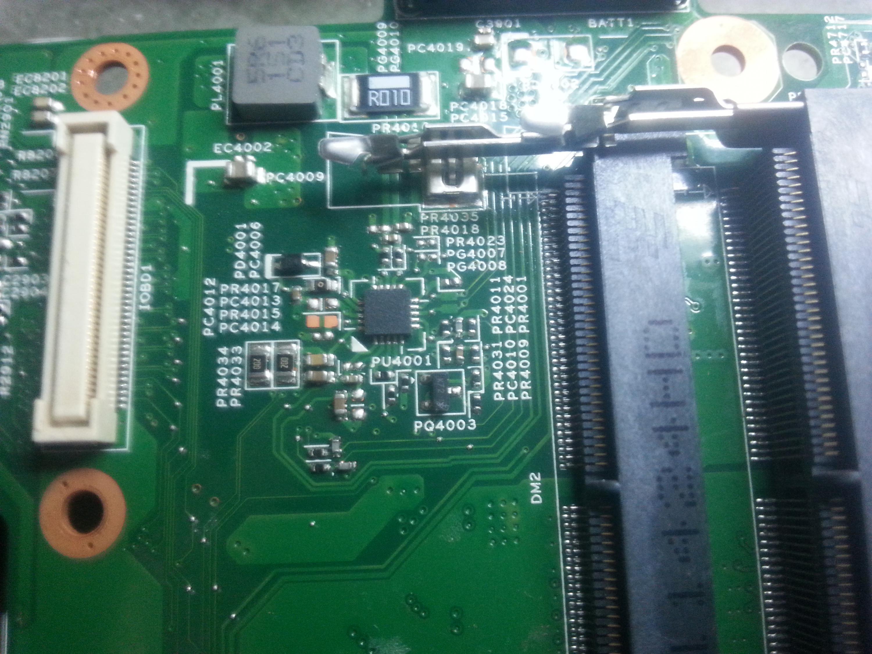

            • abbas_govani
              • Jul 2013
              • 89
              • India
              Re: dell n5110 no charger detect
              610 ohm @ pl4001 and pu4001
              1 19v
              2 2.6
              3 2.6
              4 5.8
              5 6
              6 0
              7 0
              8 2.5
              9 2.5
              10 0
              11 1.1
              12 3.3
              13 3.3
              14 0
              15 2.5
              16 0
              17 0
              18 0
              19 19
              20 19

                sir pu4001 is 20 pin ic
                • abbas_govani
                  • Jul 2013
                  • 89
                  • India
                  pu4001
                  • loser18
                    • Nov 2013
                    • 274
                    #29
                    Are you sure you've checked the right IC???
                    According to schematics it should be BQ24745...

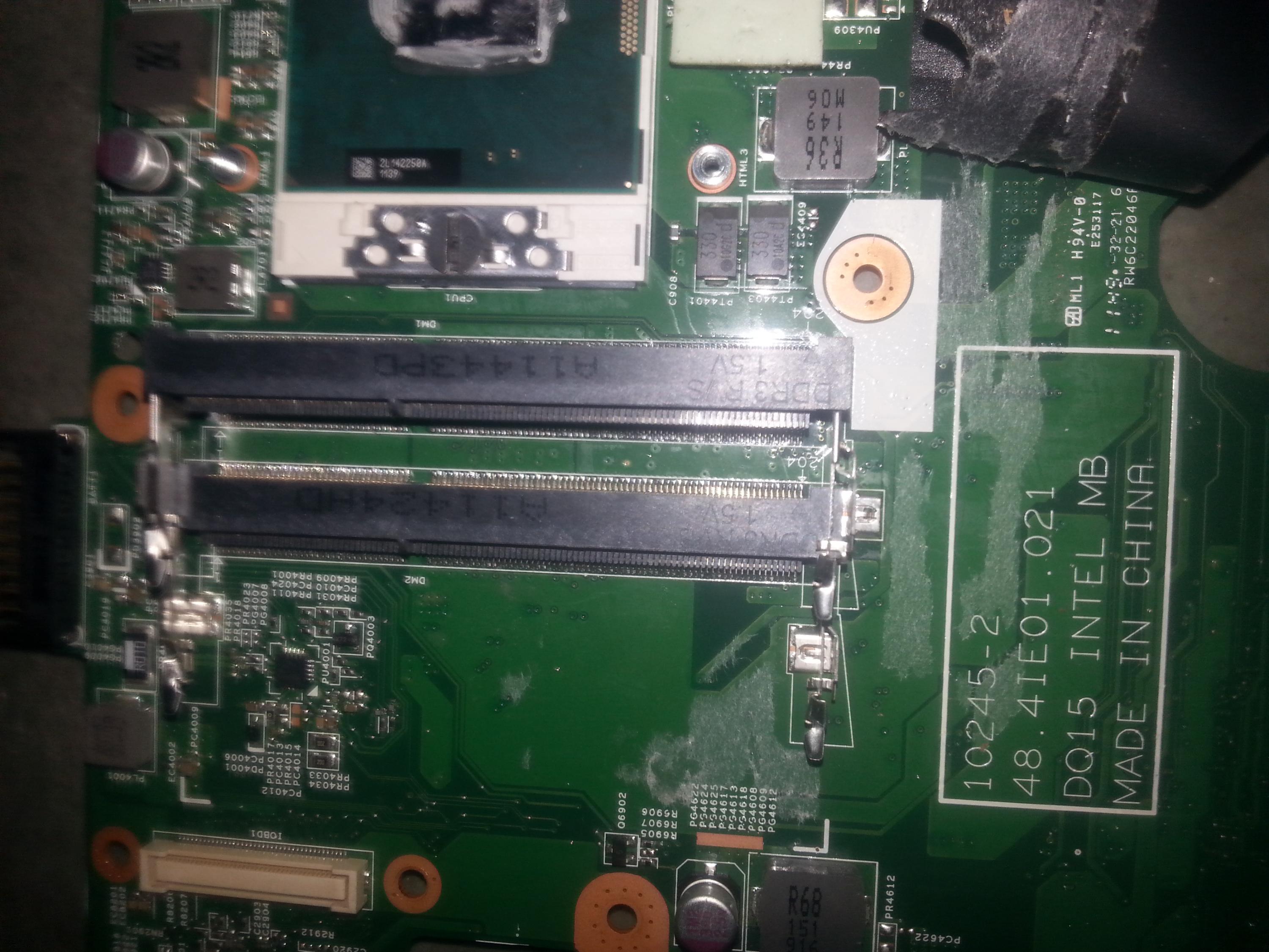

                      • abbas_govani
                        • Jul 2013
                        • 89
                        • India
                        #31
                        10245-2
                        48.4ie01.021
                        dq15 intel mb
                        • loser18
                          • Nov 2013
                          • 274
                          #32
                          And what's the PU4001 number?
                          • abbas_govani
                            • Jul 2013
                            • 89
                            • India
                            #33
                            • abbas_govani
                              • Jul 2013
                              • 89
                              • India
                              #34
                              cant read properly its like bq....
                              • loser18
                                • Nov 2013
                                • 274
                                #35
                                I've found 48.4ie01.021 schematics, but's an AMD...
                                • abbas_govani
                                  • Jul 2013
                                  • 89
                                  • India
                                  #36
                                  cant read properly its like bq074ti..
                                  • abbas_govani
                                    • Jul 2013
                                    • 89
                                    • India
                                    #37
                                    sorry it is bq07a
                                    • abbas_govani
                                      • Jul 2013
                                      • 89
                                      • India
                                      #38
                                      bq07a pin current
                                      1 19v
                                      2 19
                                      3 0
                                      4 0
                                      5 0
                                      6 2.5
                                      7 0
                                      8 3.3
                                      9 3.3
                                      10 1.1
                                      11 0
                                      12 2.5
                                      13 2.5
                                      14 0
                                      15 0
                                      16 6
                                      17 5.8
                                      18 2.6
                                      19 2.6
                                      20 19
                                      • loser18
                                        • Nov 2013
                                        • 274
                                        #39
                                        Why are the voltages different now???
                                        It's BQ24707A...
                                        Leave it on charger for 2 minutes & I think you'll get the same voltages as in your 1st post...
                                        I think it's in Over Current Protection and therefore charging is disabled...
                                        • loser18
                                          • Nov 2013
                                          • 274
                                          #40
                                          The IC cannot maintain the input current level if the charge current has been already reduced to zero. After the
                                          system current continues increasing to the 1.66X of input current DAC set point (with 2.5ms blank out time),
                                          IFAULT is pulled to low and the charge is disabled for 1.3s and will soft start again for charge if ACOC condition
                                          goes away. If such failure is detected seven times in 90 seconds, charge will be latched off and an adapter
                                          removal and system shut down (make ACDET < 0.6V to reset IC) is required to start charge again. After 90
                                          seconds, the failure counter will be reset to zero to prevent latch off.
                                          Think the IC is dead / shorted...Or some cap around shorted...
                                          It's a hardcore case without schematics...
