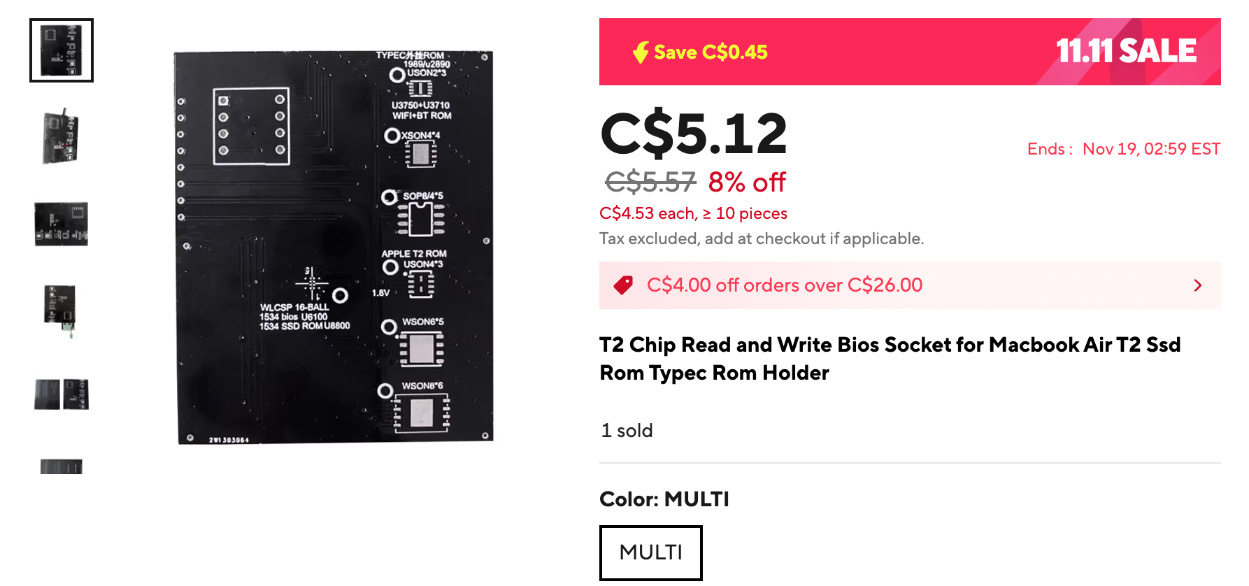

      Thanks @pienov for the detailed explanation & for the SPI ROM re-programming I found this board to solder the SPI ROM on it & re-program them. Easily available on AE & better the spending $165 for that USB tool above which does the same job.
Name:	Screenshot 2024-11-15 at 11.12.27 AM.png
