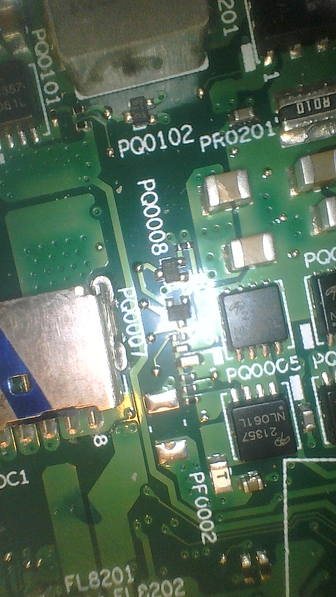

    Have a T14 gen1 20S1-S7A206 that threw up a battery error while being on a doc 100% of its lifetime. The user then googled the reset button trick and applied it about 5 times. That did not restore the operation. Instead, the laptop stopped powering on completely. I bought them a brand-new battery but still nothing at all: no indicator LED near the USBC socket, no LED on the power button, no start.
    I can see that the laptop draws 0.4Wt power from either the portrable PSU or the docking station PSU. No lights on the docking station either.
    Here's what I tried:
    Disconnect PS, hold the power button for 1 minute.
    Disconnect the battery and CMOS battery for 1 minute.
    Hold the reset button for 20 sec.
    All permutations of the above. Still no start, no light.
    Any suggestions?​ Please help, the kid needs this laptop for school!

                          I can see your posts in this public forum ok. Perhaps because you have recently signed up for this website so may need additional permissions.
                          If you see 20v in the power path, this is a good start. This means the USB type C adapter is sending out the capabilities of the power delivery contracts (voltage & current paired combinations) that are supported -> the logic board is digesting this small database of values -> the logic board's power delivery (PD) controller (ThinkEngine on Lenovo models) is selecting the best PD contract to power the logic board (20V).
                          Locate the battery charger PU0201 (BQ25700ARSNR).
                          Nearby will be the dual mosfet PQ0201.
                          Measure the voltage to ground of pins 2-3-4 (any of them is ok). Red meter lead on one of these pins; black to ground (metal shield is ok). Meter in DC volts scale (30V or higher).
                          Do you see the 20V being supplied by the power adapter?
                          The other dual mosfet of interest is PQ0202. Measure the voltage to ground of pins 2-3-4-10 (any of the pins is ok). This is the main power rail (VSYS15) that powers the logic board.
                          The battery pack itself may be a factor causing this board to not boot so suggest disconnecting it for now.
                                Of all of them, I can only see short 2V spikes every 200ms on 2-3-4 of 0201. They appear as 14mv DC on my multimeter.
                                All other pins are 0V
                                I see a suspect capacitor now. Should I take it off?

                                  Is it the cap with the off color? Sure, flux it and remove it. Then test the removed cap for its resistance. Test again without this cap.
                                  • keepread
                                    • Oct 2024
                                    • 33
                                    The cap was short. Now, I have amber light from the power LED and white blinking light from the power button.
                                    When I press the power button the blinking changes to solid lit white.
                                    After a while, I get a few beeps, and the screen quickly shows a message about date not set and offers to ESC to continue or F1 to enter the BIOS.
                                    I am in the BIOS now. Set date and time, F10, yes, boot into the OS.
                                    Thanks a lot for holding my hand! I should have done away with the chipped cap but was too shy to deal with an unfamiliar device.
                                    Do I have to solder the same cap back? What is its capacity/voltage?

                                      Check if your meter has a capacitance mode. If yes, remove all power and measure the capacitance across the other capacitor that is just south of the one you have removed. What is the value?
                                      Openly, the removed capacitor will not be missed but of course continue to test and use it like normal to be sure. Based on the capacitance you measure, we can hunt down a replacement. Also interested in the voltage present here but likely will be the adapter voltage of 20v across the cap.
                                      Would you have a micrometer? Measure the length & width of the cap that is still present on the board. Then we can nail down the SMD size of the removed part. It may be a 1206 or 0805 sized bulk capacitor. We usually order such parts from Digikey or you can consider to remove one off a donor board from similar power path circuits. That is, any other brand of a logic board will have also a power in of ~20v and caps on this main power rail could be used here.
