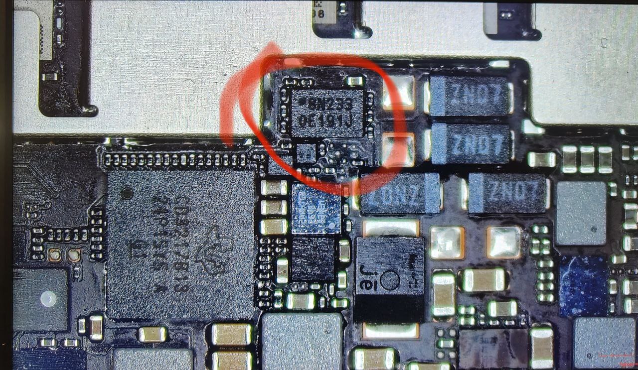

          I have a strange problem with my iPad Pro 12.9 4Gen / A2229. When I start the device, it stays on the Apple logo, but when I heat the back of the device with a hair dryer, the device boots, but this time there is an interesting problem. The iPad is charging, but there is no USB data on the computer. The USB charging port has been changed and the chips seem normal, but I have given it to 2 different Apple services in Latvia, but the repair could not be done. Is there anyone who can help with this? Can someone support the repair by sending only the motherboard within Europe? Thank you.

          Hey folks, I have this iPad Pro 12,9" 4Gen A2232 here with no charging issue. The main fault was a crossed pins / faulty USB charging port due a bad cable.
          So I started to replace this parts:
          - replaced usb-c port -> no result
          - replaced battery -> no result
          - replaced usb-c chip CD3217B12A -> no result
          - replaced 343S00326 -> no result
          - replaced 343S00327 -> no result
          - replaced 343S00328 -> no result
          I have no more ideas for this issue. There is no short on the whole board, and the iPad is working fine...
