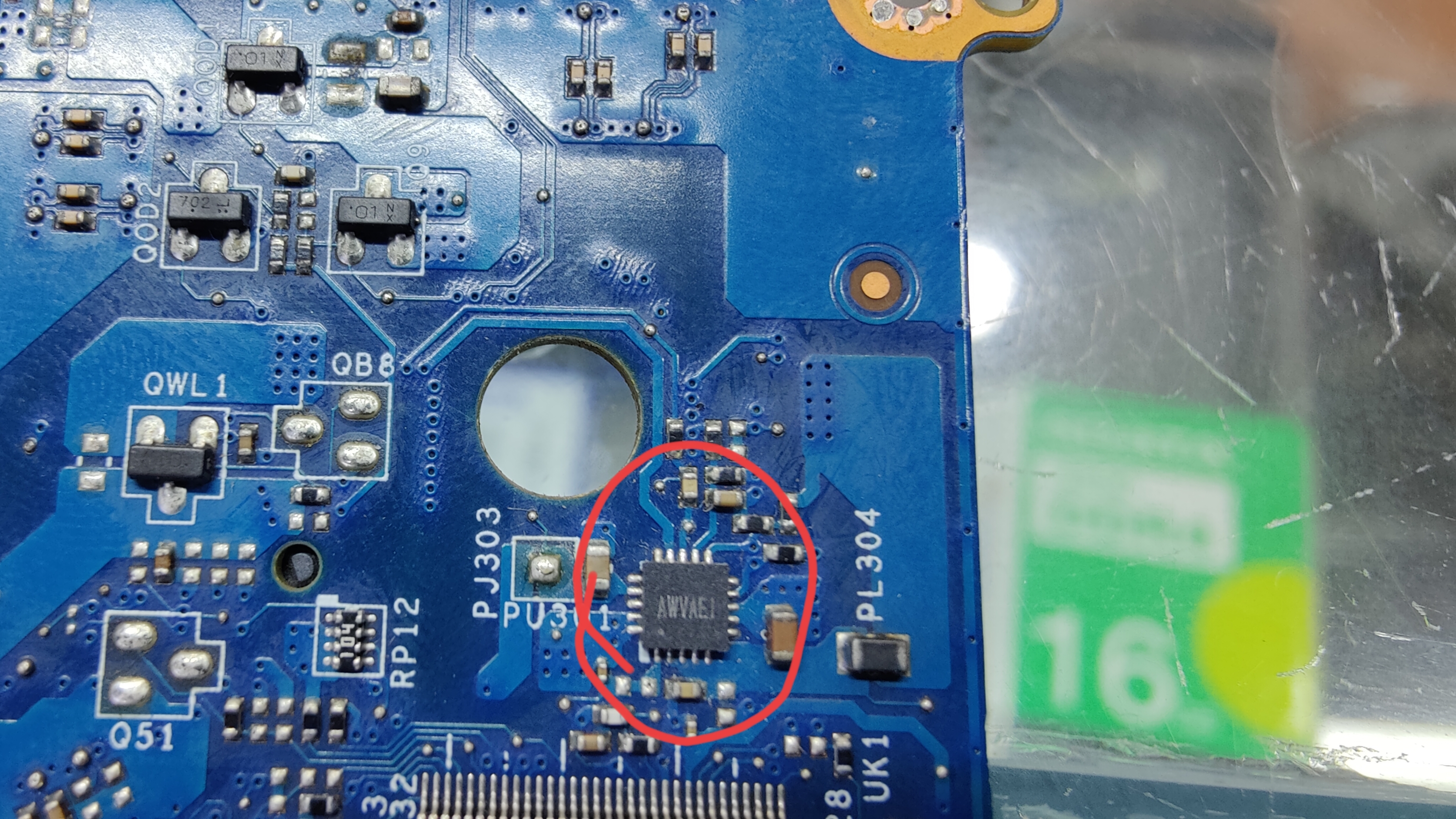

    Anyone knows any compatibe ic for this one
    it's a 3v ic
    EPK50 la-g07ep is mb part number

    looks like a Silergy SY8286BRAC
    Maybe this thread will help HP motherboard 3Volts overheating - hp 14-bp019nf - Badcaps

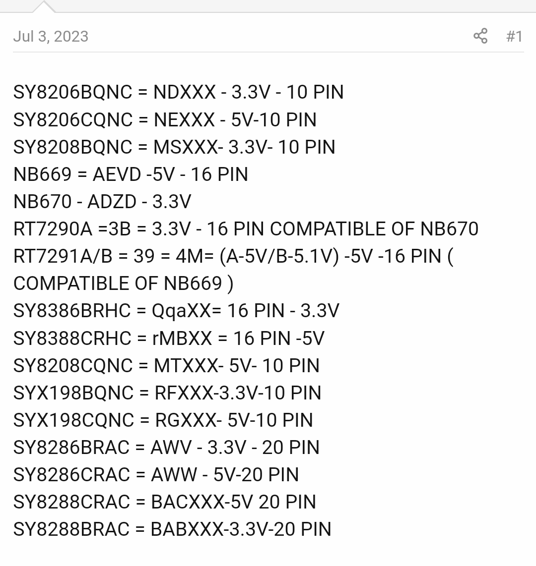

      i also found this one after lot of searching
