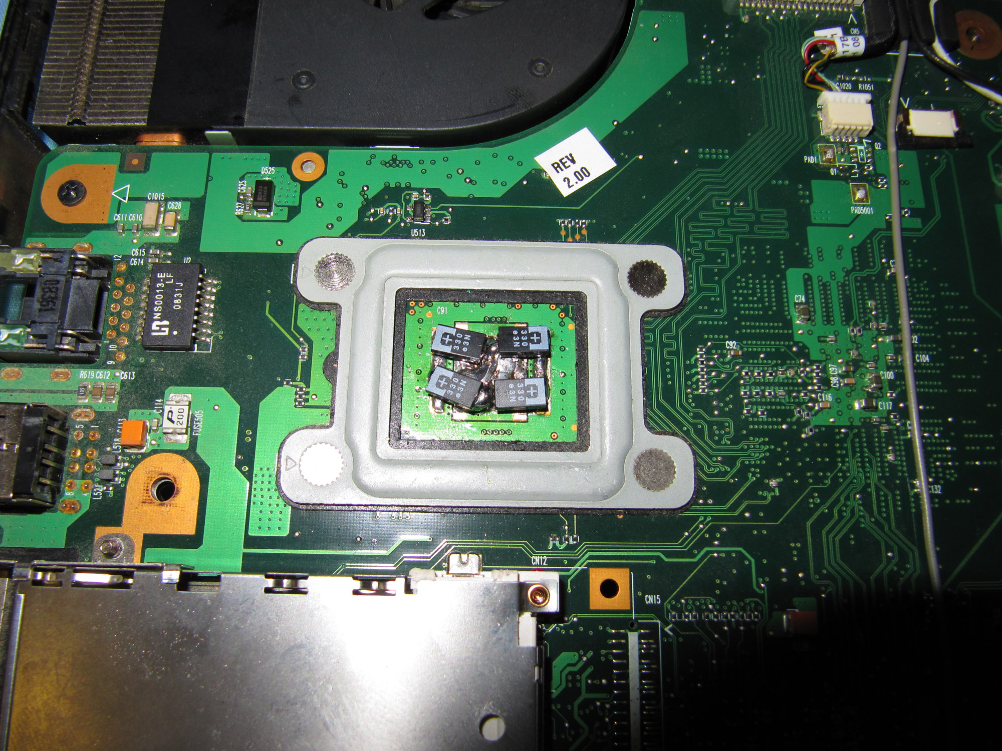

    I already disassembled the laptop, cleaned the fan and applied new thermal paste.
    That's what happens:
    https://www.youtube.com/watch?v=adicT5F6b00
    Any ideas?
    I will post more info later

    Replace RAM to see if it is the faulty RAM that causing this freeze first and easier step. Does it happens randomly or when a heavy program tries to start like a game?

        I have run MEMtest86+ v.4.10 several times without any errors.
        The blank screen happens while the pc is idle or light used in windows 7 SP1 installation or ubuntu running in live DVD mode...

            Check out the huge thread about the NEC/TOKIN capacitor. I'm fairly sure that's exactly what you have there.

                Noticed after I posted!! LOL! Agree with "Th3_uN1Qu3" by the way. My L300 is completely dead and have a shortage on 3.3VA rail but in your case it freezes on Windows. Must be NEC/TOKIN.

                  Yep, Tokin cap.

                      Ok, I read the entire thread (https://www.badcaps.net/forum/showthread.php?t=8991) and I decided to order 330uF Tantalum caps to substitute the NEC/TOKIN OE907 (2.5V 900uF 1.5 mΩ esr).
                      I can order from RS Greece:
                      http://gr.rsdelivers.com/catalogue/c...ors/10527.aspx
                      I think that these are suitable:
                      http://gr.rsdelivers.com/product/pan...f/7887422.aspx (2R5TPE330M7)
                      http://gr.rsdelivers.com/product/pan...f/7887457.aspx (2R5TPF330M7L)
                      I need your reassurance before I place the order... Are they compatible? Which of them is a better choice? I cannot find other difference than the price and the height.. Should I go for the cheaper?

                        4x330d resolved the problem even with heatgun

                          and yes your choice is good

                                  Thanks to everybody for the help, this laptop is now working again just by removing NEC TOKIN cap and replacing it with 4 smd 330uF capacitors.
