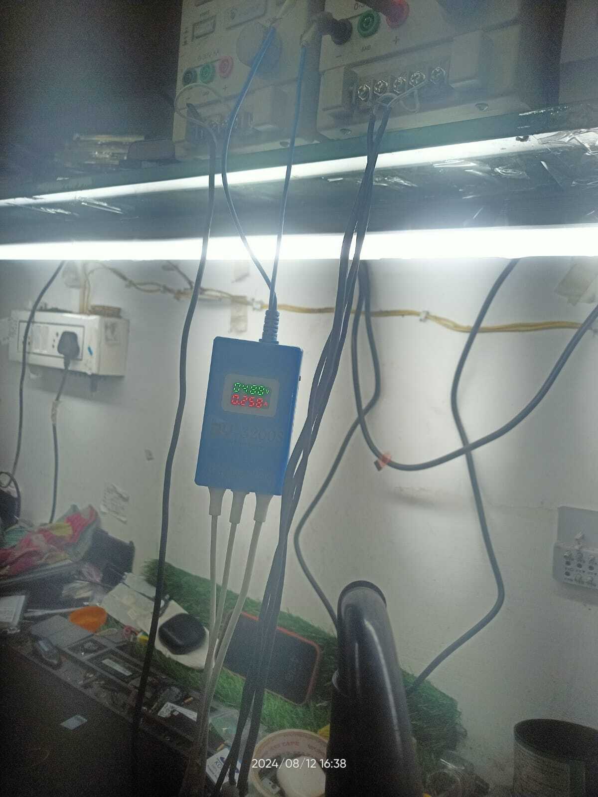

    I Have a a1990 820-01041-a no power
    PP3V3_G3H_RTC_X= 3.3v
    PP3V3_UPC_TA_LDO=3.3v
    PPBUS_G3H=12.4v
    dc is showing 5v stuck 200 ma
    what problem anyone help

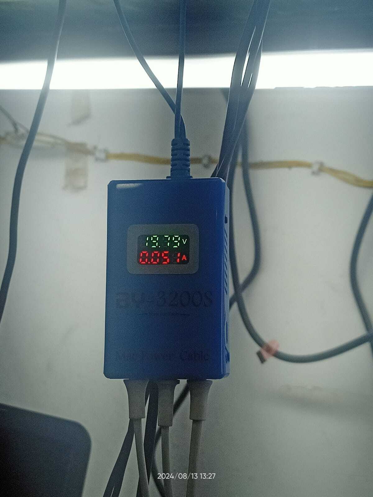

      yes one cd3215 was bad i was changed cd3215 now condition normal 20v
      but also no power on can you suggest what next check

        What is the current draw now? Do you have power cycling? What is the voltage to ground of ppbus_g3h?
