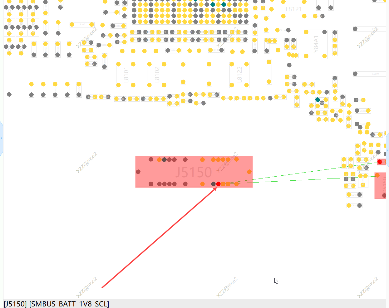

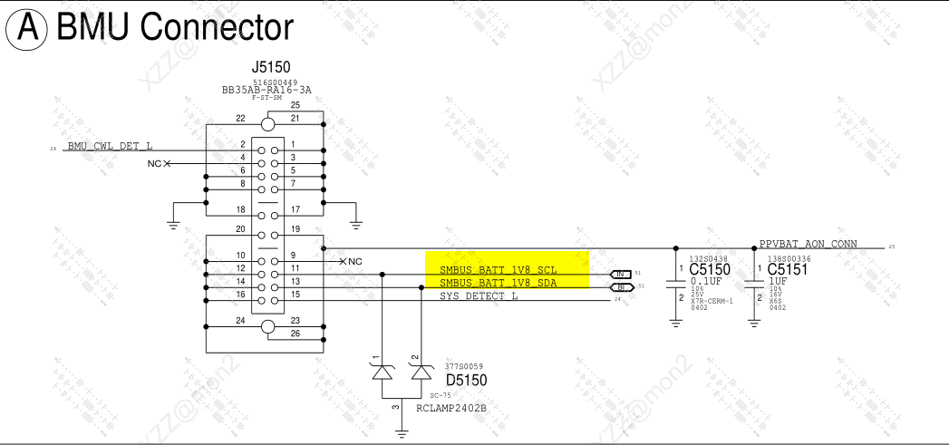

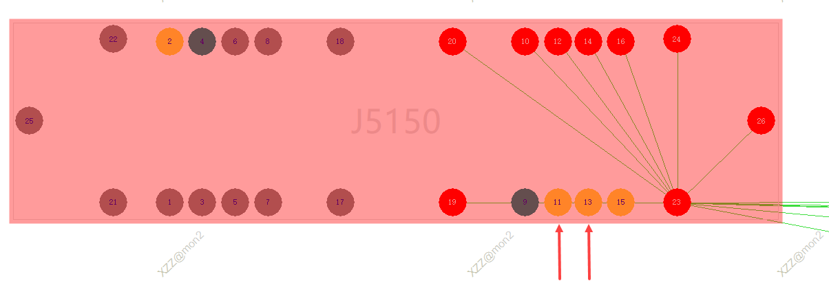

                  replacement screen might have damaged the DATA lines of the battery charging Rails.
                  These communication lines are:
                  SMBUS_BATT_1V8_SCL
                  SMBUS_BATT_1V8_SDA
                  What is the voltage to ground of each of these lines?

                    I don't have a diagram to see where to measure those points, can you provide it?
                    I measured the battery and I have 4 points and they are 3 different voltages.
                    3.9 7.8 and 12v​
                    • mon2
                      • Dec 2019
                      • 14721
                      See attached.
